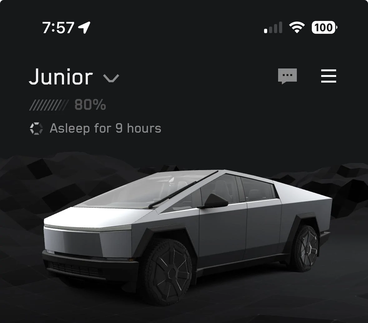

Update… stopped leaving the Tesla app open on my phone and this made a significant difference in battery drain on the truck.
