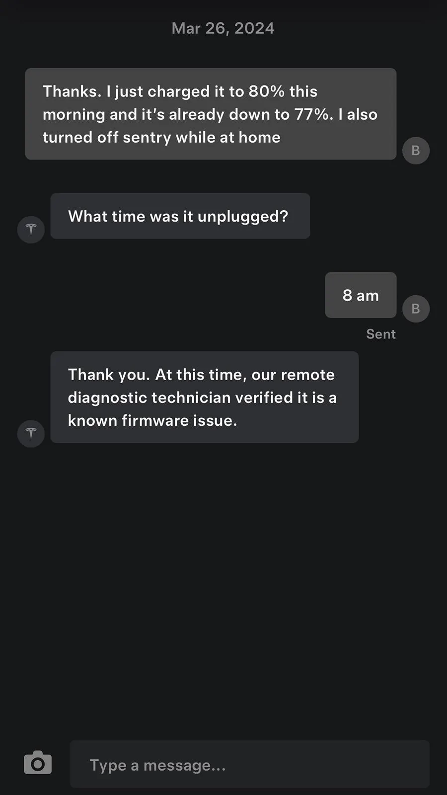

I’ve had ridiculous vampire drain on my truck since delivery in early February. Charged to 80% by am and down to 77% by 10:30 am and so on.
I opened a service request and Tesla confirmed it’s a known firmware issue with no further explanation of timing of fix etc.
