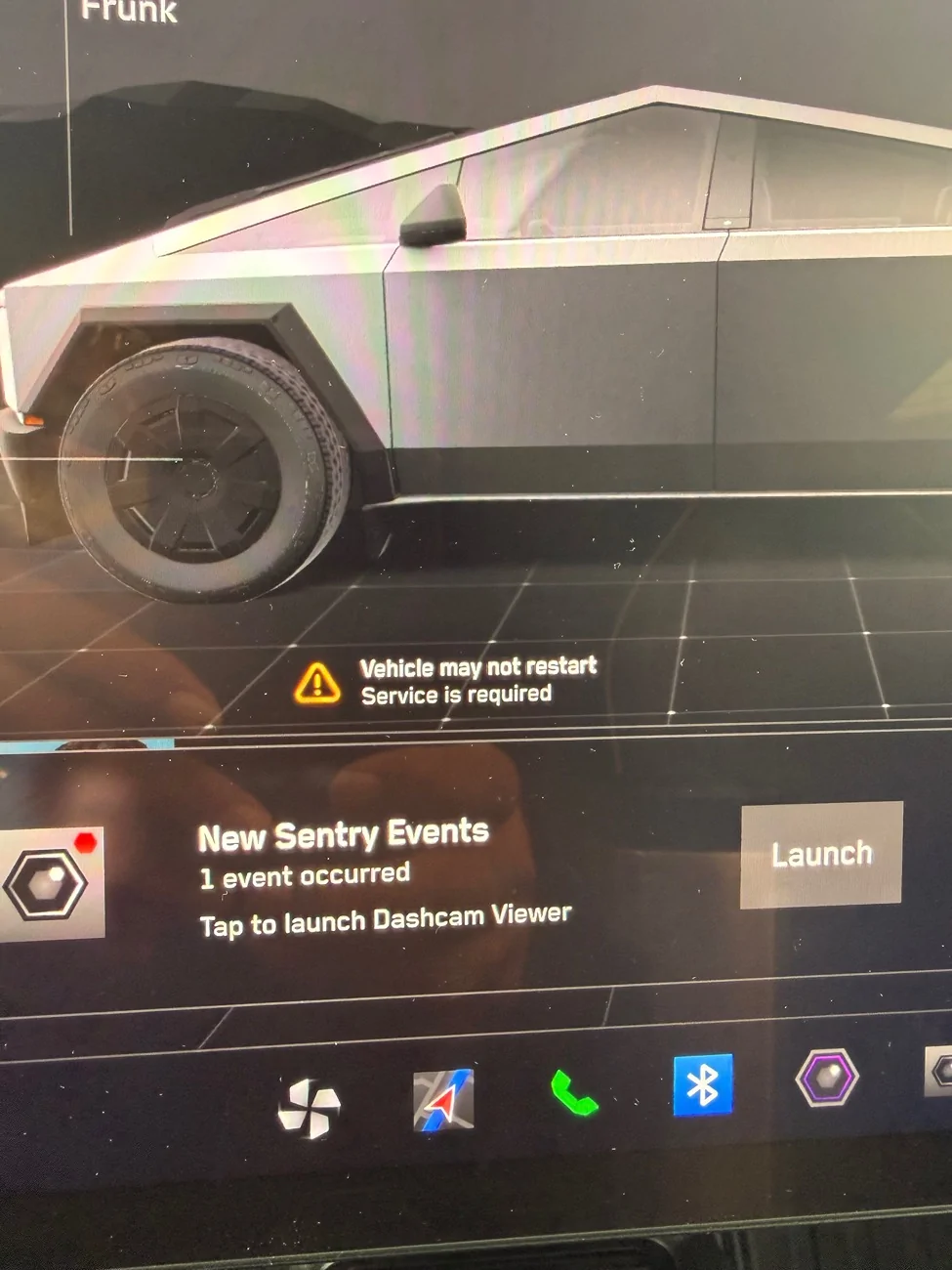

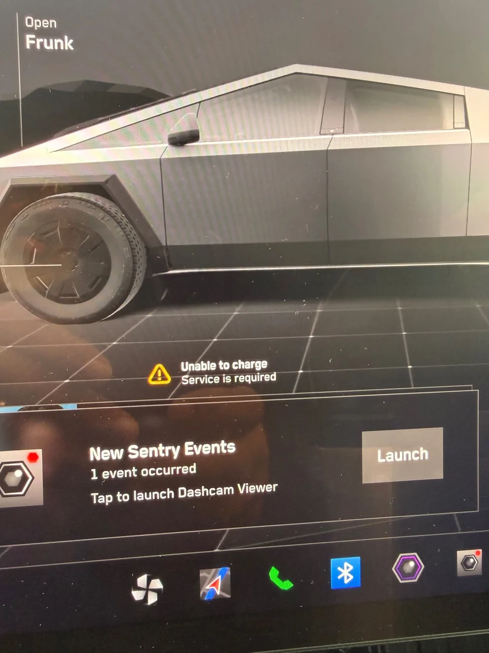

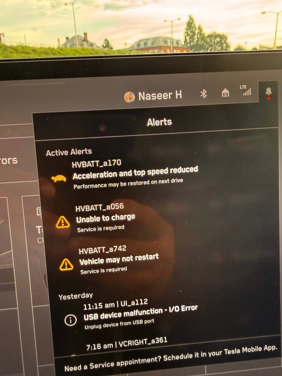

Same here, I have 8000+ miles on my CT 2025 and the High Voltage battery failed, Tesla service sent me a tow truck and gave me a loner with estimates of two weeks in service waiting for parts. It’s covered by the warranty. I was told over there that they start having many Cybertrucks with the same issues that requires replacing the battery. Maybe this is what caused the delay, I think? Anyways, I think soon that will need a recall, maybe!! I hope this pick up date will not extended and the fix will be final.
I attached a photo of the message you will see on the screen. Once you see this message, don’t drive anywhere, contact Tesla service immediately, they will override the waiting line and take the CT immediately for repair. The Tesla service action is fast although you will be pissed by what happened to your CT.

Same here; 3,236 miles on a ‘26 Premium. VIN 874xx. Scheduled service appointment for July 16 and app shows Parts in Transit.
No PCS Alerts, supposedly using the latest PCS without known issues. (10/25 build) Assuming the Voltage Sense Harness integral to battery pin/ connector issue.
