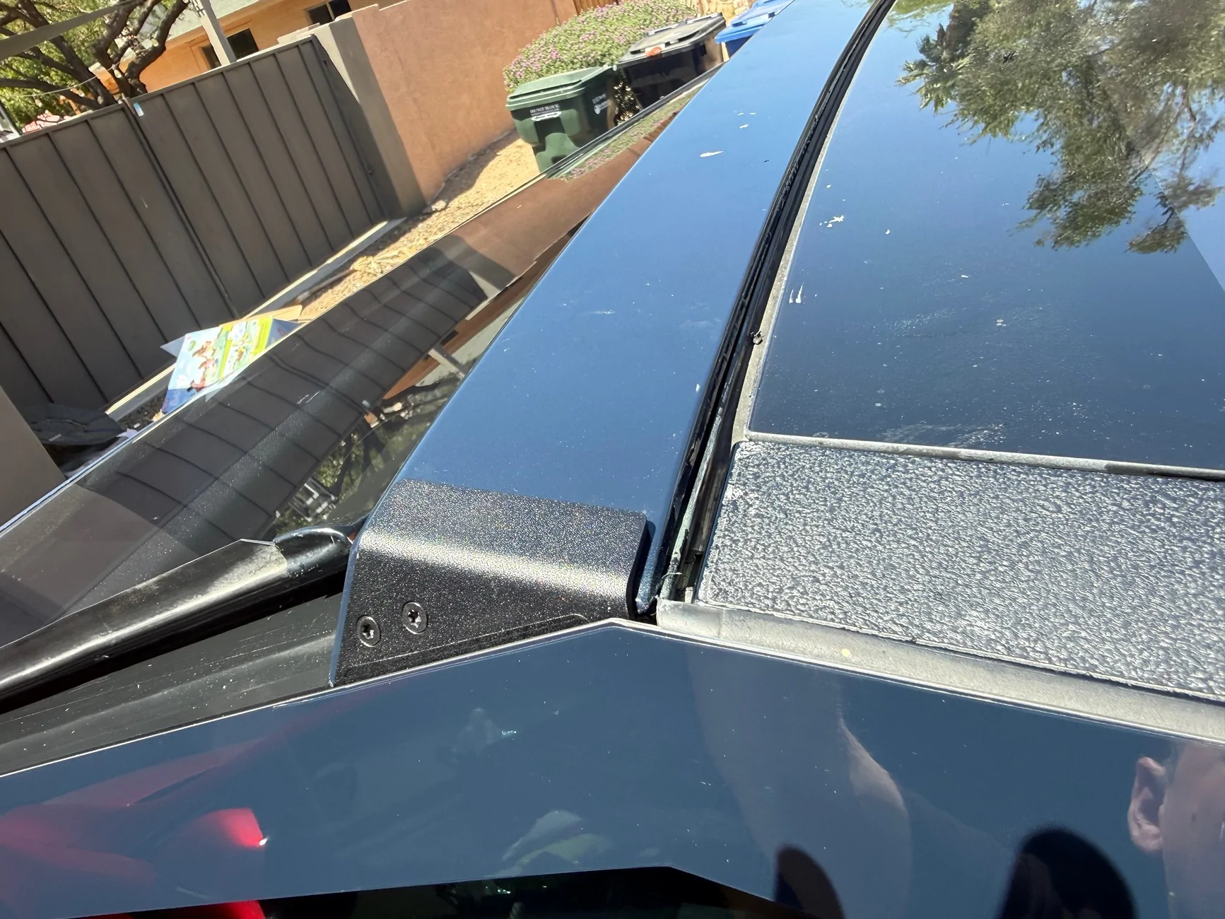

Nice job! Brackets look clean and minimal too, might have to take mine in and have the dealer retrofit my bar with some. Is that a film you used to cover the lightbar ?

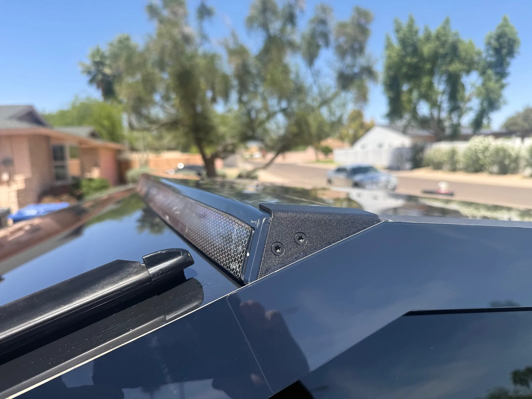

So in the interest of belt and suspenders security, I took my truck into my local SC which agreed to both sell me the parts and do the install. This was of course out of pocket and not warranty. My car is an AWD and the bar was purchased from another member. It was expensive at around $800 for parts and labor. The way I see it it’s like investing in a warranty to some extent because if it flies off I know where I’m taking it. To the people who now installed it, Tesla.
onsite how would play out in real life but that’s how I justified the expense.
Didn’t really have issues with the VHB but now the bar is up to spec with the post-recall bars out there.
Wow. You must have a REALLY good relationship with your SC for them to agree to that.

looks Good nice job. How did you get the service center to do it? Did you access through the app or talk to them in person/phone?

Our service centers here will not do those brackets unless they have an email. Good for you. At least you have piece of mind.

Talked to them in person. I’ve known the people who now appear to be in charge of that service center since about 2016 and every tech there know ā€œthe bluey truckā€ as they call it. So perhaps it was a little preferential treatment. Not sure how to assess that. They weren’t particularly resistant when I asked, just made sure I knew it was going to be out of pocket. They have always been pretty good to me though.

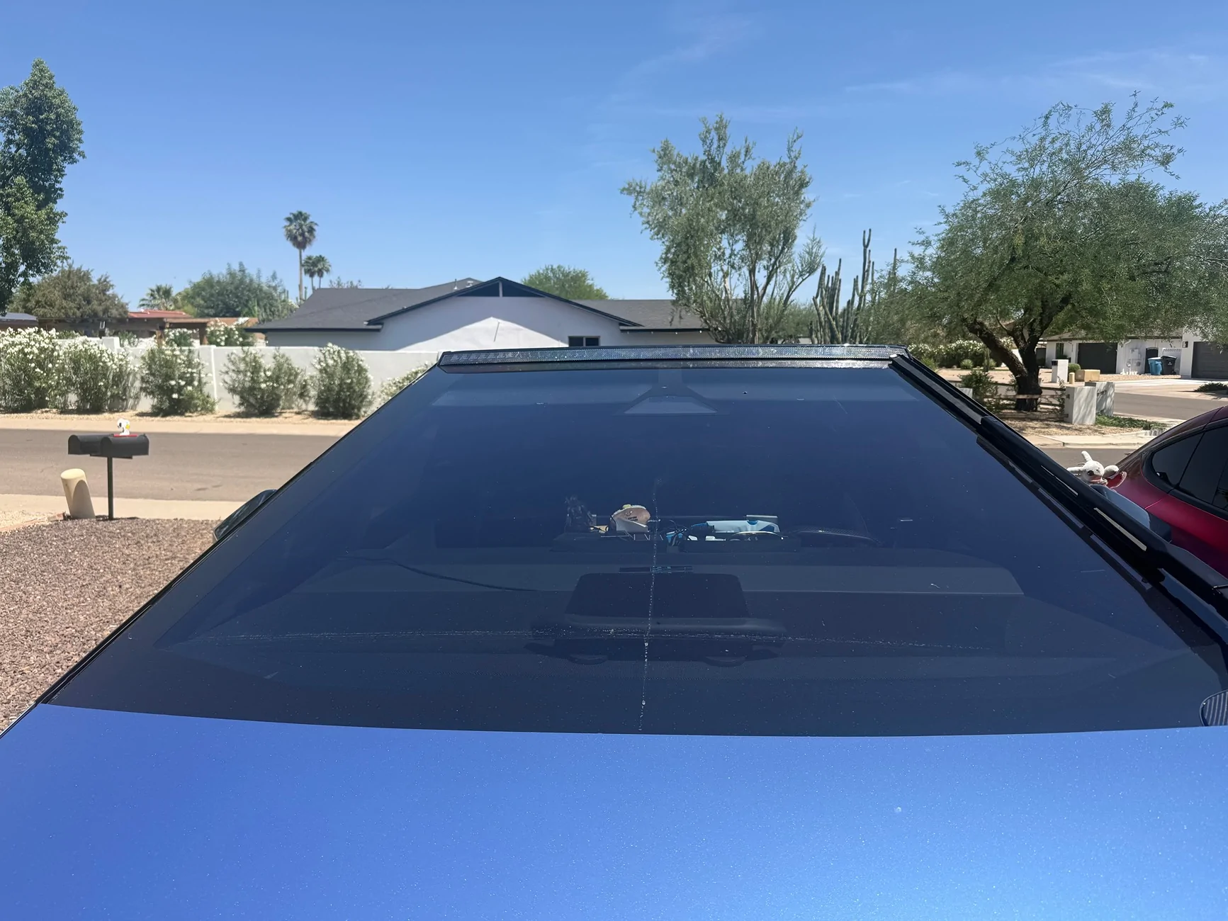

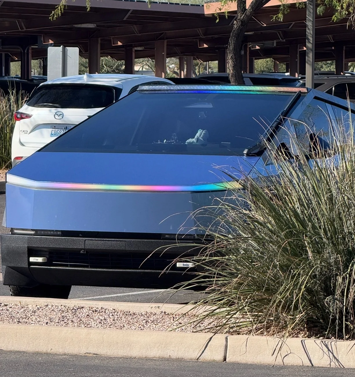

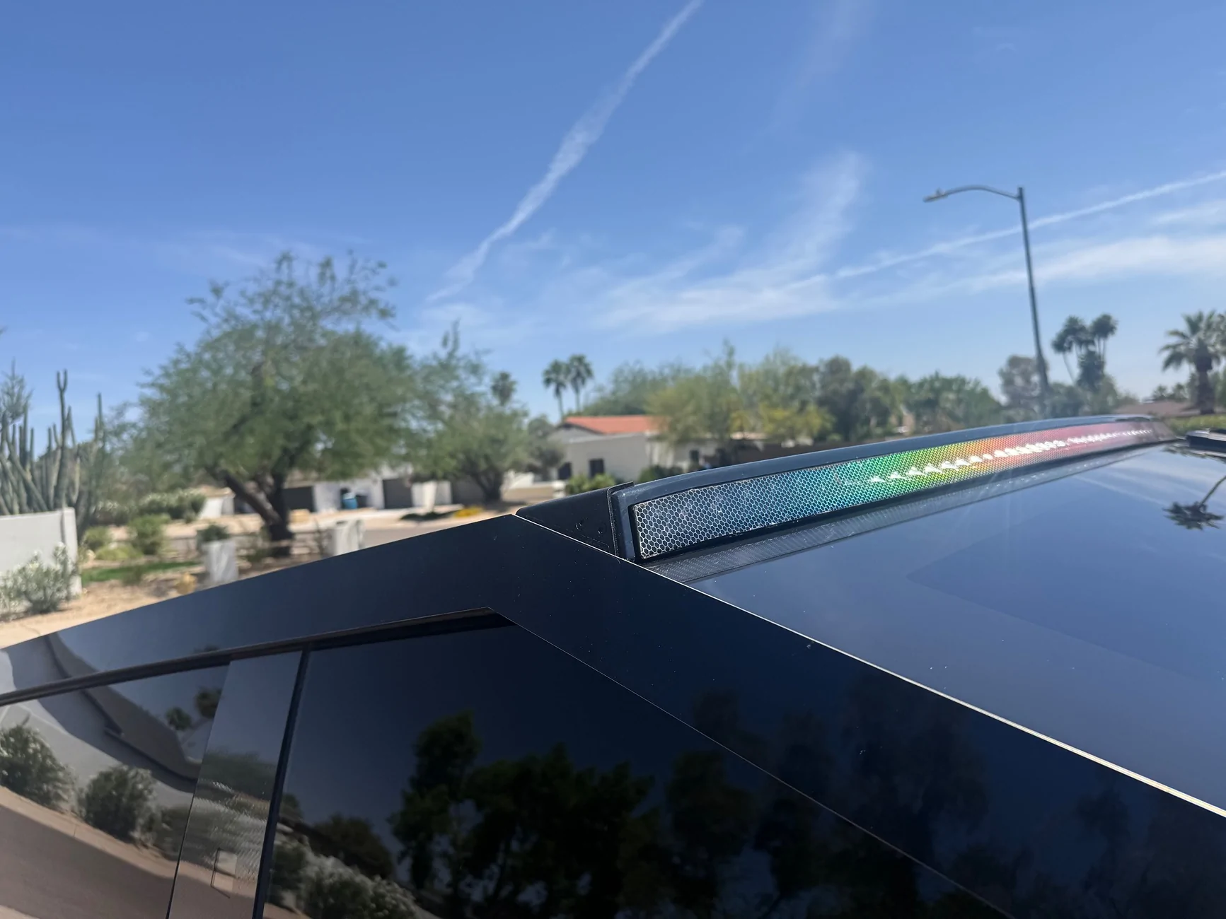

Yes. I have ppf on the bar in dark blue like my cantrails and this film on the front of it.
https://a.co/d/0bglJwb8
Because of the angle of the windshield it creates a reflection that by happy accident is a dead-on match for my cyber glow

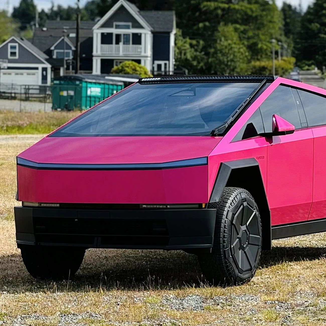

Mine has been holding on well since November. I occasionally inspect it and give it a wiggle with my palm to see if it's loose, and so far so good. I've taken a good amount of freeway trips and long drives and so far nothing has indicated that the tape has failed at all.
I used 3M tape primer on the glass before adhering the tape to the windshield. I'd love to get the brackets but have not tried to order them through the local SC yet.
