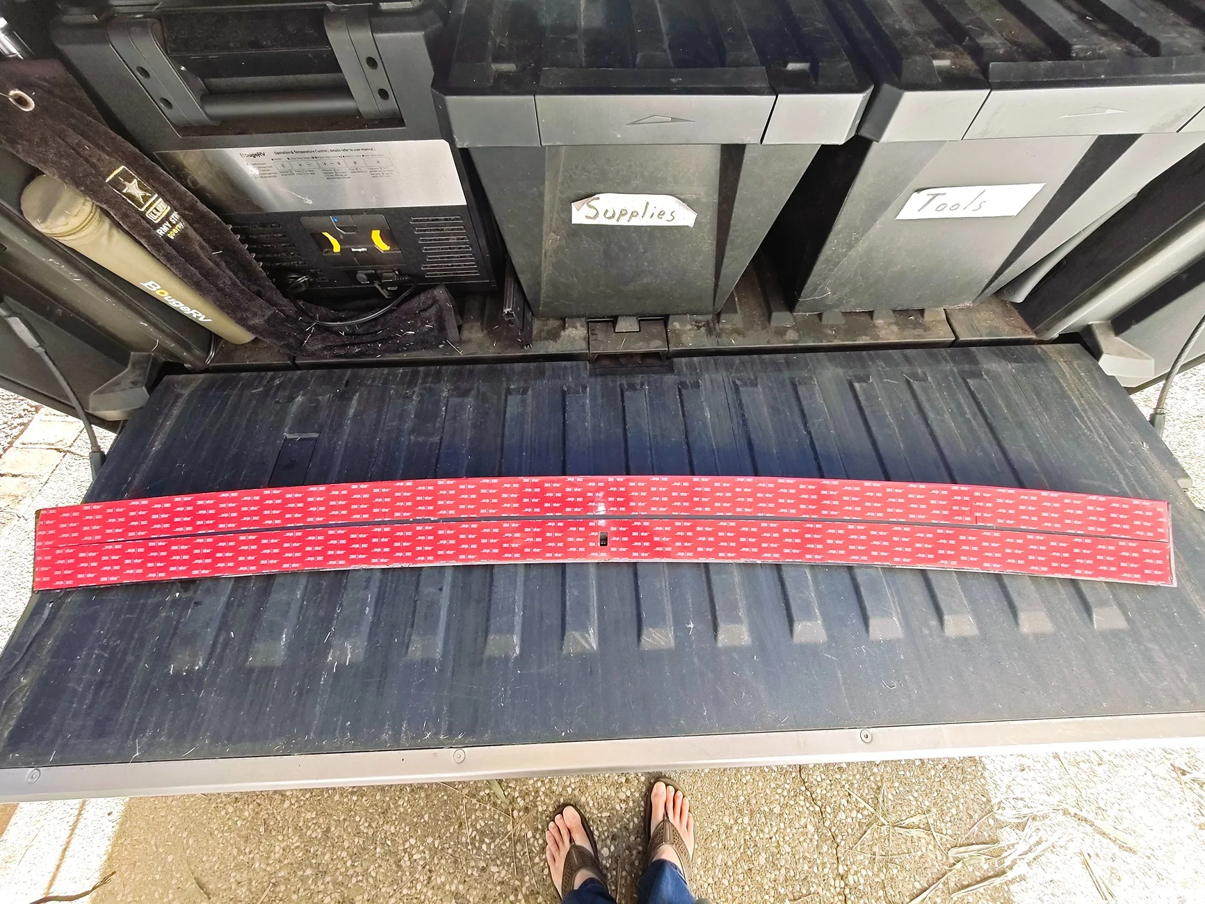

You would also want the 3M double sided acrylic tape.

Only thing id recommend is make sure the top edge lines up with the roof glass, otherwise youll have a lip. Also, make sure your sides are evenly spaced between the contrails before you peel off the red backing

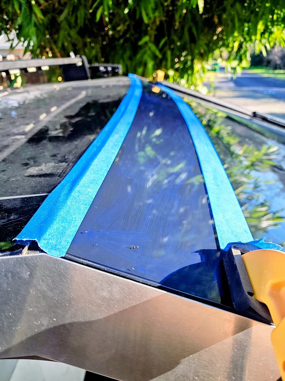

Installed mine in December using the double-sided tape and 3M tape primer, still going strong! I have taken two long highway trips with it and it's as solid as the day I installed. I wiggle the corners to check it periodically, no change so far.
(I would really like to get my hands on a set of those brackets though, for peace of mind).
