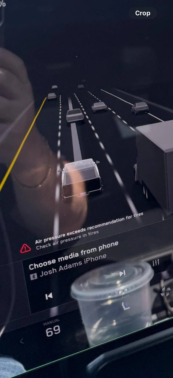

So a quick update to this post. Tires are doing well however I have increased the tire pressure to 60psi. Now what’s annoying is I constantly have a tire pressure higher exceeds notification. Is there a way to turn this off?

I've been running at 65psi on my KO3s for 6k miles now and running a great 410w/m ave. Don't even hear the tires. Tires wearing perfect and have never seen high pressure warning?

I have been running 65psi on K03s for 10,000 miles now, no noticeable wear and no warning messages. I just looked up the chalk test as suggested by Travis64 and will do that as an experiment because I have wondered whether I might have the tires rather overinflated. (Wondering if I could make the highway experience a little smoother with less inflation.)

Yeah. That would annoy the $4!t out of me.
how high do you have to go to see it?

This is what I see
Which wheel set do you have selected in the wheel settings? The all terrain option manual recommends 65psi when under load so it might allow for the higher pressures without warning whereas the all season option recommends 50psi regardless of scenario.
