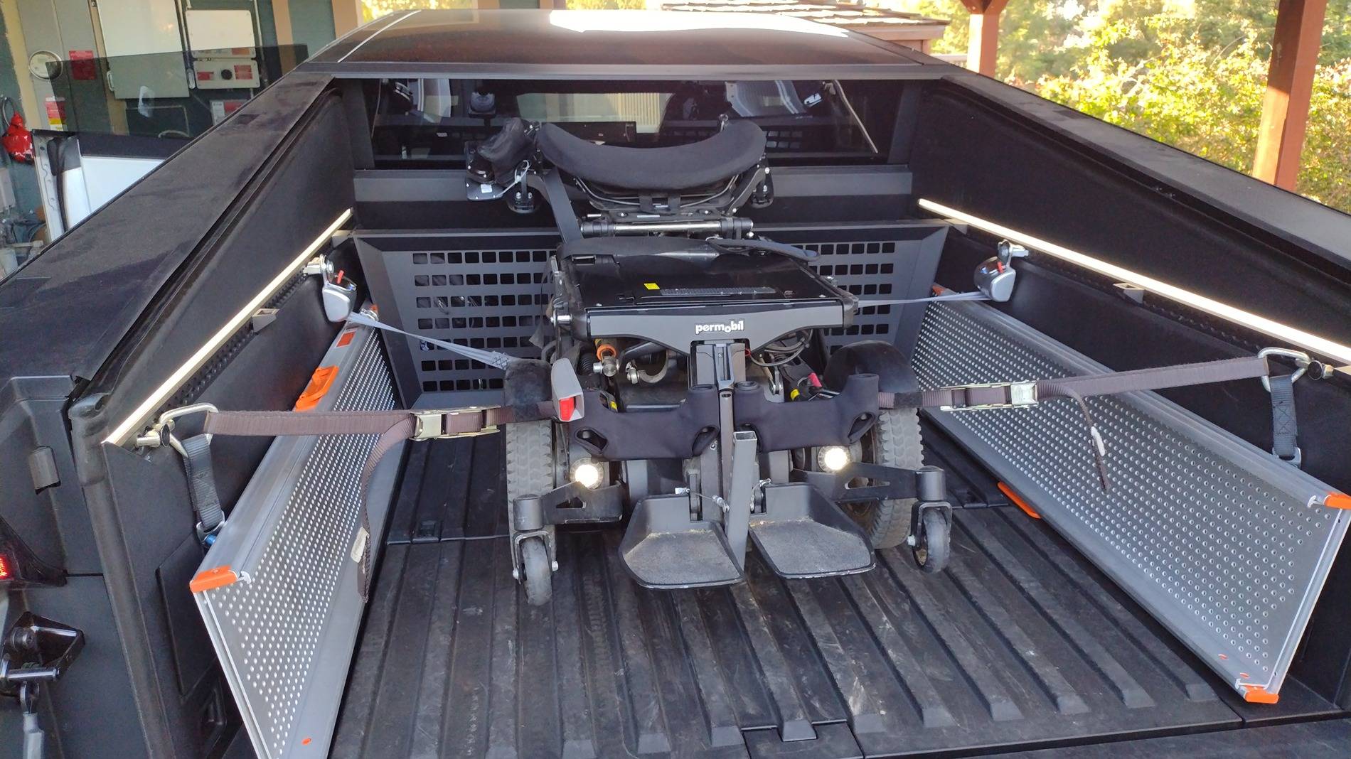

Cool setup! Yeah, when you need total vault access the tire has to go above. I also needed vertical clearance to load a wheelchair into the bed, so I couldn't have anything mounted in position four or I would have to remove it each time the wheelchair went in and out. I custom modified prototype pieces from Mars adventure gear, they are good guys look them up, to get it between bars two and three since I'm not aware of anyone who sells this ready-made. To me it makes more sense here than between three and four or one and two since loading tire is manageable and the tire is not in the way of the bed loading and unloading other things.
