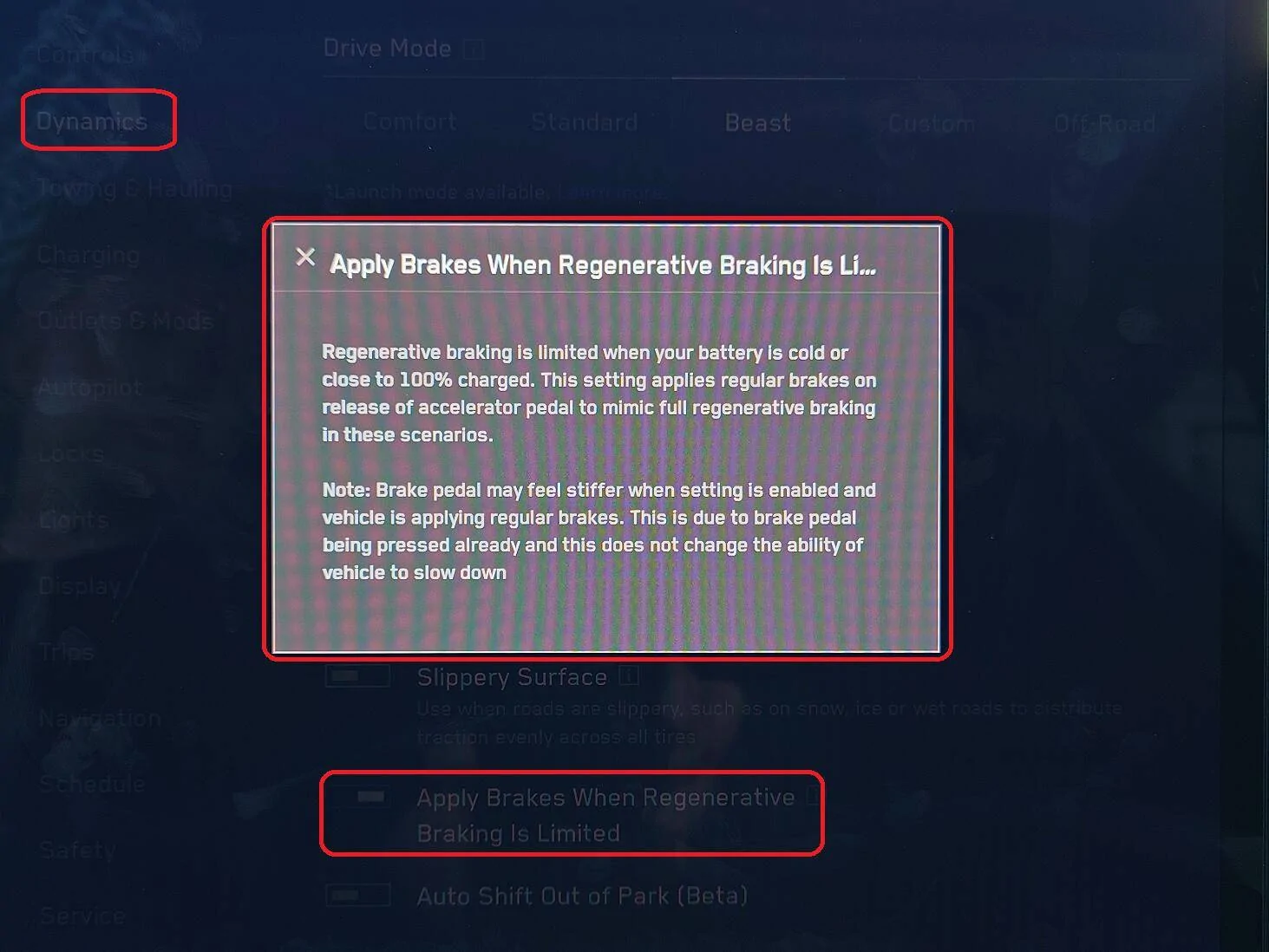

I'm not sure how many people have noticed this setting but it is on by default. Basically if the vehicle isn't regenerating for whatever reason it will use breaks to simulate the feeling of regeneration. I've noticed that my regen 'breaking' is inconsistent sometimes and this is probably why.

Not sure why it is the rear for them. I was just pointing out that it will use breaks to simulate the regeneration so breaks are being applied regardless of break pedal usage by default.

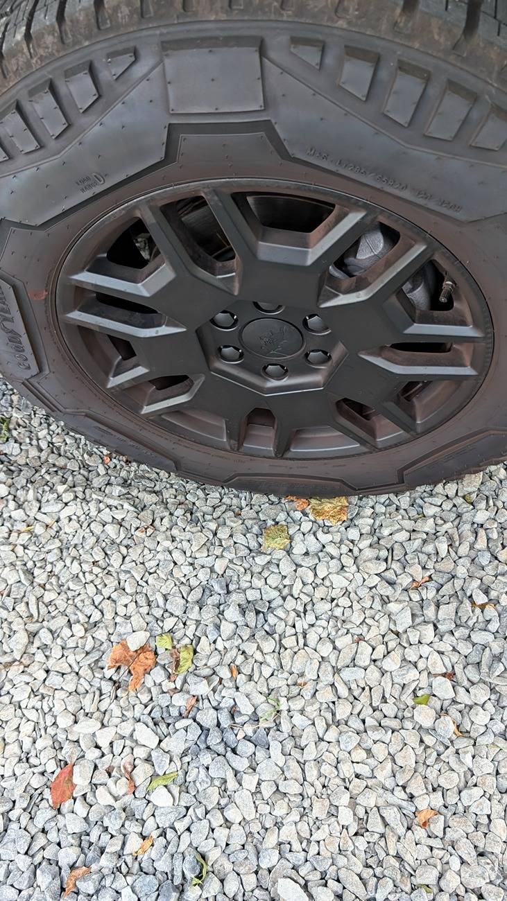

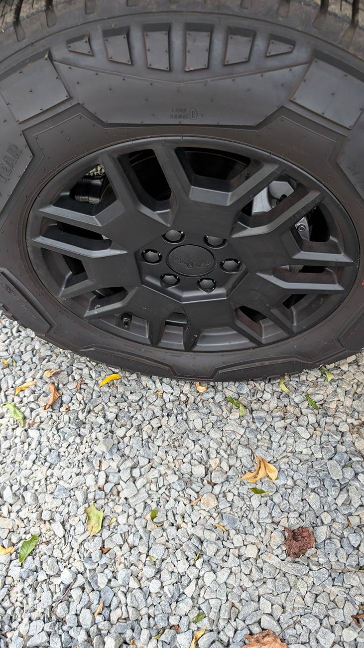

A little test. Below are two pictures.
The average viewer will know they are pictures of tires.
The Cybertruck enthusiasts will recognize them as being Cybertruck tires - specifically AT tires
The super astute will notice that one of these tires (and wheels) is covered in reddish-brown brake dust.
Tesla Cybertruck Brake Dust on Rear Tires? PXL_20241017_221046817.RAW-01.COVER
Tesla Cybertruck Brake Dust on Rear Tires? PXL_20241017_221037799.RAW-01.COVER
MOST mechanics and probably auto enthusiasts will assume that the one with the brake dust is the front tire because ... in my whole life and through 40+ vehicles I've owned, about half new and half old, EVERY SINGLE ONE OF THEM dusted their front wheels but NEVER, EVER, EVER their back wheels. (1965 Mustang and a 1960 Falcon being the 2 exceptions because they had drum brakes all around)
My Cybertruck is the ONLY vehicle I've ever had that gets brake dust all over the rear but none on the front tires.
Is this normal? It doesn't seem normal. I use FSD occasionally, like maybe every other day for 15-20 miles but it's all highway. I have an appointment to get my window switch replaced (plastic switch came right off. It works if I'm really, really careful). I'll definitely ask them at that point about it regardless but wanted to pose the question to you fine folks.

Pictures were taken at the extreme angle so you couldn't see easily which was front or back.

Turn off the Braking in the controls tab, No more Brake dust, saves on pads , use the power of regenerative braking to slow the truck down, if needed, apply brakes manually, should help
