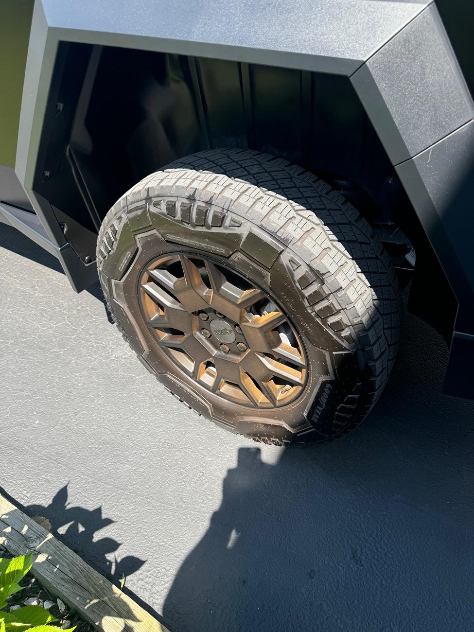

I have a lot of brake dust only on the left rear wheel. The other three wheels are clean. I was looking here to see if anyone else had the same problem as me. I got delivery on June 3rd and used the brakes four times and only very lightly. I have $1,760 Mi on it.

I made an appointment with service because I'm wondering if the caliper is sticking. The earliest date near me is September 12th.

I suspect the rear brakes are dragging. Maybe pull a front and rear tire and compare pad wear.

Or jack up a rear tire with the truck in car wash mode (front tires blocked of course) and see if you hear brake dragging or feel resistance when trying to spin the raised wheel.

W.A.G. on my M3P, there is a setting in menu to simulate breaking when charged full. This engages brakes to simulate the same drag you would normally have when regen braking.
if battery is above a certain SOC there is no where for the regen energy to go.
only thing that gets rusty on my M3 is the rotors and they quickly clean when applying pad pressure/ brakes once in a while, normally just before autocar washing.

My electric pressure washer easily removed the discoloration from the wheels without any chemicals or elbow grease. But the reddish tint (from whatever this is) won't wash off my tires.

That caliper might not be retracting.
