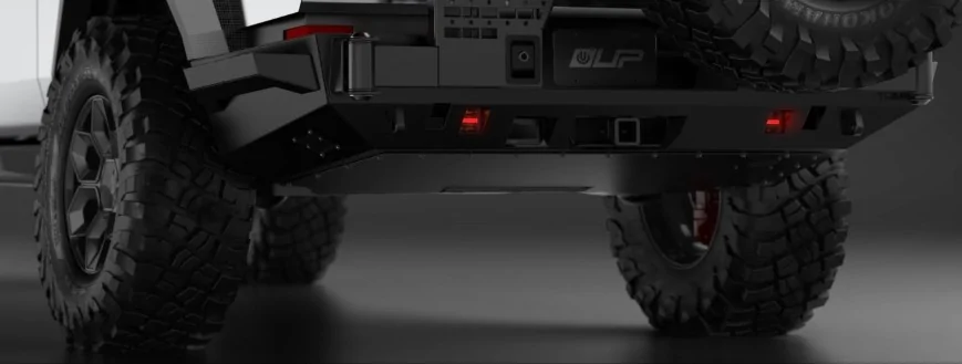

Some comparisons. See article at the end of this post as well.
https://www.cybertruckownersclub.co...e-angle-longer-control-arms.8070/#post-205852

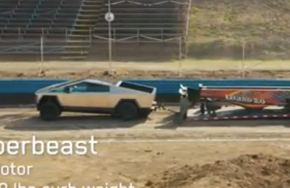

curious about your thoughts on how the CT looked in the sled pull video
more than any other vehicle, it appeared to completely swamp out in the rear once it began that pull. Surprised me a bit for a system supposed to have load leveling etc
Well this might well lead to that same conclusion that the payload capacity is higher than the 2500lbs. ;)
In the tractor pull there are a few reasons for the seemingly "poor posture" of the self leveling suspension here.
First up that tow hitch was connected to the top of the hitch rail, which means when it pulls the sled, there is a force that is trying to rotate the CT around the axis of the rear wheels, in the direction of the tensioned connecting chain.
This is not necessarily bad, in that this force lifts the front of the CT into the air, as well as lift the front of the sled up at the same time, reducing the sled drag, and both puts as much mass on the rear axle as possible. Down force x friction gives you maximum traction on the rear motors, which are doing over 80-90% of the work in this situation as the front axle is severely traction limited, with only a partial downforce.
The longer wheel base here also helps the CT, as it does with the F350, in that the longer lever arm in front of the rear axle produces more rear axle down force, than the shorter wheel base vehicles with similar mass. This is also a reason why the beast version has such good acceleration, because like a top fuel dragster, it uses this long wheel base leverage effect to it's advantage to create more traction in the rear where the two motors are, without adding more mass.

In this scenario the effect of trying to lift the sled by pulling the front up is primarily caused by the motor wheel torque that is twisting those rear tyres, Which is trying to do a "wheelie" and by doing so it is compressing the suspension as the front CT mass and the sled try to align. This angle looks more extreme on the Rivian and CT because in part of the airbags that are bulging the bags beyond their rating, despite being pumped up with pressure. This doesn't happen on the F150 seeing they are steel coil sprung in the rear, have less suspension travel in comparison and are potentially already sitting on or close the stops with a compressed steel spring. The F350 is live axle with progressive leaf springs which will not compress as much, it will also be rated for a higher rear payload. It also has a long wheel base that helps with a heavy ICE and gearbox in the front that gives it more front and rear axle traction. The EV's having the battery mass in the floor, is probably not helping that much in this situation.
Now in this scenario with the CT, with virtually fully compressed springs in the rear, I would say there is at least the half the mass of the front of the CT, so 1500lbs, plus the back CT mass 3400lbs, and the same 1500lbs amount from the sled to balance it, on the rear axle. So around 6400lbs on the rear axle alone. That is fairly substantial if correct, and nearly twice the rear axle capacity, I'd have to do some math to confirm how much exactly, but it would be somewhere in the ballpark.

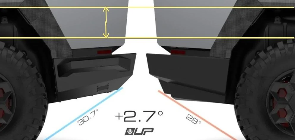

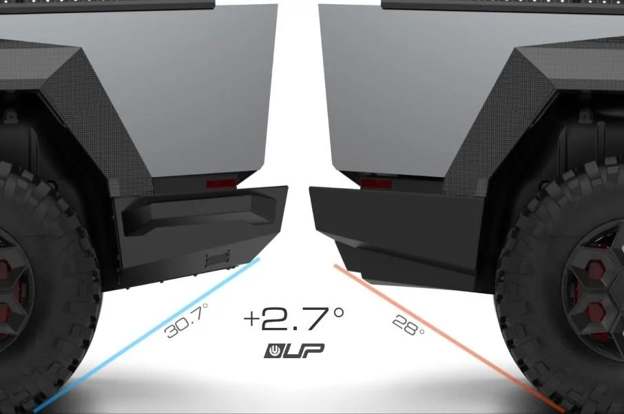

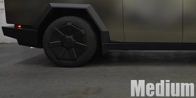

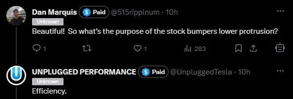

PS: how do they not mention the height setting at which this is based
I guess this measurement (visual or estimated based on other things) between the yellow lines needs to be compared to various places where people are showing all heights.
My guess is High.
