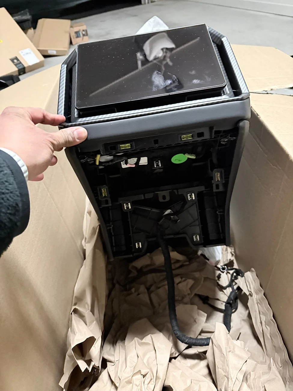

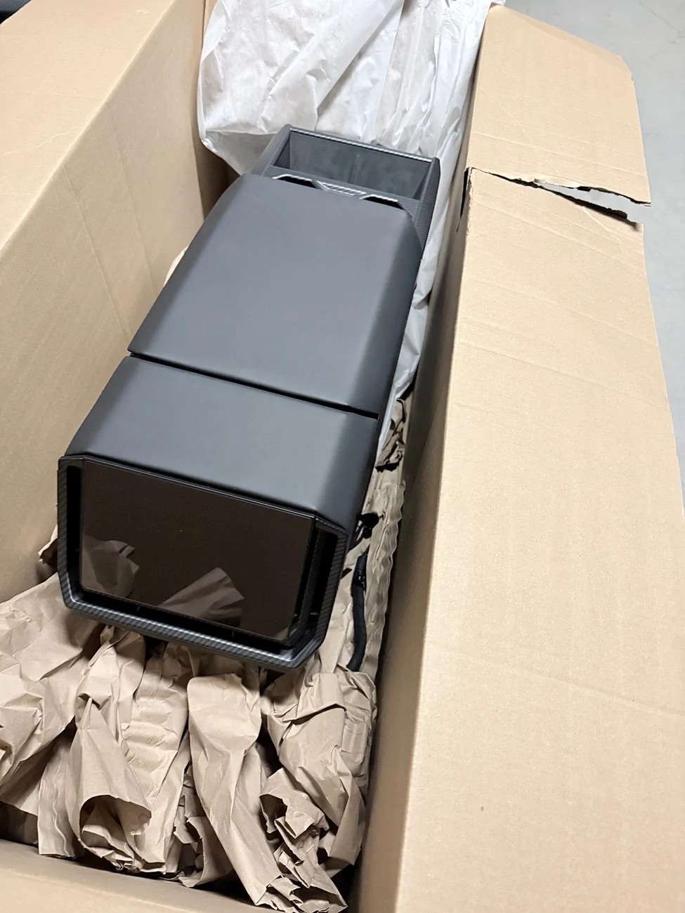

I'm having the same long-term issue (6 service visits now) with the creaking center console on my 2024. What did service say the cause was? To me, it seems structural, as it only happens when turning left or right.
For me, it was the rear plastic panel underneath the rear screen near the floor. The perimeter of that panel is rubbing against the plastic around it. First, they put felt tape around it, which worked for a few weeks, but then the creaking started again. It’s a quality control issue at manufacturing. They’re supposed to be a slight 1 mm approximate gap Around the perimeter of that panel when the gap is not there the plastic touch and Creek during turns. The entire center console and screen assembly was replaced for me after three attempts.
Thanks for the response. Did replacing the entire center console solve the issue?

Yes. They even let me keep the old center console and screen in case my rear screen ever went bad. I now have a spare.
Glad to hear that fixed the issue for you. Fingers crossed that service will do the same for mine. Cool they let you keep the old one as a spare too.

Don’t take no for an answer. Make them replace the console. It’s the vertical panel underneath the screen that sits on top of the floor. You can actually press the corners end with your hand and cause the squeak to happen.
