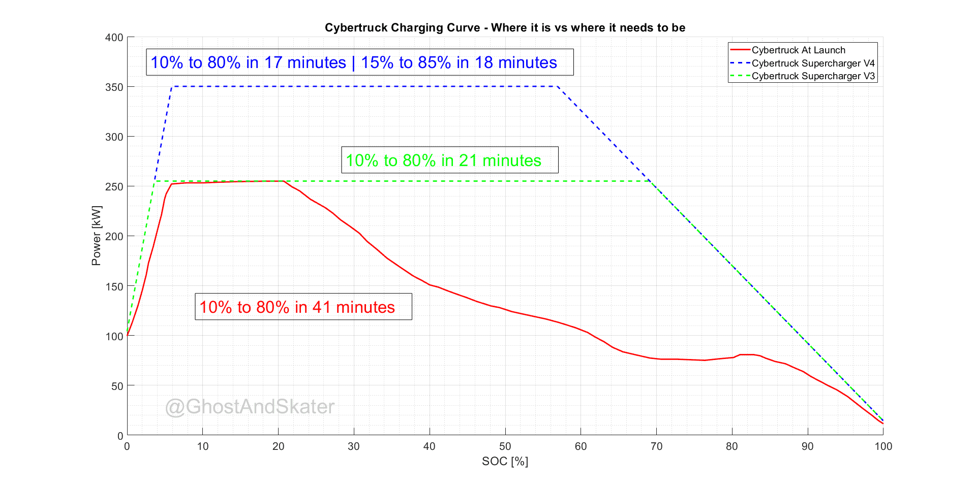

I did the calculations to what the charging curve would have to look like for the "15% to 85% in 18 minutes" from Lars on Jay Leno review to be true
This does not mean it will nor that it is possible on trucks delivered today, just what it would take for that to happen. The current charging curve doesn't inspire confidence that it will be improved on vehicles on the road now and being delivered in the near future
Actually, this initial bad charging curve, plus lack of true V4 chargers deployment makes it seem to be that a Cybertruck that can charge fast, even on V3 Superchargers, is quite far away and needs 4680s Gen 3, or even 4, 5, 6...

It doesn't matter if it's one, two or four packs, what matters is the cells
In this case, if a 123 kWh Cybertruck pack is taking 41 minutes from 10-80%, a 61.5 kWh will take the same
The charger isn't the limitation form 20% forwards, see my charts, if Lars numbers comes to fruition, even on a V3 Supercharger, given it's not completely full and there is spare capacity, could do 10-80% in 21 minutes
Using you Model X, it holds 250 kW up to ~33%, with Cybertruck bigger pack, it could/should hold it even longer, at least it's what we expected until we saw that the charging curve is quite a bit worse
