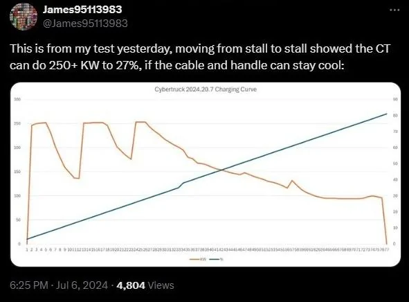

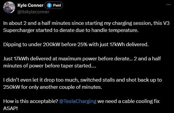

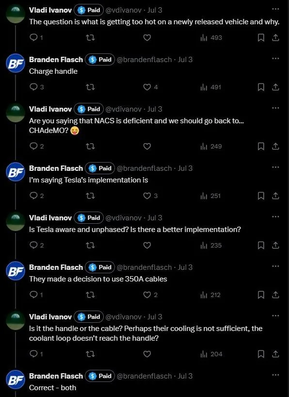

There is a lot of talk about the limitation of the handle and cable recently. Kyle/OoS has done a variety of testing. Branden (below) is in the charger/charing industry.
[UPDATE: When they eventually get v4 cabinets at the "v3.5" supercharging sites that have v4 pedestals (v3 cabinets) and they can operate at 800v that may be very beneficial. Less current/amperage for the same kW (eg 250 kW). Not sure if a similar issue would show up if they push to 350 kW for X number of minutes tho.]
[UPDATE 2: Even the 800v systems at 350kW (vs curr max of 250 kW) should run cooler with lower amperage/current.
625a = 250kw / 400v
438a = 350kw / 800v ]

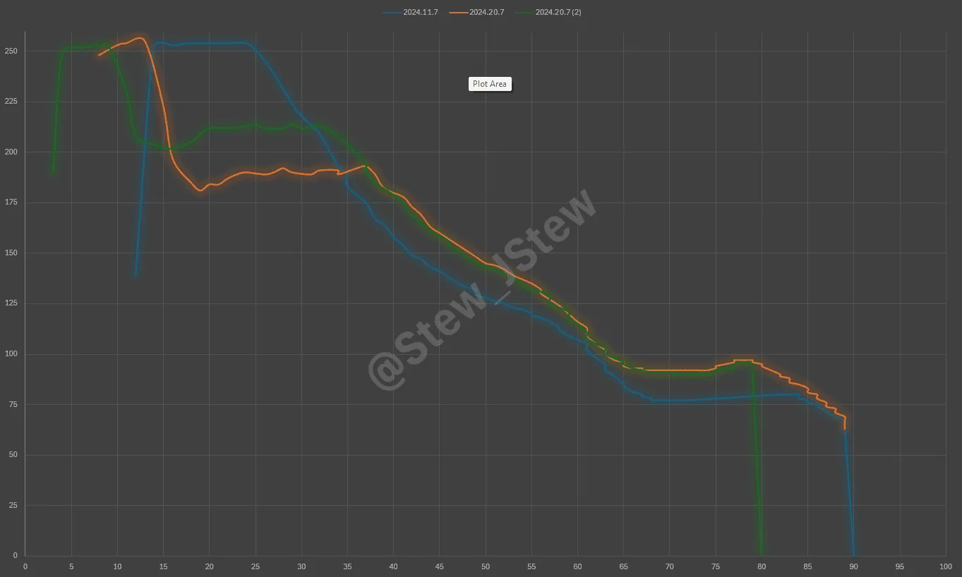

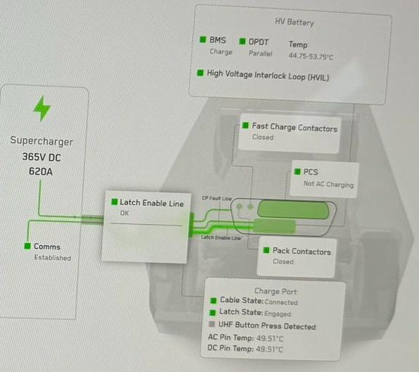

I ran another Supercharging test earlier in the day but still ran into reduced charging rate due to handle temperature. I used the damp rag trick and did manage a better curve, but still experienced throttling very quickly into the session. I also forgot and only tested till 80% SoC but that doesn't appear to be any different curve wise than my first session under 2024.20.7. arrived at 3% SoC in the newest test and was able to add 130miles in 15 minutes.

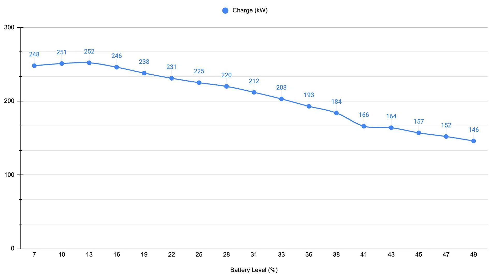

Much smoother curve in the cold, using v4 chargers (still capped at 250kW)
