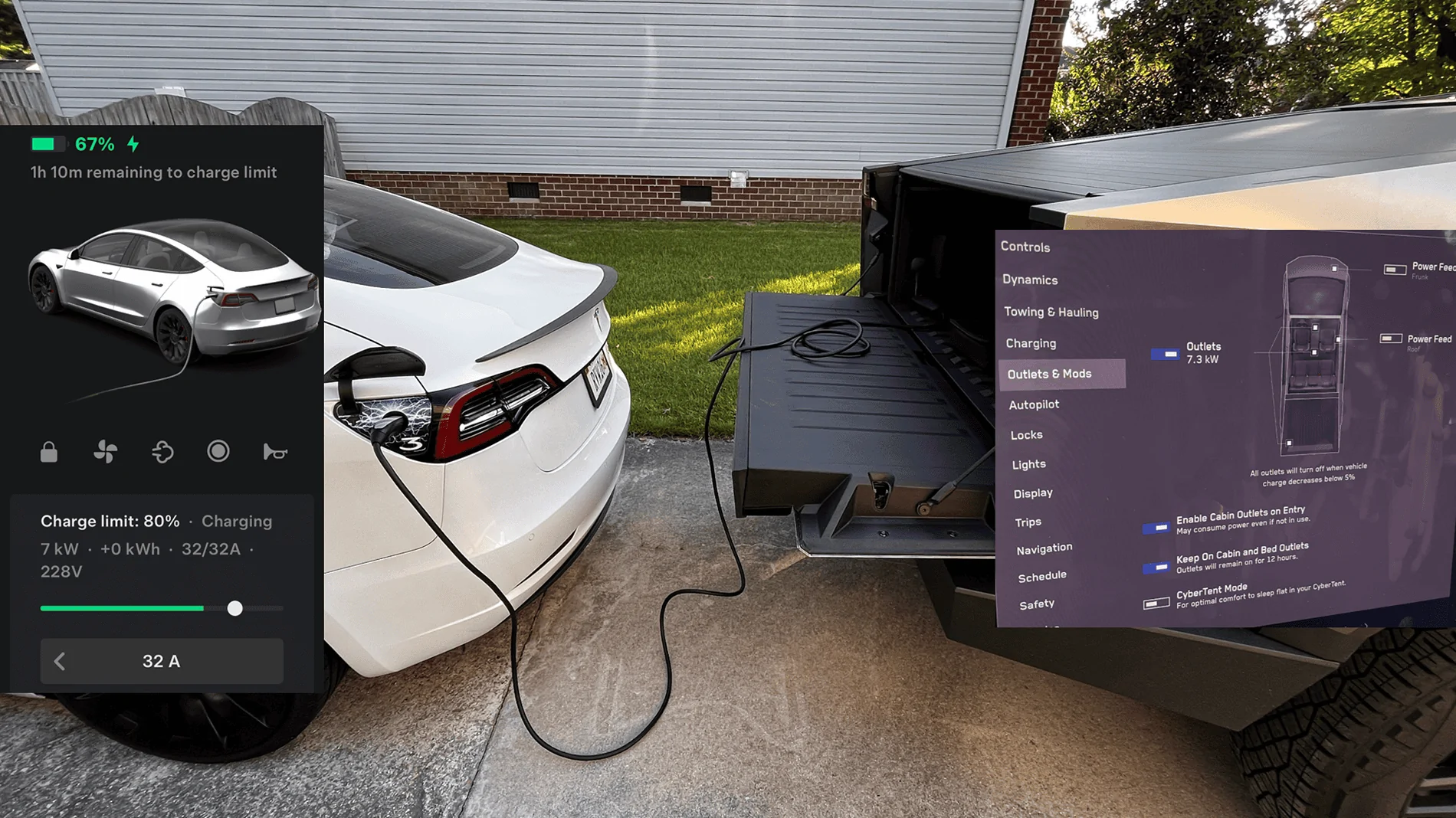

SOLUTION!!!
I was talking to my local Tesla Service Center technician (and friend), and he gave me something to try that worked. It is a known issue that *some* of the NEMA 14-50 adapters for the mobile chargers that come as part of the FS package are defective, and can cause the symptoms I am seeing. His recommendation to me was to swap 14-50 adapters from a different mobile charger and try again. I had another mobile charger handy, so this was easy for me to try.
I did this, and it worked perfectly. I achieved 32A charging at 240V for about 7.4kW. Success. Tesla will replace my defective NEMA 14-50 adapter under warranty.
Thanks to y'all who gave me various configurations and steps to try. This is a great community and very helpful and supportive. Cheers!
