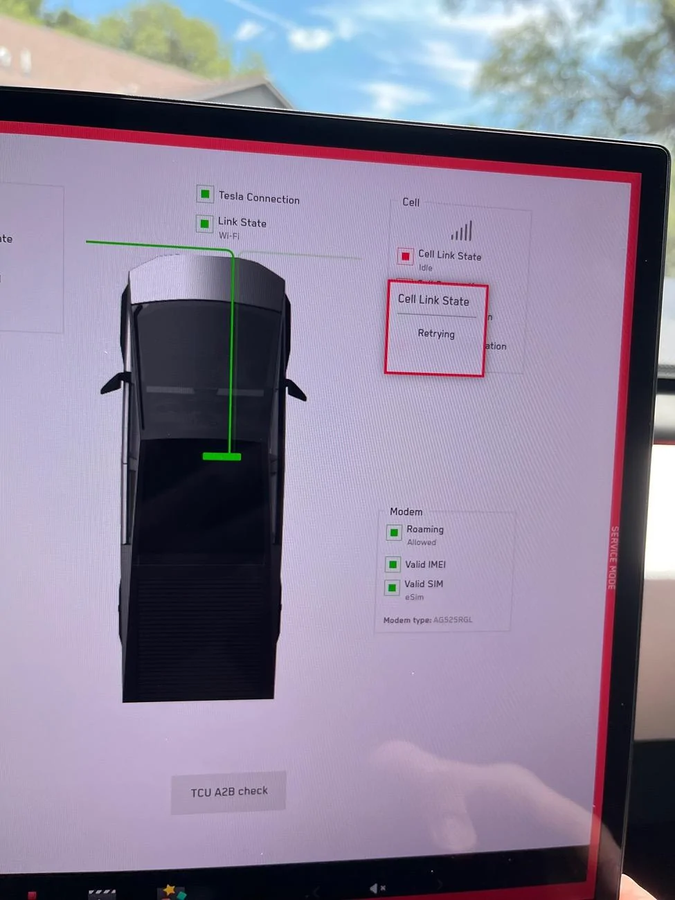

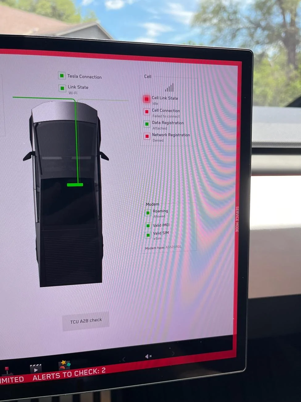

I have the same issue longer road trip 8 hours of driving and on the way back LTE died.
This is what the service mode shows:
Tesla Cybertruck Cell modem INOP IMG_5934
Tesla Cybertruck Cell modem INOP IMG_5933
