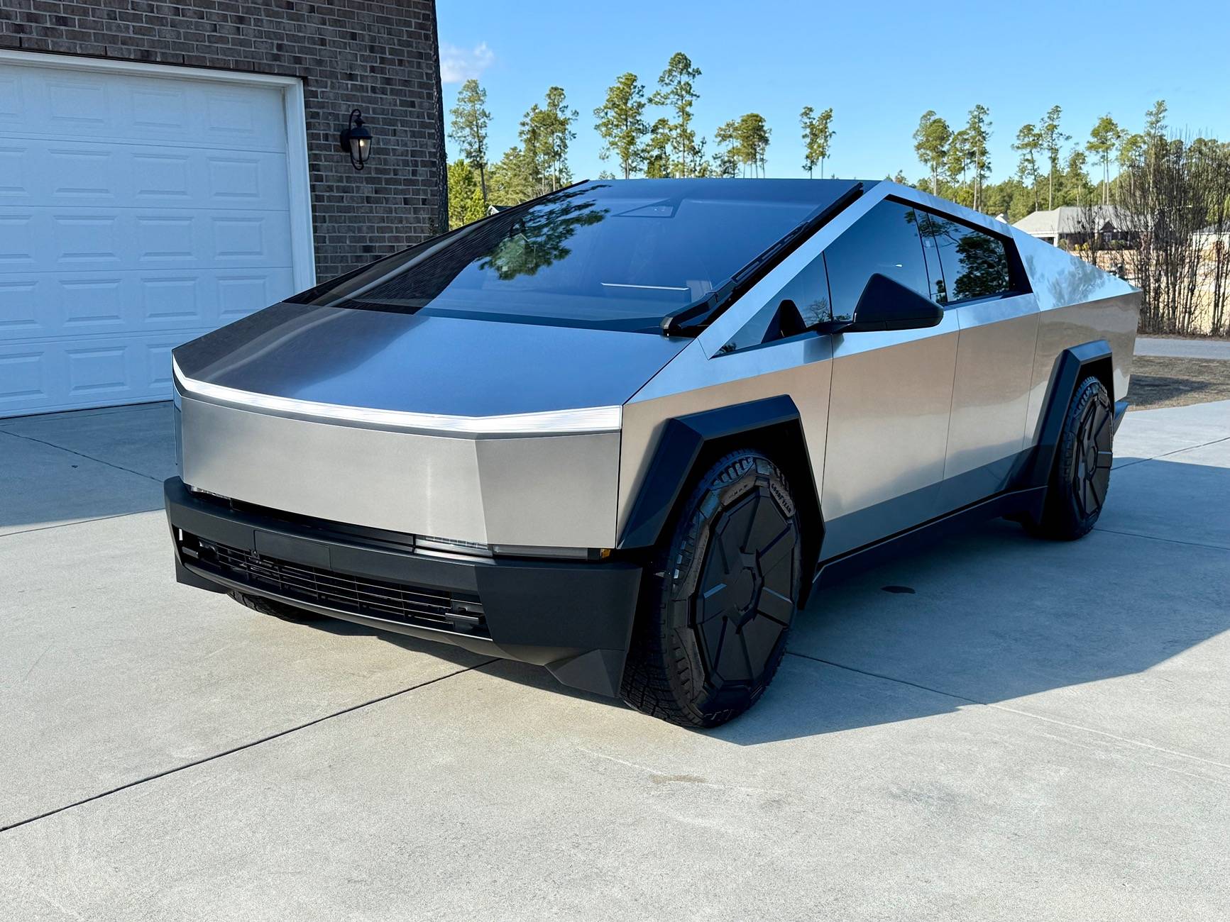

I followed all the steps in one of Colton’s videos and my truck turned out perfect. I’m really happy with the ceramic coating. It’s very easy to keep clean and finger prints aren’t an issue anymore. Here is a good step by step video and a picture of how my turned out.

I coated mine in December. The hydrophobics are still just as insane as they were the day I coated it. Clean. 8 year coating is definitely the best coating I’ve used so far. Good stuff!
