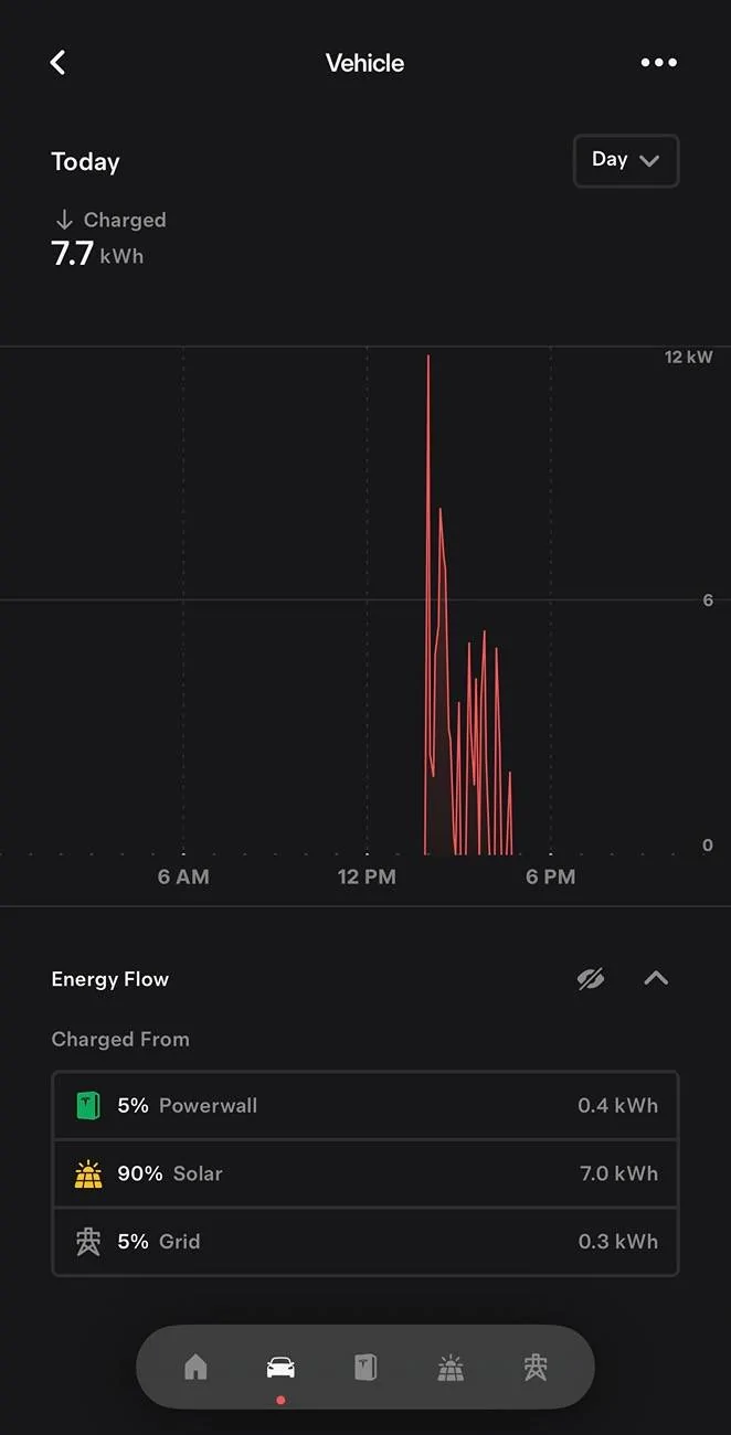

Odd, I also have Solar + Powerwall + Gen 3 Wall Connector + Powershare showing enabled under Controls. It still only charges when there is enough “extra” solar production. Not a ton of solar today but it did a little.
Isn’t that exactly what it’s supposed to do? Only charge with “excess” solar you would otherwise sell back to the grid?l
