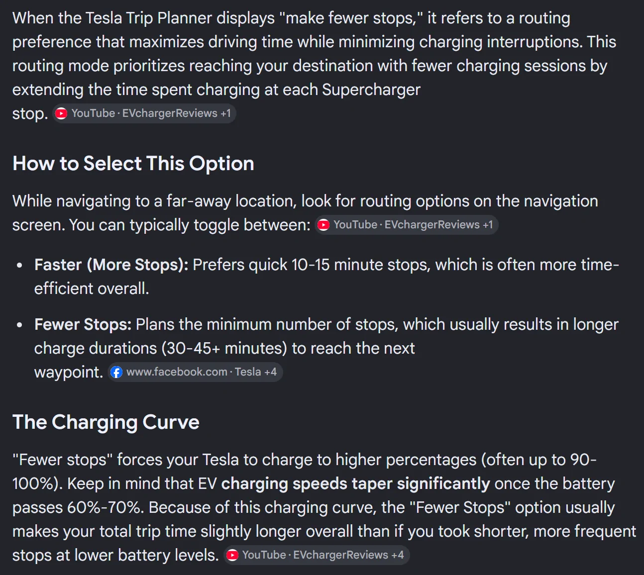

Try disabling "Make Fewer Stops" in the navigation.

This may have been discussed before, but did a longer trip in the last few days and had many opportunities to observe. Basically you pull up to a 350kW Supercharger with say 15% SoC. It pushes ~300kW until you get to say ~30%, then 200kW until ~50%, then 150kW until ~60%... above 60% it's consistently below 120kW and effectively means to get a full charge (if you wanted one) you need more than ONE HOUR (!!!!). That doesn't seem like a breakthrough in charging at all.
Unfortunately this was one of the big letdowns with the CT
Despite the 800v architecture, Tesla videos showing 500 kW charging, the charging rate is acceptable only for a short amount of time before the charge curve hammers it and slows charging.
Tesla Cybertruck Charging rate appears to be below 1C 119209-c9e114cbd4ca40a9192fc1a0260577fc
The coping mechanism for this is "it is better for battery health" but cmon I don't think anyone was expecting over an HOUR to recharge the truck with a 500+ mile range, more less the 250-280 it is getting now.
With the current charge rate with the bigger battery pack it would take about 2 hours to charge the truck if we had gotten the 500+ mile range.
So this is a double whammy unfortunately.
Another common one is "you just charge from 5%-40% when on a road trip" which comes from the crowd that has a supercharger ever 20miles and never pulls a trailer.
2 years post release the range is what it is, and a 1+ hour full charge shows no signs of changing.

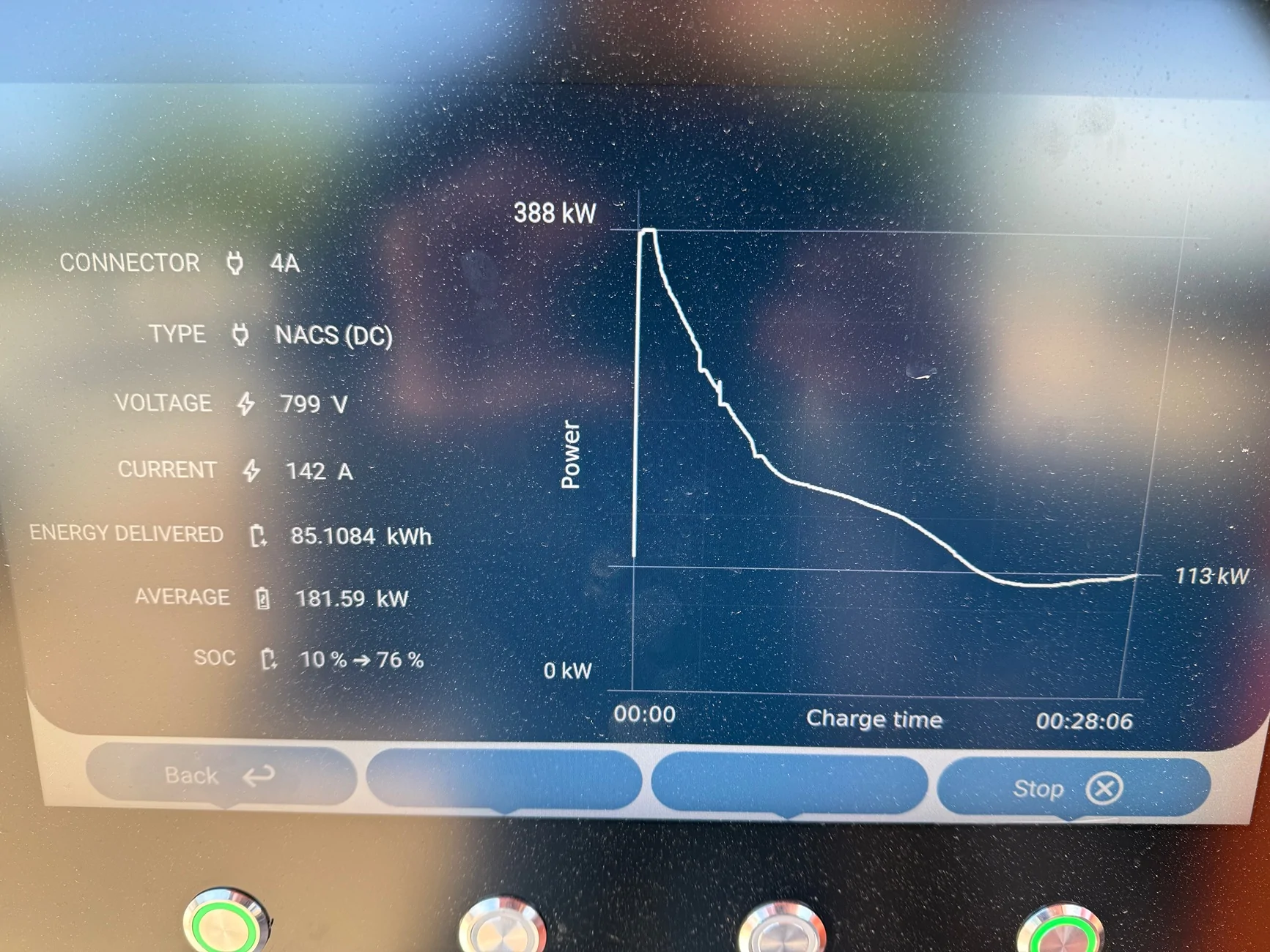

A few people here mentioned like 40 minutes to go from 10-80 or 25-80%. This is why, IMO, faster chargers (like ionna 400kW or Tesla 500kW) make a difference. It doesn‘t last long at the highest power level, but every minute you spend at say 360kW saves 3 minutes at the end when you’re at 120kW. Here’s a real charge curve at an Ionna station, starting at just under 400kW, and doing 10-76% in 28 mins.

Note how it went below 120kW before even reaching ~60% SoC. CT battery is 123kWh, which means 1C charging rate (safe, sustainable charging rate for all Lithium Ion batteries) isn't ever maintained, and this charging curve overall would have resulted in sub 1C charging in the end.

Sounds like you're misunderstanding C-rates. Li batteries are designed to handle over 1C at low SoC that’s why they can pull 350–500 kW early on. But it's not sustainable to hold that output current rate as battery voltage increases. 1C sustained is aggressive for longevity, not a safe ceiling. Towards the end of the charge you would be forcing electrons into their "place" causing excess heat and degradation/dendrite growth. at the beginning of the charge cycle there is ample room for the electrons to move over to the other side of the battery. High power chargers are beneficial because they can really speed up the bulk phase. Charging current needs to taper down as voltage increases, that's why we call it a "curve". Your iPhone does this too.

Also please tell us about CC/CV, and what design considerations were put into the cells to "handle 1C at low SoC."
