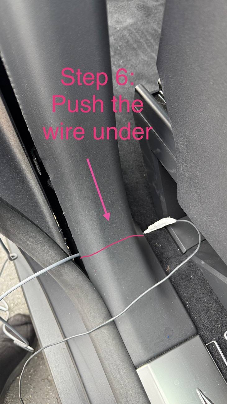

Hey guys, just like many of you who got the STARLINK mini for the recent discounted price, I installed mine over the weekend.
I’ll share with you the parts I used and pictures with 8 steps needed for a professional and clean installation using a suction cup glass ceiling installation.
I took some pictures to show you the path. And wrote the step-by-step instructions on each picture for convenience.
It took me about 1 hour in total, but if I were to do it again, I could reduce the time to under 30 minutes. Please note that the wire path starts at the Starlink Mini, proceeds to the passenger side, and then continues downward, finally passing under the bottom trim to reach the rear center console USB-C Port.
Tools Needed:
-Pry tool set Pry Tool
-2’ long piece of 14awg of Romex electrical wire. 14awg is thin enough to be flexible but also firm enough not to get caught. Romex
- White electrical tape (white doesn't leave stick gunk on the cable) Tape
- Cable Zip tie mounts Mounts
Parts Needed:
- STARLINK Mini
- 5m DC to USB-C cable DC>USB-C Cable
- STARLINK Mini Suction Cup Mount Suction Cup Mount
I mounted the Dish high up on the Glass Roof so as not to hit the head of anyone sitting in the middle seat. I think I will be reversing the Mini compared to what you see in the pictures, so the wire ports point to the back seats, as I've been consistently seeing alignment alerts during testing. I'll keep you updated.
Good luck! And if anyone in Orange County needs a hand, please reach out, and I'll be happy to stop by and assist you.

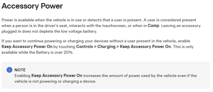

I'm curious why you need to turn on the outlets remotely when parked outside? Do you not use the "Keep Accessory Power On" feature?
Tesla Cybertruck Clean STARLINK Mini Step-by-Step Install Tutorial (DIY). 1749517915200-yf
123
8,717
10,120
Can’t answer for him but I do something similar. The only reason I have for Starlink when I’m away from the car is to monitor fridge/feezer temp which I do with a govee WiFi thermometer.
If I want to check it remotely, I turn on the outlets and wait about a minute for the Starlink to boot.
Then I check the temp and turn everything back off.
I have a bunch of other stuff running on the usb-c’s like lights and chargers and that kind thing which there is no sense in leaving on when I’m away from the car.
I do leave accessory power on which can also power my Starlink if I’m plugged into a level 2 charger because the ac doesn’t work in that circumstance and the net energy balance is way positive anyway.
So basically I just use the interior ac plug as a fancy remote switch.

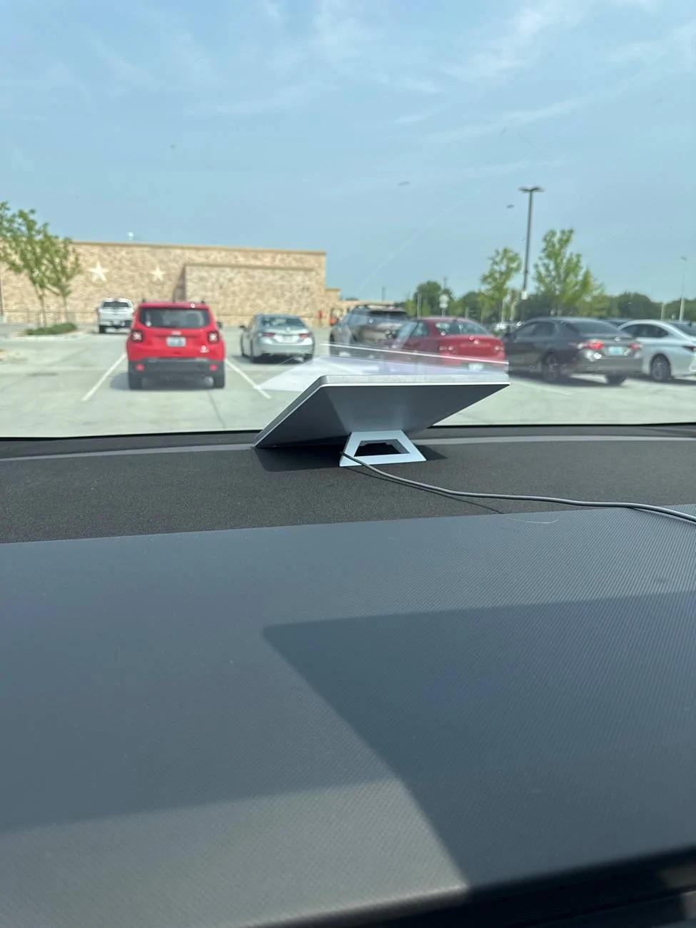

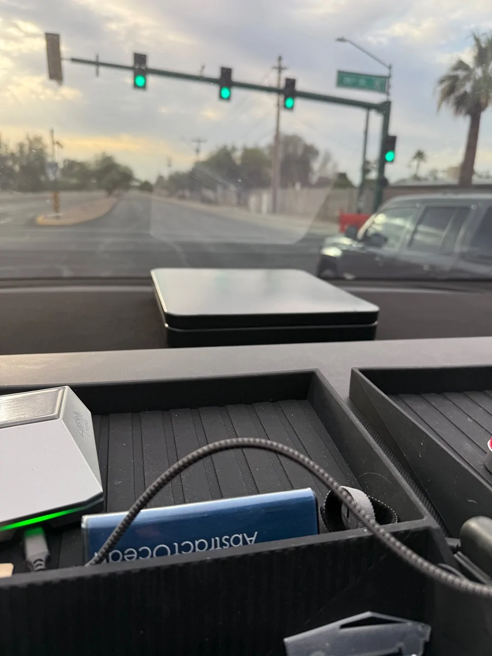

Here’s my clean install. I move it back and put a grey thin shirt over it when driving. My experience with performance at a National Park is crappy. There was 75% obstruction by trees and I had intermittent service (literally up 8 seconds down 4-8 seconds). Good enough for text and email only- not for WiFi calling or work. Really hardened my heart- I had hopes it was magic. It’s not. I do get 150+ up and 14 down in the current unblocked position in the picture below. So there’s that.

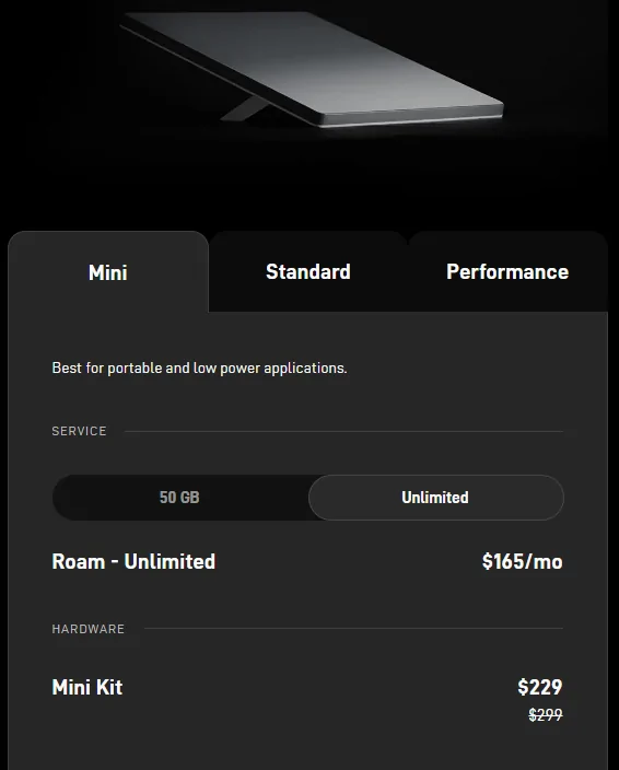

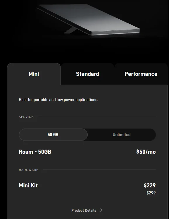

Now is the lowest price for the Mini (excellent time to buy). If this is your first Starlink product, then order it via a referral link. If you know someone with Starlink service, ask them for their referral link; you both get a free month of service. You can use mine if you need https://starlink.com/residential?referral=RC-DF-7014322-18454-39
If you are planning to use this with the truck, the Mini is built for it. Consumes less power, small profile but still gives you 100-200mbps speeds.
There are lots of mounting options for the Mini and all can easily connect to the 110v outlet in the bed for temporary use cases. For permanent installations, consider using the 48V lightbar power option or using the mini inside the truck on the dash or roof glass.
You could use a "battery pack" to power the mini but your truck is a massive battery already.
After living with the mini installed in the truck for the last 6 months and lots of long multi-day road trips, it's still a "nice to have" and definitely not a "need", at least in my case. It does give me comfort knowing that I will always have a life line communication, no matter where I end up driving.
As for service plans, you will need to roam plan which starts at $50/month for 50G (perfect for if you plan on using it less) or the Unlimited is what I;m using. You can always switch to the standby service ($5/month whenever you want if you dont plan on using the service.

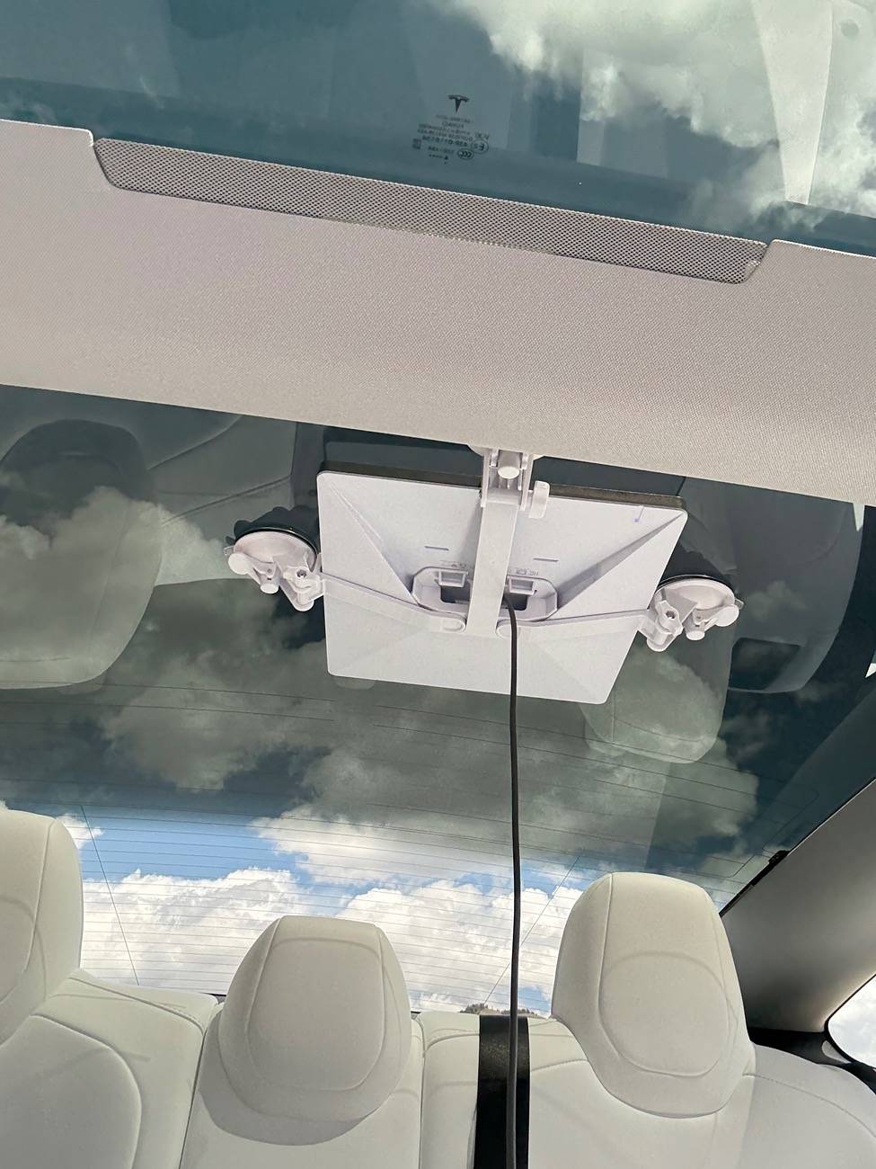

One thing I want to add is consider running the mini inside the truck as many of us do. It can’t be stolen, isnt exposed to the elements, has no aerodynamic effect and in my opinion works just as well.
Many mount them to the roof glass with suction cups.
I have mine in the windshield area.
