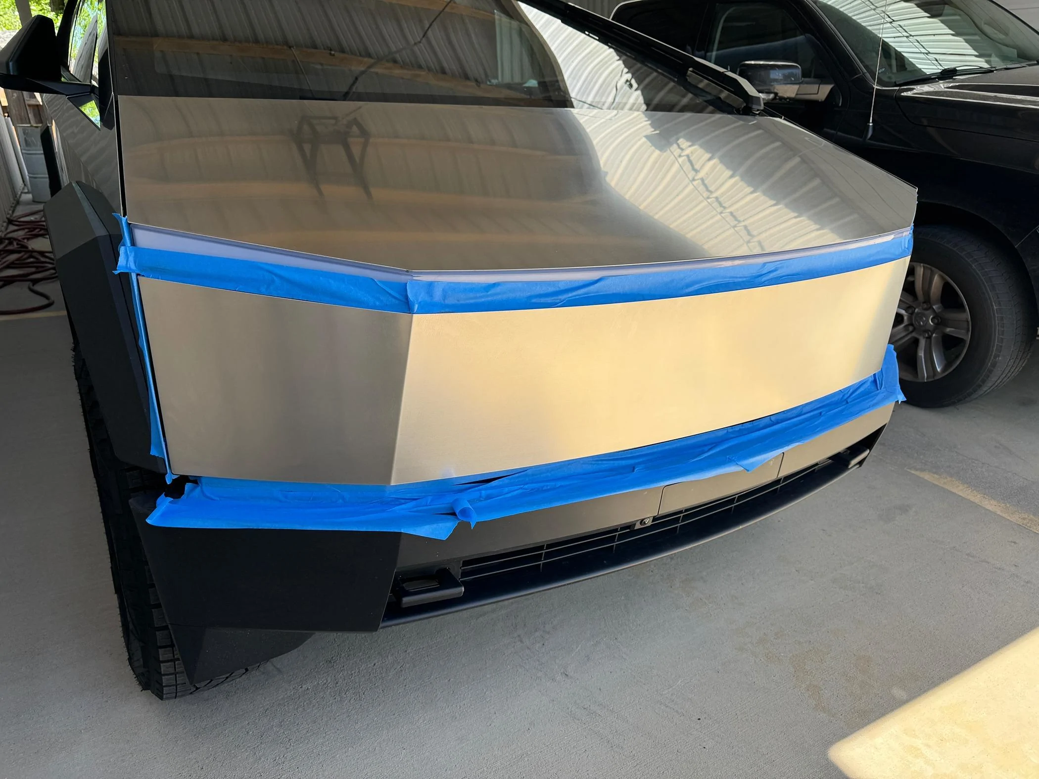

After reading endlessly about taking care of the stainless, I dove in this morning. BKF, sponge, copious amounts of wide painters tape, many microfiber towels, and ammonia free Windex.
Things to share:
  • I put the truck on HIGH suspension to make it easier to get to the low panels.
  • It takes quite awhile to apply the masking tape around each panel. And a lot of tape.
  • It's hard to get BKF applied evenly across an entire panel, and you can tell if you don't.
  • I rinsed with Windex, and used 2 towels, but I wasn't happy with the last wiping because I was not able to get the panel completely streak free ever. I ended up spritzing the dry-ish towel and working the panel until it was done. I'm sure like many, I'm picky and that was a process.
  • After 2 panels, I changed the rinse to my bottle of ONR, and added a cup of 91% alcohol (Like Texarado). I used this from this point on.
  • After 2 more panels, I switched to paper towels for the initial rinse removal. It was faster and didn't have any apparent affect on the panel.
  • I don't want to do this very often.
It looks much better, and it did remove a palm print that ONR didn't remove, and whatever was used by Tesla to try and remove that print, as it ran down the driver's door leaving a stain, and I couldn't remove it until I used BKF.
I guess we will all need a towel and a bottle of ONR mix for finger print removal. I know I will be keeping one with me
Doing the front:
Tesla Cybertruck Cleaning - BKF not working -scrub harder? front
