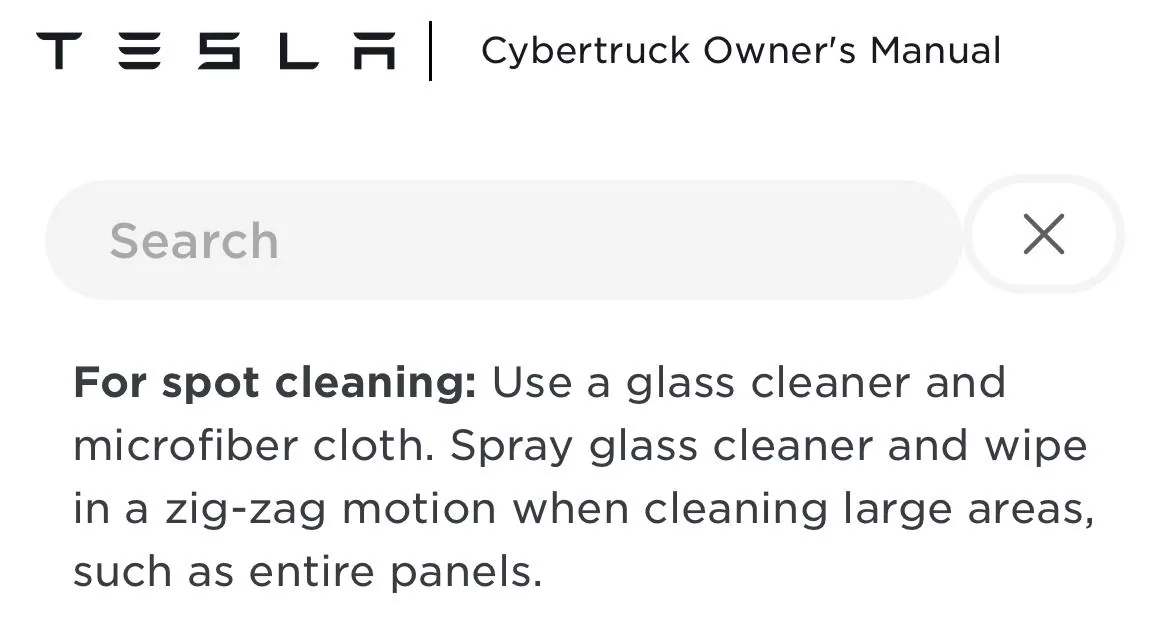

I think I should try and clarify further. For my initial cleaning I was definitely not adding Windex to Bar Keepers Friend More. Don’t do that. The base will neutralize the acid. Applied separately, the BKFM (acid) cleans the oils off of the steel, then the ammonia (base) in the Windex neutralizes it.
Do not let BKFM sit on the metal longer than 60 seconds at a time.
This worked like magic for me. It removed marks and stains that I thought looked like permanent damage and left an even finish, except for the worst spot I was sure was some sort of scratch. By the time I had applied it 6 times the mark was almost gone, and the door has a small slightly shiny(er) area. I will work this entire door, with the entire truck immediately before sealing, and I don't think it will be noticeable. Time will tell but I like the shine better than the black scratchy thing.
Personally, I would not do this regularly and to make upkeep easier I am sealing with Protectaclear. I live in an area with heavy bugs in the summer and salty roads in the winter, both of which I'm concerned about keeping clean with an unprotected finish. That being said, I have used Windex to swipe fingerprints (see Cybertruck owners manual clip above) and it's working great. I need to pick up some denatured alcohol and get this thing sealed!
