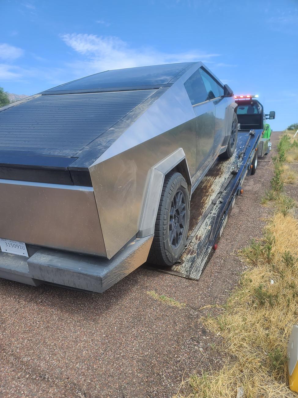

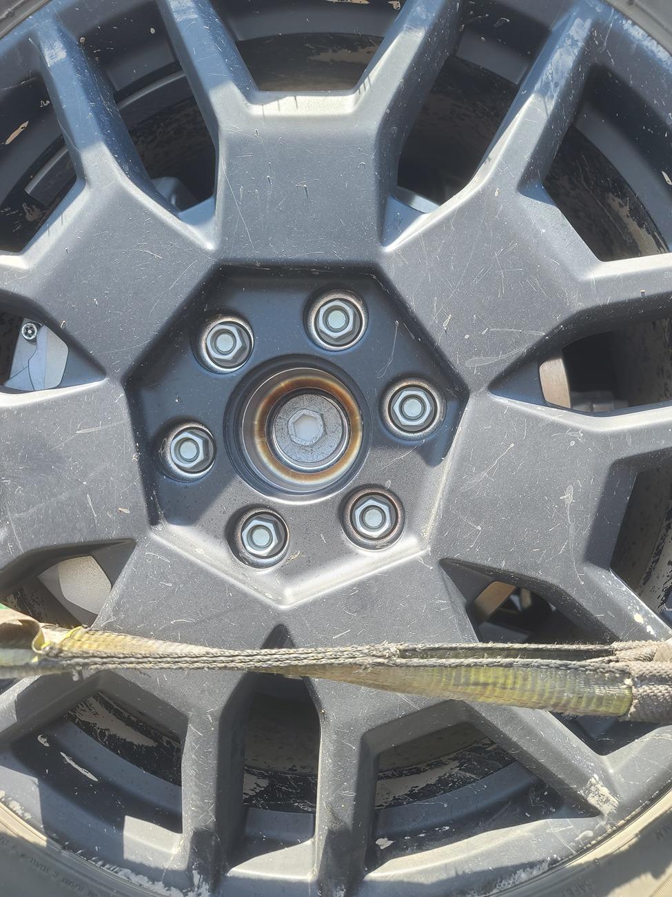

Well we didn't make it to the appointment. Yesterday, we were driving for about an hour, and on a turn to the right there was a horrible crunching sound. Got out to look, and the center of the wheel was spinning freely when we moved forward. Called Roadside Assistance and flatbed arrived to haul it to the Mesa AZ service center (about 90 miles away).

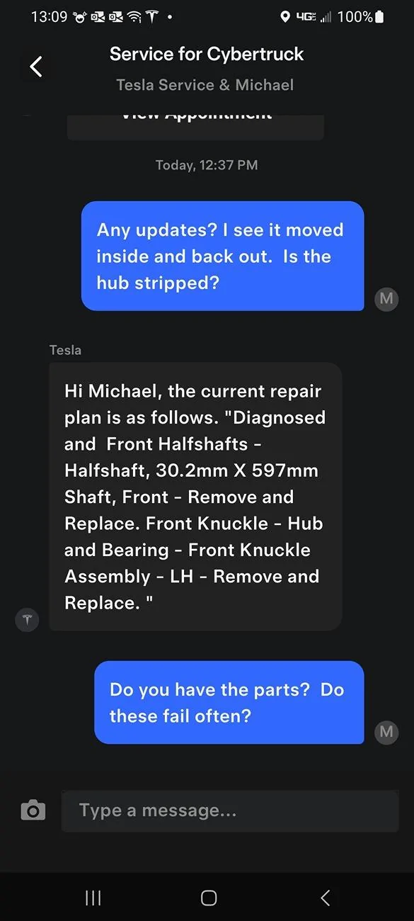

I attached the comments from Tesla. Their parts people are trying to locate the parts.... You can see in the photo if the wheel that there is an irregular shiny circle.
They gave (after me insisting strongly) us a MYLR as a loaner.
