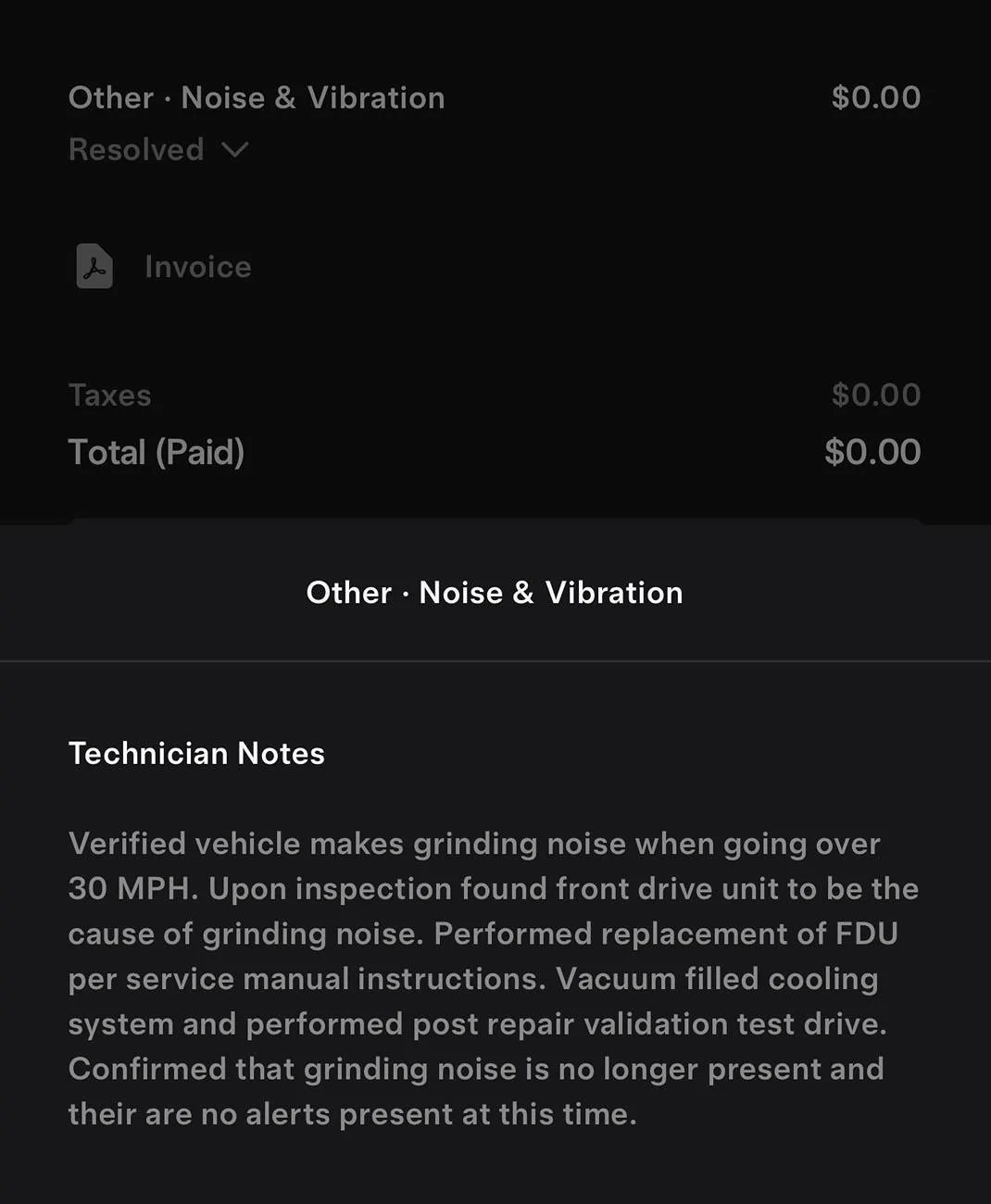

Front drive unit was my issue! Just picked up CT today and finally the noise is gone!
Thanks to @mmdotking for providing technician notes on the fix!
I included a screenshot from today’s service!
Did they have to send noise to engineering to get approval?
Was this a cross-thread post? I dont see any mmdotking posts in this thread? I think the issue is actually the coolant system (for the video noises uploaded in this thread)- i just ran a purge and now the sound from the videos uploaded is actually worse, but now hopefully its loud enough for the techs to not say "i can't hear anything".
