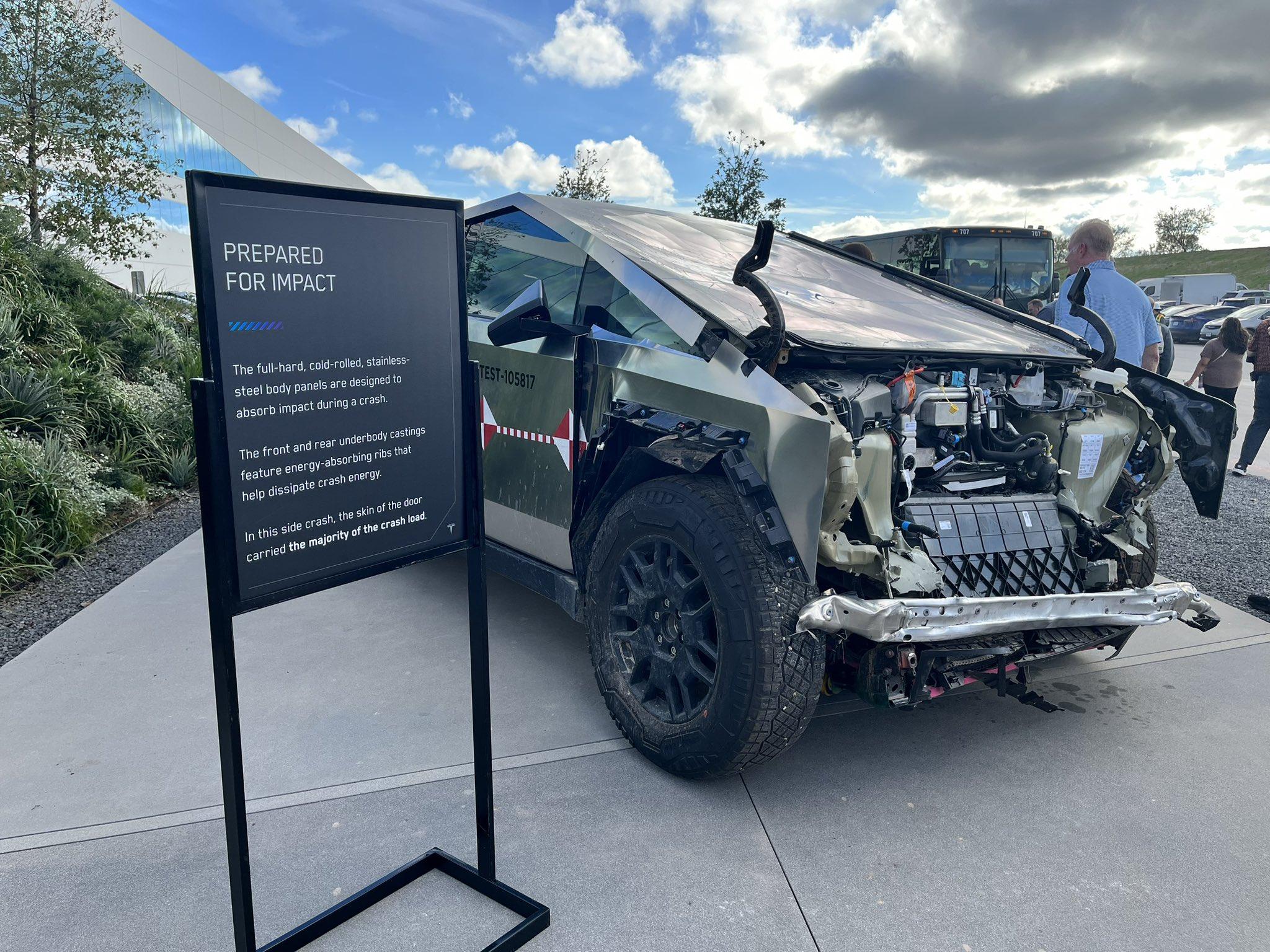

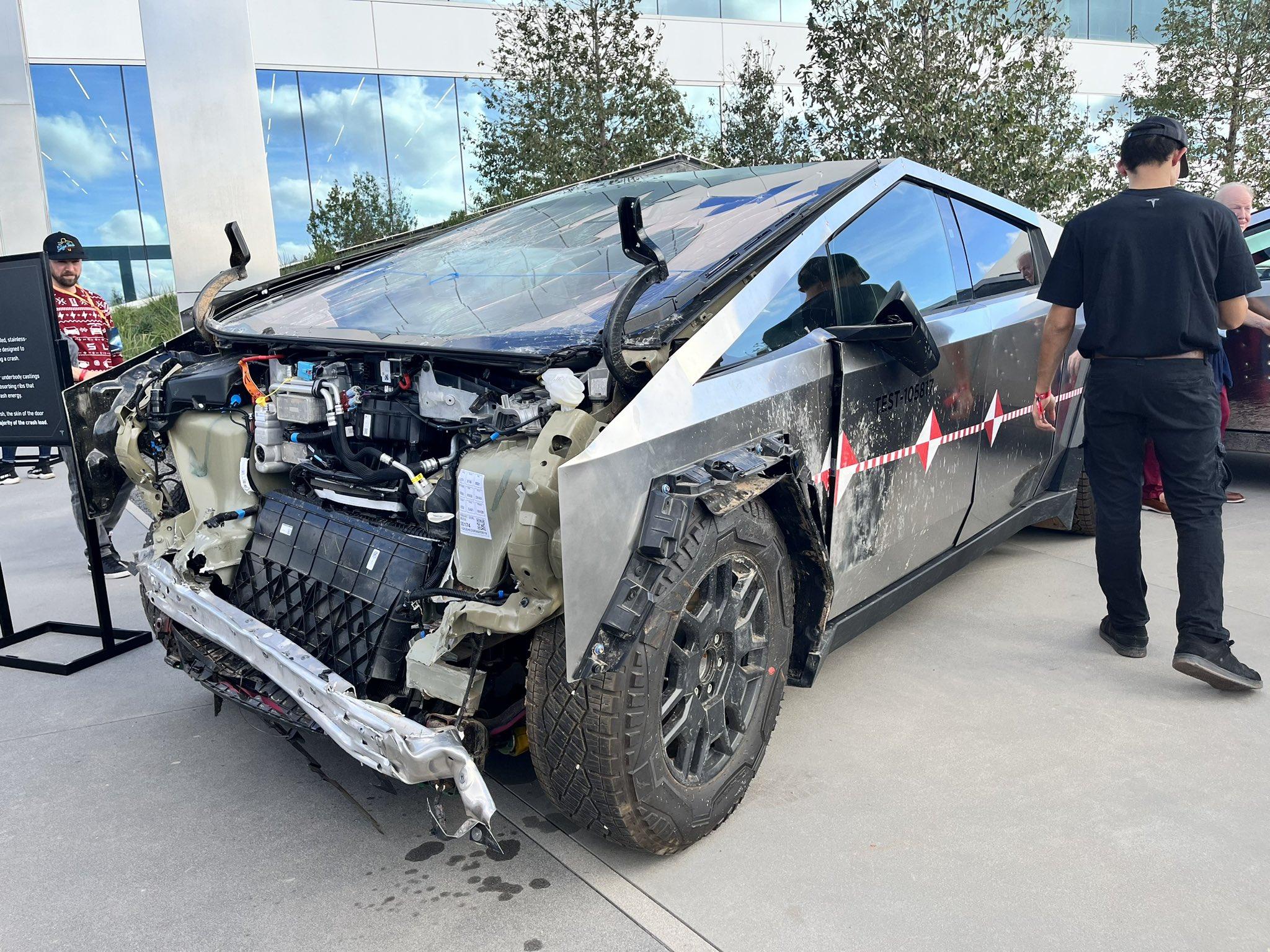

The whole point of having a compressible front structure is to reduce the g force load on the passengers. You want to have a slow deceleration of the passengers not a fast one.
This is simply because you can reduce the impact energy of the passengers by increasing the time the energy is absorbed over. This works because the car hits well before the passengers are subject to the forces, and can also move forwards into the restraints and airbags.
An abrupt stop from a non-deforming front structure means all the force is put on the person instead at one time, meaning unsurvivable amounts of g-forces that would crush and tear a body apart.
Imagine falling onto a mattress or a solid concrete floor. The car is the passengers "soft mattress" in a collision and must compress to reduce the force.
This way the people survive the impact but the car doesn't. This is intentional and by design in nearly every modern vehicle.
The best crash is a totaled car where you still walk away from.
