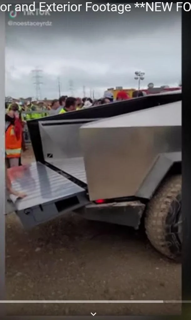

The hard plastic bumper is attached beneath the truck bed at the tailgate hinge area. I noticed this last night when watching footage of the CT at the Austin construction site.
Tesla Cybertruck CT rear bumper is not a bumper bumper-tailgate
My initial thought was, hmm... thats gotta probably cause some long-term durability issues if you are loading gravel and similar loose material into the bed, especially when opening and closing. My second thought was.. where is the additional tailgate support cable? Some truck tailgates have a cable that attaches the end of the tailgate top to the side walls for added weight support. This tailgate as shown in the prototype has no visible support other than the hinge itself.
I went looking for more detailed actual video of the interior elements and this tiktok was the best view of random interior elements like the door hinges and arm rests/foot area/pedals/etc. Spent some time pausing the vid for the split second it showed different obscure interior elements like that stuff.

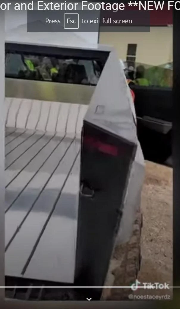

Also, another thing I just noticed on rewatching that video. The rear brake lights are duplicated on the back side of the sidewalls where the tailgate latches are. This is so when you are riding with tailgate down, you still have brake lights (given the brake lights exist on the tailgate).
Tesla Cybertruck CT rear bumper is not a bumper bumper-tailgate-brakelight
Useful design element to remedy a legal requirement.. although I'm not sure how durable riding around with the tailgate down actually is, given the previous mention of no cable support attaching the tailgate to the side wall... especially given the severly obtuse angle of the tailgate when it is in the down position as seen in this next photo:
Tesla Cybertruck CT rear bumper is not a bumper tailgate-obtuseangle
With a 3500 lbs payload capacity and that tailgate design which hangs lower than 90 degrees, and no additional attempts at supporting the tailgate from over-extending, I would be really concerned about the durability of tailgate if you are constantly loading motorcycles, or someone is loading a heavy pallet into the bed and accidentally puts too much weight on the tailgate.

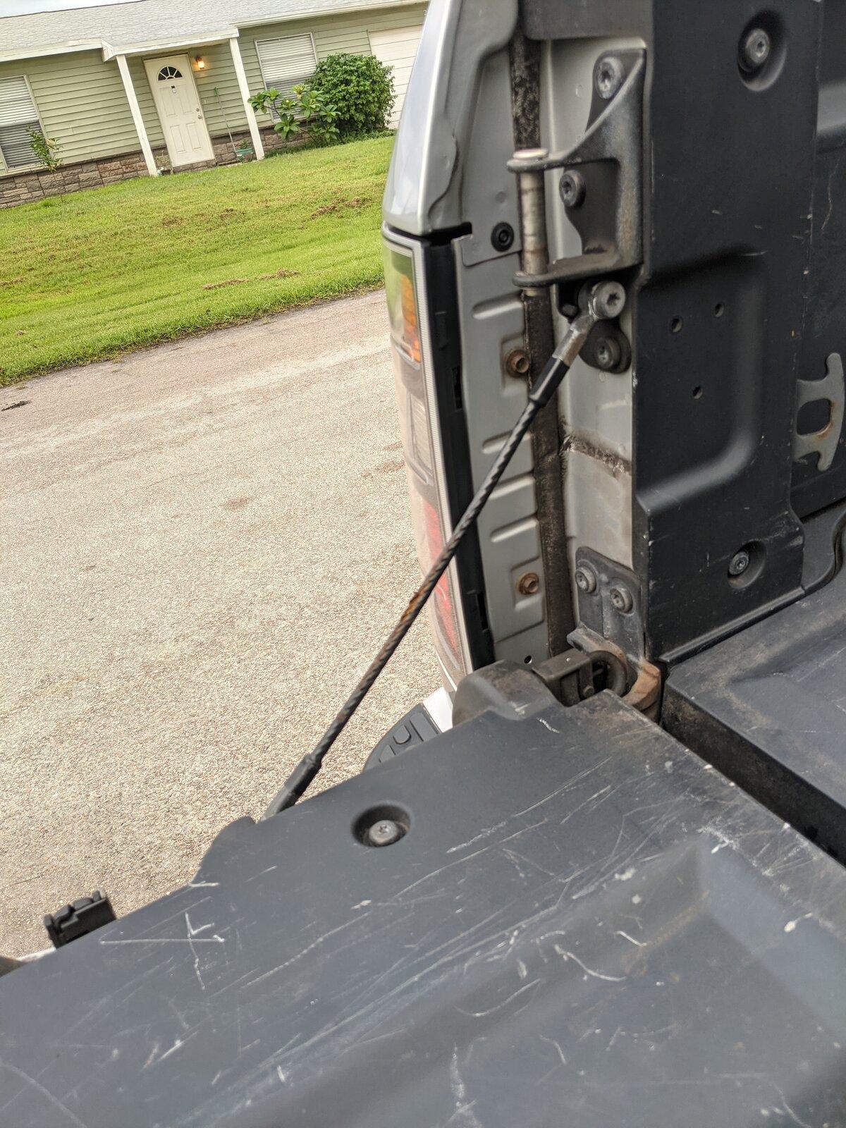

Not perfect solution, but at least its something additional to prevent the hinge from over-extending:
Tesla Cybertruck CT rear bumper is not a bumper PXL_20210816_231713051
This is the stuff I am more interested in hearing about.. over the endless hypothesizing.

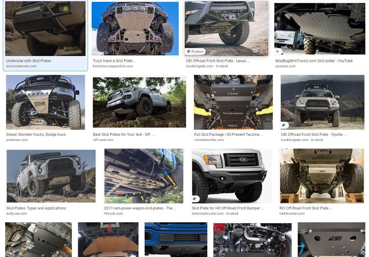

Again, Wrong. Bumpers and skid plates are 2 different things. Plastic on a bumper is fine and I saind nothing about bumpers. Maybe you have never owned a off-road truck. I have attached an image of many SKID PLATES for a good example of what they are. None are plastic, all are metal. If you hit a bolder while off-roading with a plastic skid plate, you are screwed. Thats why they dont use them in plastic form. The Telsa Cybertruck front plastic bumper that extents under the truck is a cover, not a skid plate. It will not be whats on the final version at least the part under the truck. Hope you now understand what a skid plate really is.

Again, Wrong.
Sorry, but you're wrong. Guys like metal because they're guys.
The skid plate on my car is plastic. It's only broken off once. And it was cheap. Tho to be honest, only the pins broke so I wired it up on a harness and the replacement plate is still in my parts box.
Metal and plastic both do different things; hard means harder to puncture, but if you're on a flat plain or gravel, you want to not dig in but slide off.
If you're doing rock climbing, you might want metal because the full weight of the vehicle may come down on the plate. Even so, you might prefer to slide off of rock instead of getting stuck on it.
Just because you personally want a metal skid plate doesn't mean the weight and lower friction aren't useful properties.
PS - only the approach and depart curves are plastic on the prototype; it's steel where the weight of the truck might come down or debris comes up and threaten the battery pack.

I agree that most skid plates on trucks and jeeps are metal, but for SxS the best skid plates are 3/8'' or 1/2'' UHMW (ultra high molecular weight) plastic. It's quieter and more durable thank aluminum. It definitely protects from boulders, etcj as mine has protected my ranger from countless impacts.

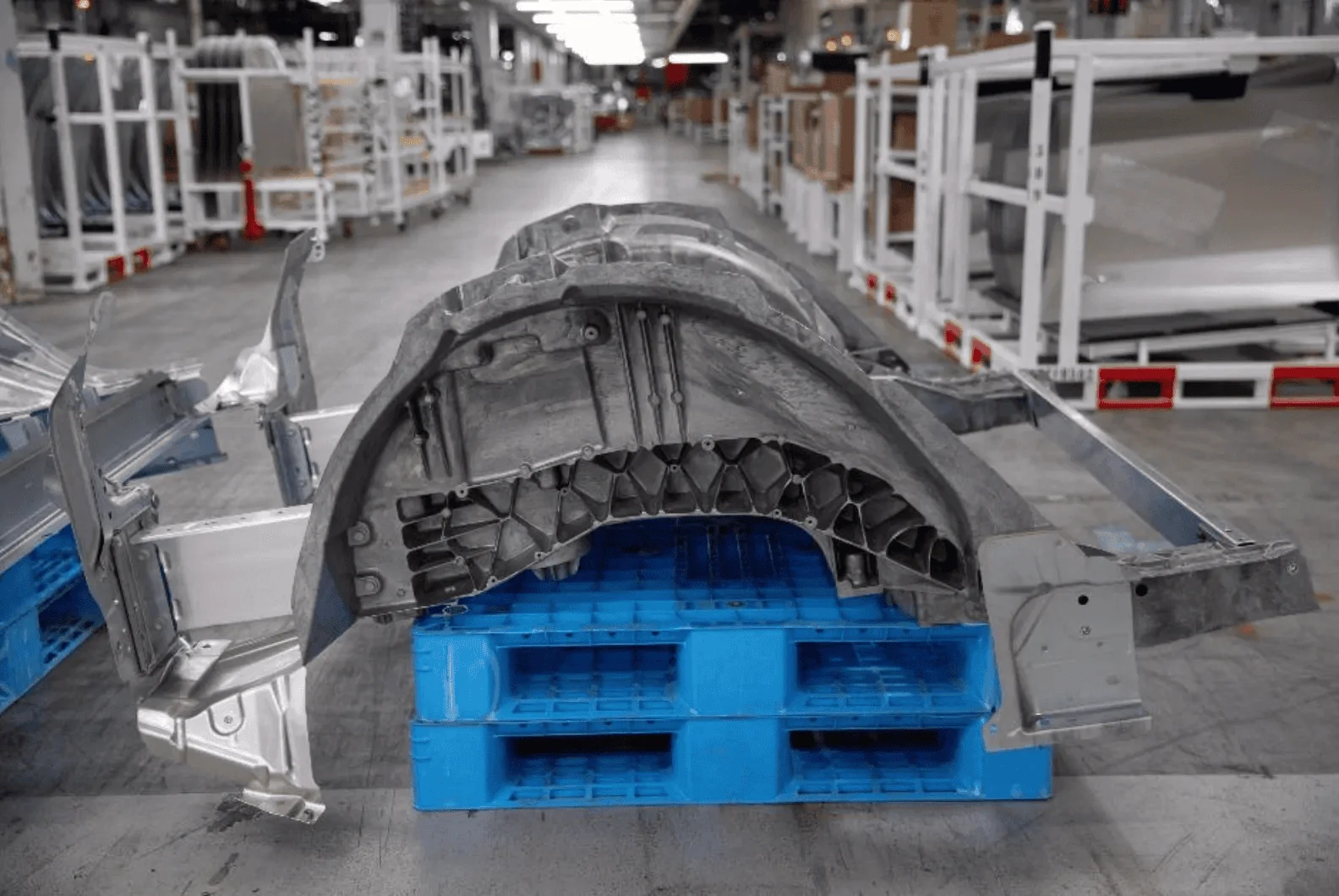

Very very early on, a Tesla hit some road debris, the underside of the battery cell was punctured, and the car caught fire. I think the driver was fine, but as a result Tesla recalled the Model S and reinforced the underside to prevent similar punctures. I'm quite certain since then, Teslas have a pretty rock solid underbelly.
Obviously none of us have any idea how tough this extended bumper is or what's directly underneath it. My assumption is that it attaches directly to the single piece rear end (below one is from a Model Y).
Tesla Cybertruck CT rear bumper is not a bumper 1629160604105
If the one on the Cybertruck is similar, there is probably an air pocket between that black bumper/ skid plate/ air dam piece. I could see them putting some ribs/ baffles/ honeycomb in there to stiffen it up in case a rock bounces up.
It's going to be really hard to say how tough this piece is until it gets out in the wild.

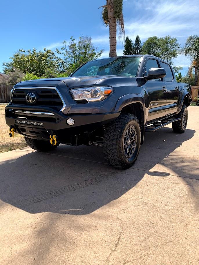

Most new trucks/SUVs/Jeeps come with bumpers designed for pedestrian and crash safety. They are also made for aerodynamic drag , to shield the tires from resistance.
This makes sense for most truck needs. But that is absolute not going to work off road. With my 2018 Tacoma some of the first things I did was remove the front and rear bumpers and add high clearance metal bumpers . I also added rock sliders. This is done out of necessity to prevent body damage / scarping over rocks (usually).
Tesla Cybertruck CT rear bumper is not a bumper Yz_0JZviT3OCGEcFkw7TFPpbVI=w686-h914-no?authuser=0
The advertised departure and break over angles manufactures list can be ignored because you are going to end up modifying it will aftermarket off road bumpers ( if you are at all serious about using the vehicle "off road").
My biggest fear is taking my CT off road for the first time and watching it embarrass itself over easy obstacles. Excited to see. It's certainly going to get the stock "torture test" when I get it :) . Scraping ? Bottoming out over dips? Who knows maybe not?
