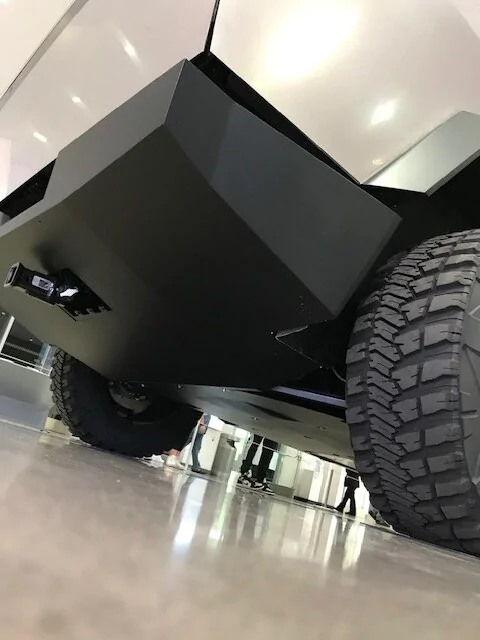

Not sure why this took me so long to notice, but this post from @Mini2nut https://www.cybertruckownersclub.com/forum/threads/ct-photos-no-renders-please.3642/post-64300 contains the following picture of the rear bumper assembly
There are other threads about bumper materials and potential aftermarket parts, etc.
But this isn't just a bumper--same is true of the front! I misunderstood this big time. Here are my observations:
  1. This piece covers the entire approach/departure openings, unlike every other bumper I've worked with. Since there's no exhaust, muffler, etc, to work around.
  2. There's no way this is going to be anything that isn't very tough, like plastic. At a minimum it will likely have rigid structures inside a plastic wrap. Thoughts?
  3. It's not at all attached to the towing hitch. So where is it attached? The stainless steel? I struggle with that.
  4. With the 3.5k lbs load capacity, is there a good chance that these will be extremely heavy. Say, powder coated steel?
Anyway, wanted to share my recent observations. Maybe everyone else is well aware of this point and I'm just now catching on ?

Nylon plastic makes a pretty good skid plate, as it becomes a lubricant between abrasive surfaces like a bushing.
Ahh, no they don’t. That’s not the function of a skid plate. Skid plate is designed to prevent damage to what’s behind it. A piece made of plastic is just simply a cover, it not protecting anything. Cosmetic only. Tesla will for sure need a skid plate on the cyber truck but that’s not what’s showing on the prototype at this time.

Many vehicles have a plastic body-colored bumper cover, plus (at least at the front end) a black plastic underbody panel meant to minimize the amount of road grime that drifts into the engine compartment. The former is cosmetic, the latter lightly-protective, and both can help with aero somewhat. On some vehicles I've had, the plastic underbody panels are attached to the bottom of the bumper cover with a bunch of retainer clips.
Tesla seems to have just merged those two bits and eliminated some fasteners in the process. Nice improvements there to cost and manufacturing efficiency. Still helps with aerodynamics and will help keep the grime off of whatever they put behind there (presumably airbag sensors, at least). Cheap, hopefully, and easy to replace, maybe.
I suppose aftermarket replacements could be fitted and that means people will, eventually, but this seems a bit hairy. Any really good designs for that will have to behave very similar-to-factory in an accident (since we do love our lawsuits in the USA). These might be pretty easy to wrap or paint, though!

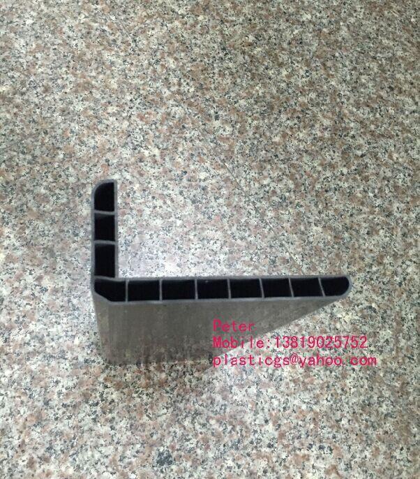

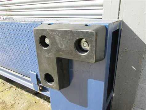

Thick, hard plastic can definitely protect things or act as a hard, durable bumper. Before LineX more or less took over the market for bed liners, plastic bed liners were pretty common and quite durable. Even LineX is essentially spray on plastic.
Loading docks often have hard plastic bumpers.
