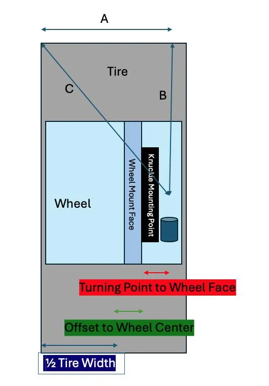

Sure, see below,
Results
Tire/Wheel 1
Maximum Rub Point (C): 18.69 inches
Front Poke: -0.42 inches
Rear Poke: 1.08 inches
A (Knuckle to Tire Face): 7.08 inches
B (Tire Radius): 17.29 inches
Tire/Wheel 2
Maximum Rub Point (C): 19.84 inches
Front Poke: 2.18 inches
Rear Poke: 3.68 inches
A (Knuckle to Tire Face): 9.68 inches
B (Tire Radius): 17.32 inches

laymen's terms does it rub or not?

haha I'm also trying to figure this out. Math is hard and my brain isn't mathing.
I know I don't really care about all that mathematics I just want to know rub or not and how bad if it does and also, I like poke and more importantly I like some rim depth too, all my life it's deep dish and now WTF the wheels are like hub caps!
