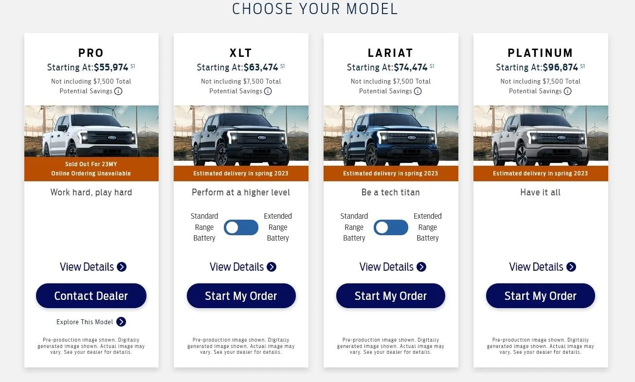

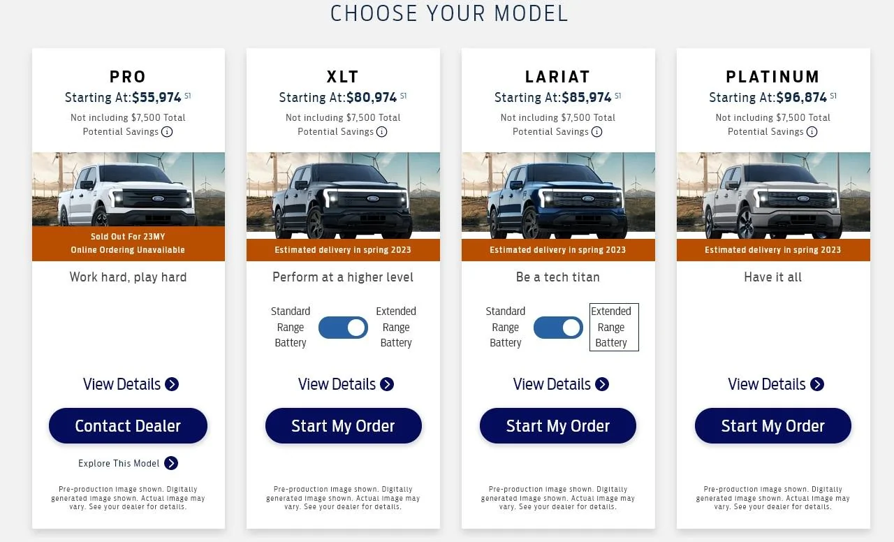

Yesterday I got word from Ford I could order a Lightning. But OMG the price really went up from the original reservation in May 2021. The Pro version which was originally $39k is now starting at $56k, a $17k increase, and they aren't even available it seems, sold out for model year 2023.
So the next higher model, the XLT, starts at $63,474 but really over $65k due to transportation charge of nearly $2k. And with the options I would want (bed liner and cab liner and an upgrade that adds things like heated steering wheel, etc.) it comes in at $71k.

I am having trouble getting my head around a $71k pickup truck. Yes I could swing it, but can I justify it?
Sticker shock. Can you say "bait and switch?"
---the action (generally illegal) of advertising goods which are an apparent bargain, with the intention of substituting inferior OR MORE EXPENSIVE goods---
Or "price gouging?"
--- Price gouging is a pejorative term used to describe the situation when a seller increases the prices of goods, services, or commodities to a level much higher than is considered reasonable or fair. Usually, this event occurs after a demand or supply shock. ---
Will the Cybertruck have the same enormous price increase over the 2019 reservation price - probably. Will the Chevy Silverado EV's advertised starting price ($39k) experience the same price inflation - probably.
And how long will I have to wait for either the Cybertruck of the Silverado?
In the Ford Lightning forum there a a good number of people deciding not to go forward due to the enormous price increase and the unavailability of the cheaper model. At least they are saying that.
Add to that, if one opts for the extended range battery, the federal tax credit disappears since it goes over the $80k limit even before any options are added!
Tesla Cybertruck Cybertruck 1000V Architecture + V4 Supercharging Confirmed!! ⚡️ "It's Going to be Used for Cybertruck Too" - Elon Musk extended range battery
A $17,500 price jump for the ext range battery?! That only adds an estimated 70 miles of range?!
