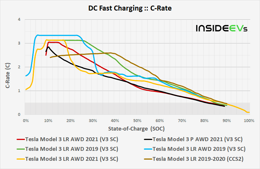

I think I disagree, there is a C-Rate cell level limitation on charging (otherwise you will damage the cell):
C-Rate (peak 2.5) of the new Model S Plaid is even lower (18650 cells):
Semi has 1000kWh so its about 12-13x the amount of batteries as a Model 3 LR. Model 3 LR does about 3.0 peak C-Rate. That means Semi peak power @ charging while maintaining the same peak C-Rate would be 12 x 250kW = 3 MW. Average C-Rate is usually between 1.4-1.7 ~125kW. That's not factoring in all the massive cooling required for the Semi and it probably gets a lot hotter a lot faster.
That being said. Cybertruck may see a peak charging power of ~625kW (if 187kWh size pack). We are looking at around ~500kW peak if the pack size is 150kWh. Tesla will of course dial that pack to increase longevity of the battery pack. Would love to see CT hit speeds about 400kW, its certainly possible! But 1000kW is far-fetched.
C rate is due to internal resistance as is heat generated. Yes semi can charge at high amperage because of large number of cells, however this does not translate to CT any more than Model 3 or X charge rates do. CT will be using 4680 batteries and we know they have lower internal resistance than 2170 or 18650 cells due to battery day slides saying so. We don't know the actual value.
1000v pack architecture will also significantly change pack C rate.
