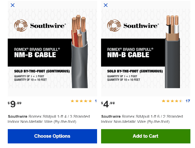

What's funny is that the expense to install NEMA 14-50 can be more expensive than installing the HPWC. Why? NEMA 14-50 takes three conductors + ground. HPWC needs only two conductors + ground. I recommend NEMA 6-50, which only takes two conductors + ground especially if the panel is far from the installation point. With HPWC gen 3 at only $400 and mobile charger at $200 (neither included) it is not much more for HPWC these days.
Except you left out the upgraded wire (4ga vs 6ga) that you should be installing for a HPWC for 48A or more. If you run only the two connector wire you basically handicap yourself down the road vs 6/3 or 4/3.
4ga Copper Wire is almost DOUBLE 6ga currently.
Tesla Cybertruck Cybertruck 1000V Architecture + V4 Supercharging Confirmed!! ⚡️ "It's Going to be Used for Cybertruck Too" - Elon Musk 1669990911056
Very happy with my NEMA 14-50 setup for 4+ years now and is more future proof for non-Tesla EV's. Currently waiting on a Fisker Ocean Extreme in 2023. ?
