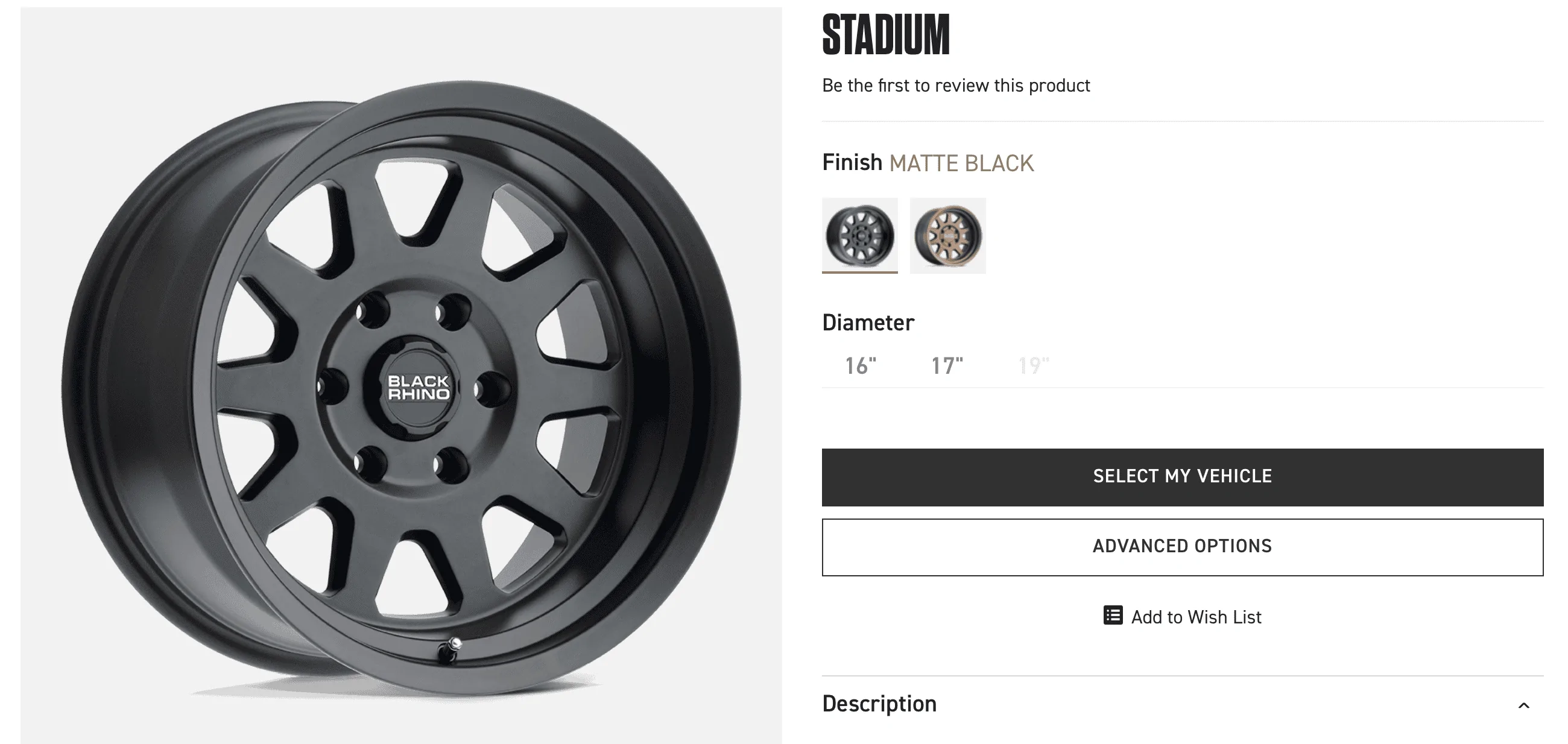

I'm sure they are to spec. But their wheels are not my preference. Especially the one that looks like a bee's nest. That one is atrocious. All tsportlines are flashy street wheels, not offroad truck wheels. I wouldn't take them offroading.
Something like this in 18s would be sweet on the Cybertruck:
https://www.blackrhinowheels.com/black-rhino-stadium
Tesla Cybertruck Aftermarket 325 wide tires + 18" Method wheels installed on Cybertruck 1706668937923

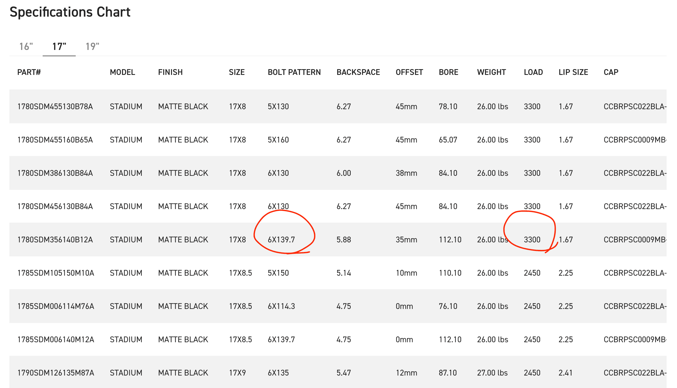

They come in the correct bolt pattern and load rating. Just not in 18s or 100mm bore yet.
Tesla Cybertruck Aftermarket 325 wide tires + 18" Method wheels installed on Cybertruck 1706669219377
@tsportline, 2,640lbs on all their CT wheels.
