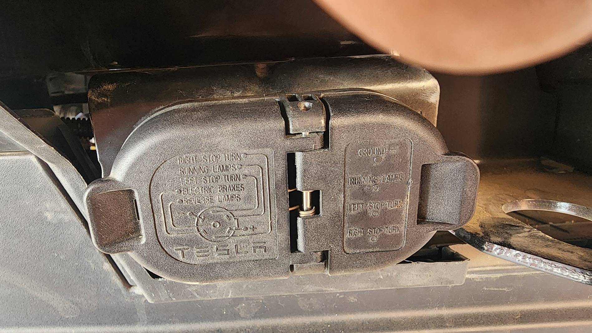

you could use one of these $2 ebay and get a 12v supply!
white is ground or negative and brown would be positive 12v or Running lights
you don't need the yellow and green wires those are for turn signals and only flash on off when you use the turn signal.

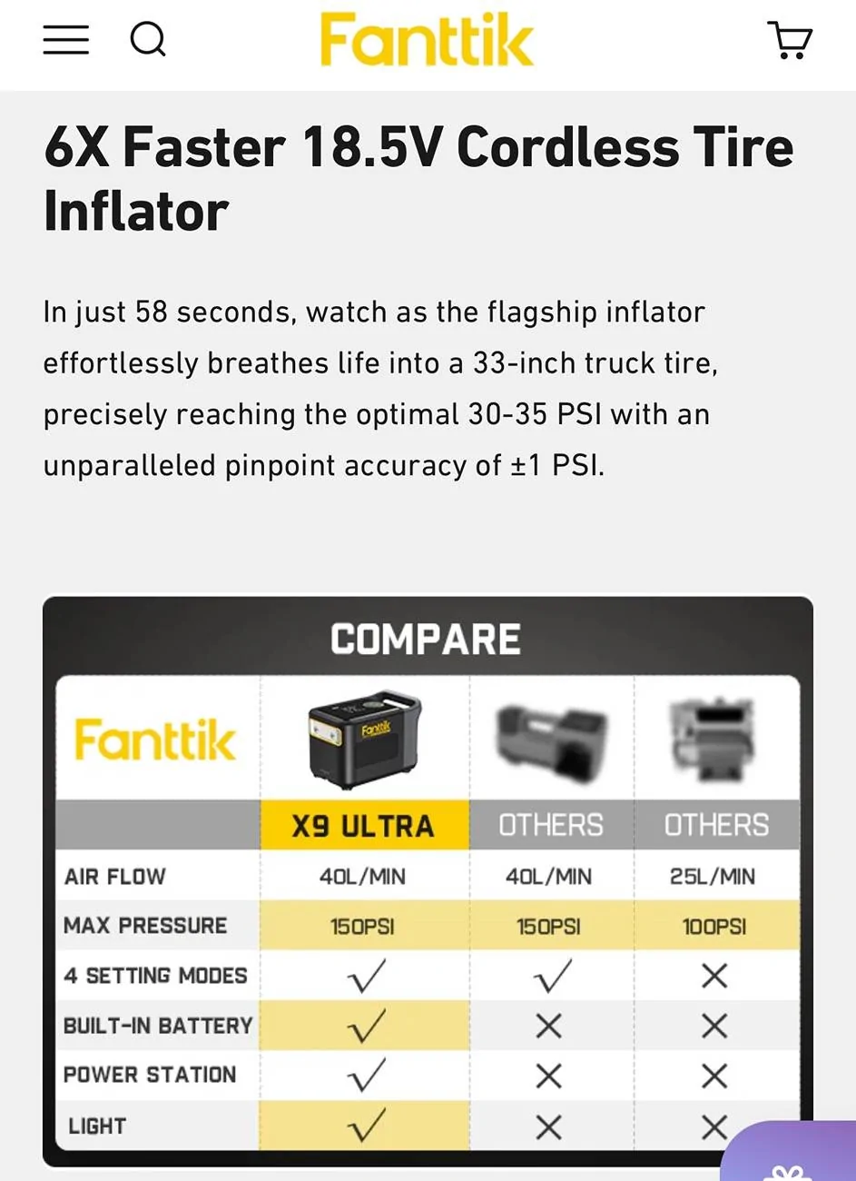

I have the smaller Fanttik and actually used it to top off CT without issue. It just took a while.
The bigger Fanttik looks great though the airflow is not as good as the plug in TC BL noted earlier on this thread.
And of course, I can find anywhere that shows flow rate for the new CT compressor, which I bought and arrives tomorrow. I’m waiting for the video review on it to see how it actually performs. If it’s not as good as TC BL, I’ll think about returning or selling.

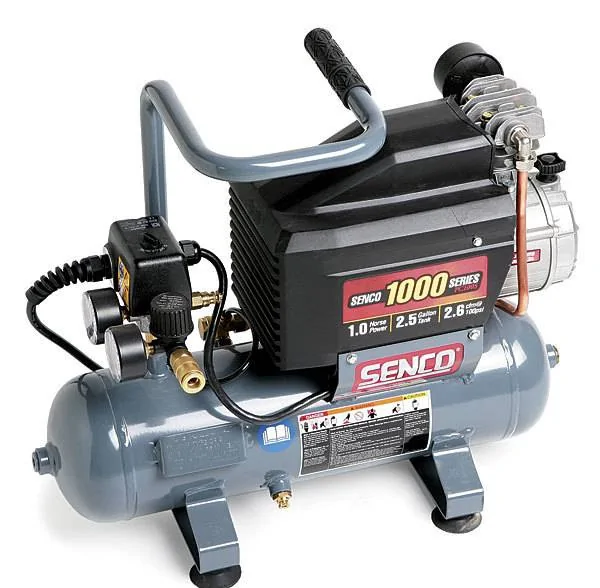

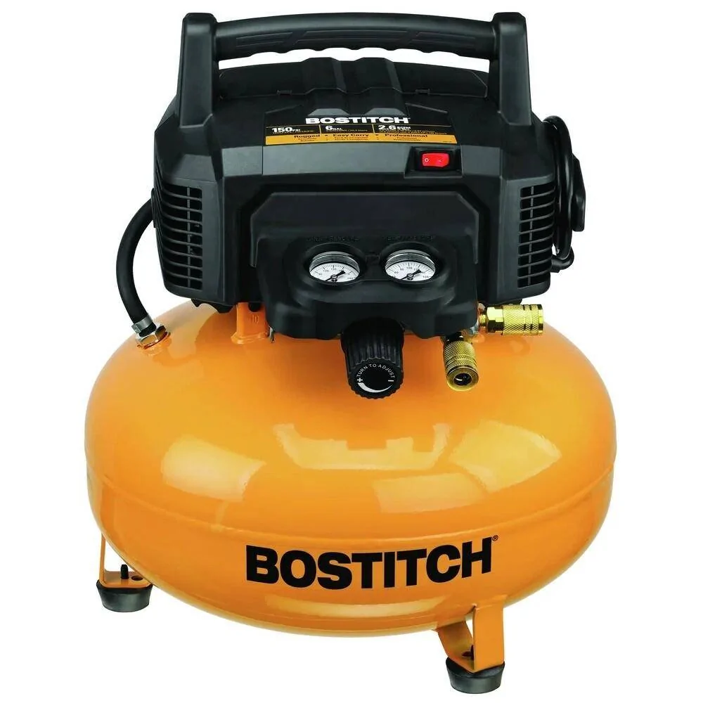

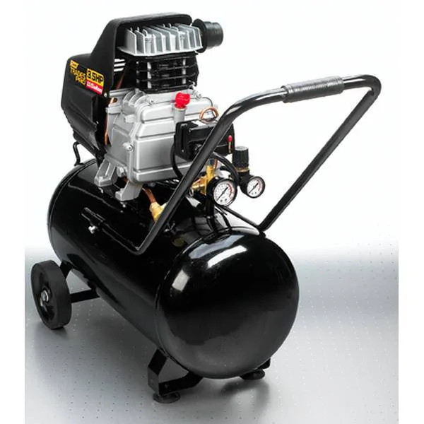

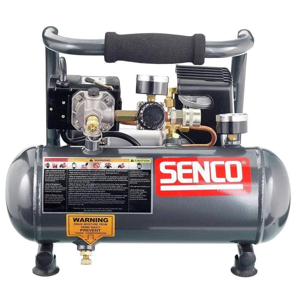

I already own too many small air compressors to justify me buying the tesla overpriced $550 and out of stock compressor heres my compressors I already own.
