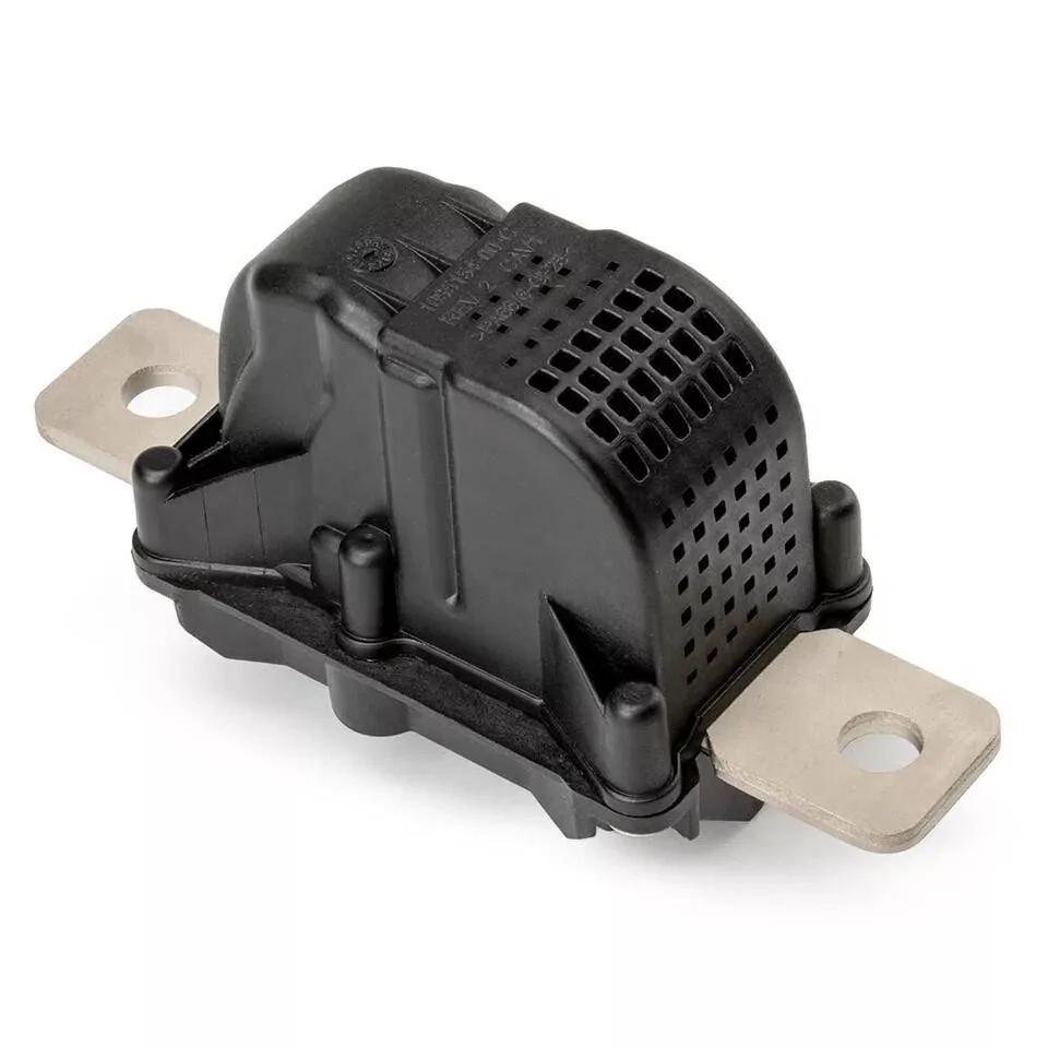

There are however some really large fuses on teslas for the high voltage system that will blow out if shorted and need to be replaced.

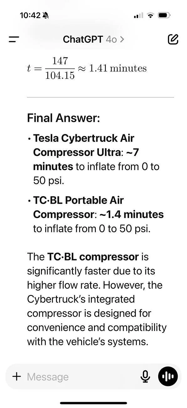

Rednave’s video showed that the tire took almost 6+ mins to fill from 12 to 50 PSI. I asked Chat GPT to extrapolate numbers based on flow rate 25 (CT) and 125 (TC BL) liters per minute respectively. Looks like a no brainer to me. Am I missing something in my analysis?
I don't know enough about this to comment on it intelligently but I do know for certain that you can't take the stated flow rate and just divide it out. The stated flow rate is usually at 0 PSI. So you can't really calculate the CT compressor flow rate based on Rednave's video. Easy enough for someone who has the TC BL pump to replicate though. @HaulingAss ????

No, I only mention Rednave’s post to show that IRL is very close to the calculations based on 0 to 50 psi solely with respect to the CT all terrain tire size at the stated flow rates for each compressor: 25 lpm v 125 lpm.
Where did you see the stated flow rate of 25lpm for the CT?
