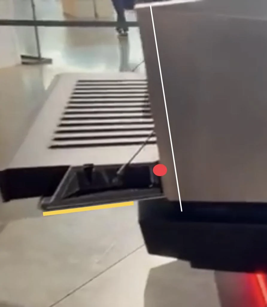

less relevant that the exterior package of the gate itself is not vertical, as it is that the hinge is sufficiently forward of the mass.
and in the case of the CT, the mass being the SS skin (yellow), it is sufficiently forward if the hinge (red), especially given the rearward slanting profile of the tailgate (white). Tiniest nudge from the latch action and it’s on its way down … unless you’re parked facing down a hill

That's what I was trying to say.
