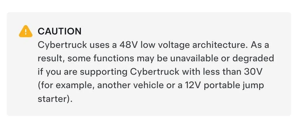

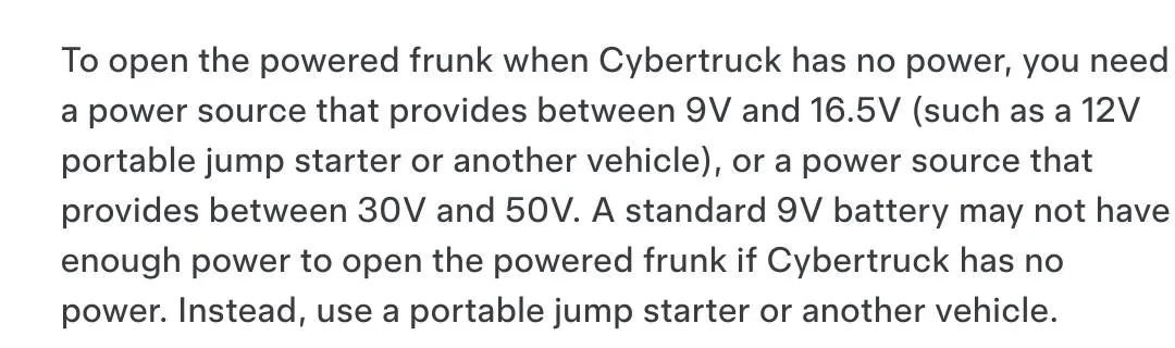

Good day everyone. A useful hint for jump start the cybertruck: you may use scooter li-ion 36v battery with attached crocodile clamps. When fully charged it provides 42V DC which is enough to power up the car and close hv battery contactors. These batteries and charges (42VDC) are available at Amazon with a search word "36v liion battery for scooter".
Pls keep in mind that frunk operates from 12-16VDC so you still need a normal 12vDC jumpstart to open it if car 48v system died.

You can use the same MV jump pack to open the frunk
https://www.tesla.com/ownersmanual/cybertruck/en_us/GUID-4EC0FD18-0503-40FD-8C97-0F6BB39DA79D.html
