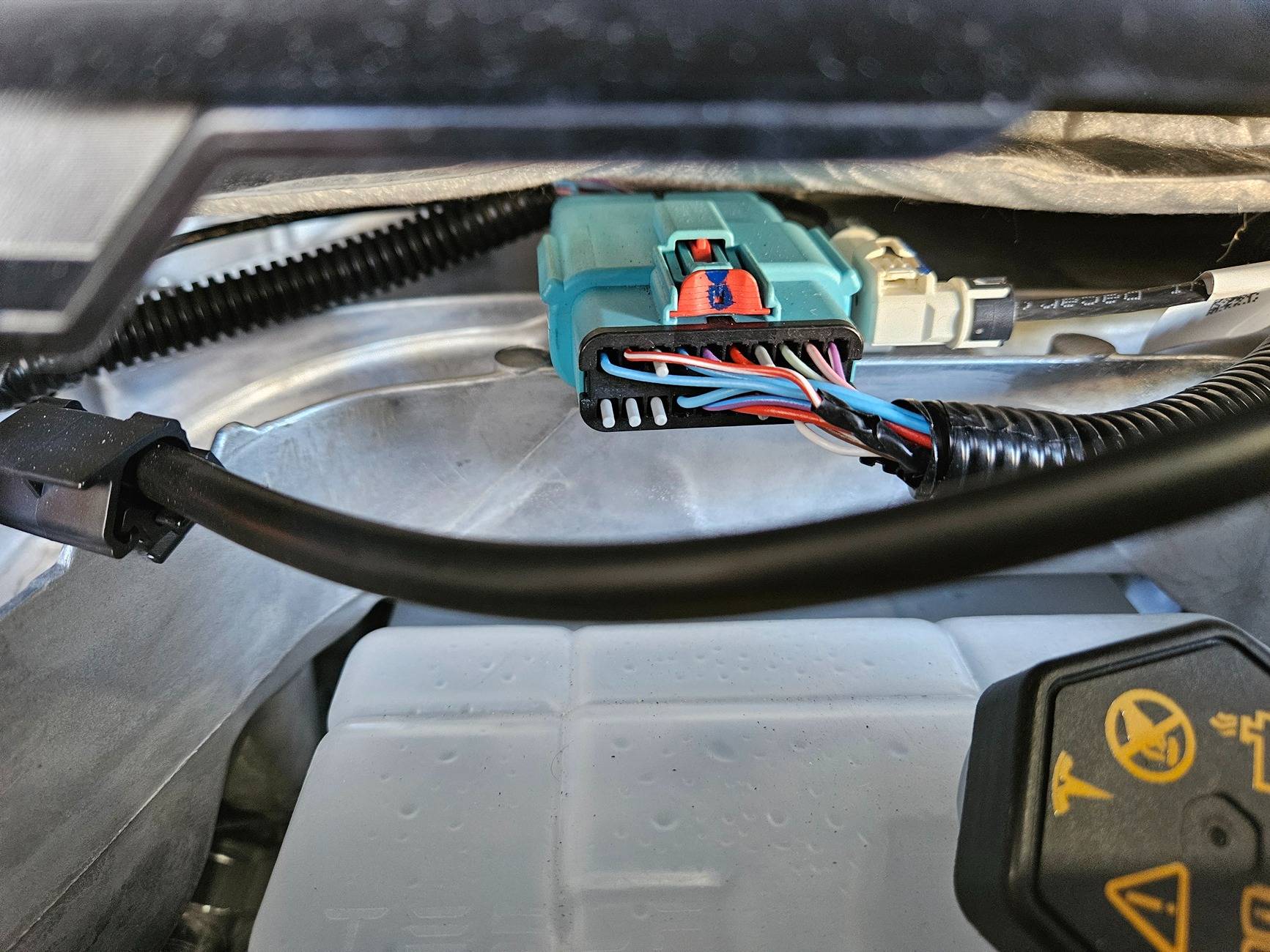

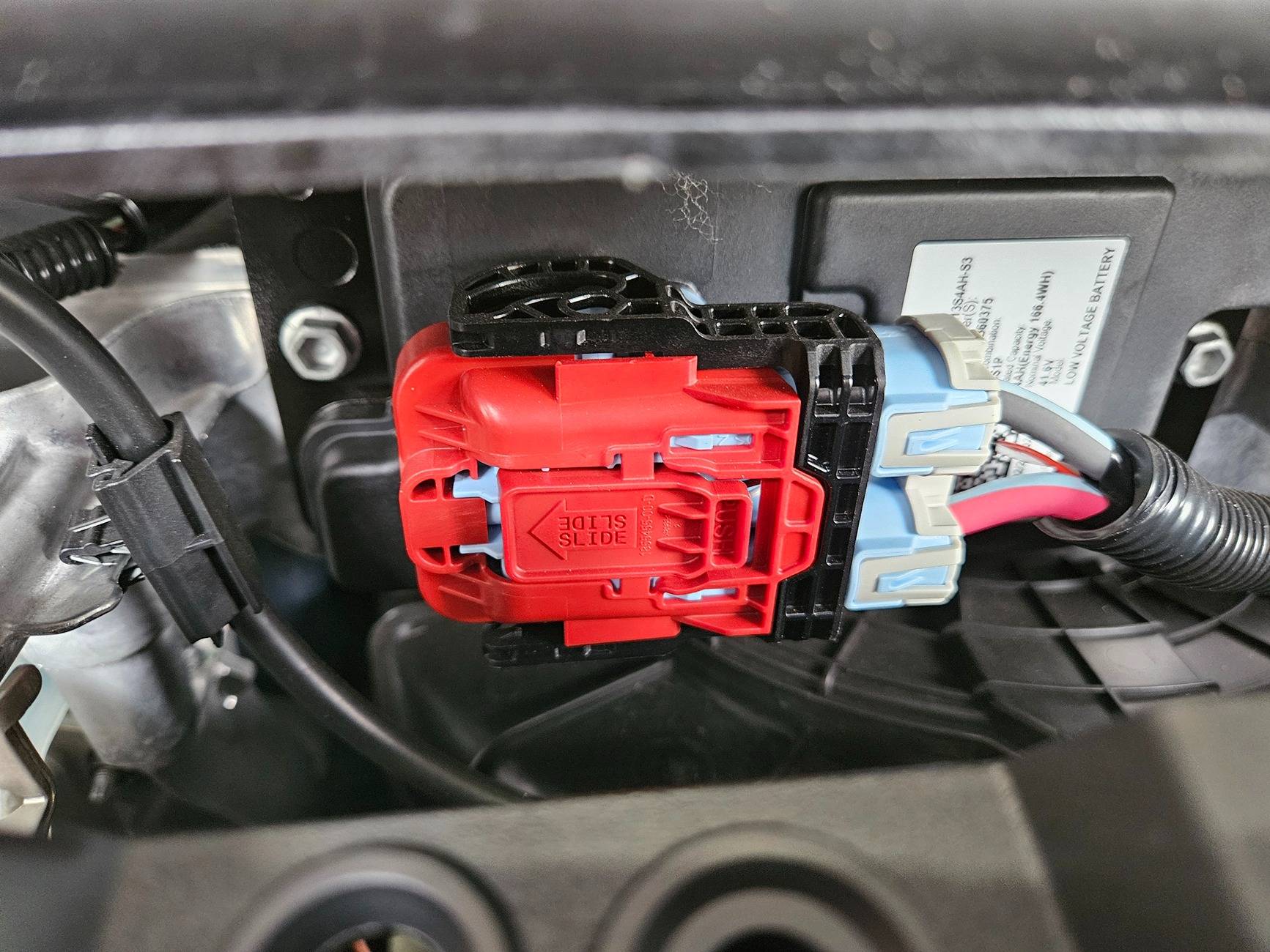

A simple tilt / swivel screen adapter install turned into a dead in the garage, CT. Two bolts and a video cable connect, what can go wrong? Having failed a scroll wheel reboot to activate touch screen, a SC tech explained the low voltage system reboot process. I think this is where it went south for me. I was not able to disconnect the blue wiring harnesses (photo)to complete the re-boot sequence. Truck went dead immediately upon disconnecting the first red, wiring harness on the firewall. Plugging it back in did not restore power. I put a 48v charger on the two lugs but nothing happened.

The blue connector is the fireman’s loop. Grab it and pull it will come loose from the chassis. The pull back the little tab and squeeze to disconnect. The slide the MId voltage battery center tab to left.
When reconnecting, connect foreman loop fire then MV battery
Thanks for your assist. I did that, the reboot sequence got the truck re-activated. Downside, blank touch screen. Drove it to Tesla authorized repair shop for them to troubleshoot. Sure glad there is a directional indicator above the rearview mirror. This was the first time I ever used it.
