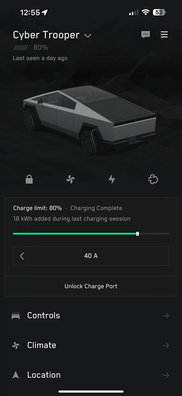

Update:
I received information today from the SC and they stated they have started the repair process with my cybertruck. An hour or so later, my cybertruck phoned home and it now shows “Parked” rather than “Last seen 9 Days ago”. This means there is progress.

There’s always people who does that eh? But people didn’t bother to realize that I was about to head out for a road trip that is about 150 miles. So I normally charge to 80% to get there. For what it’s worth, I normally keep the battery at near to 60%.
I’ll keep others updated here but so far, it’s good news since it phoned home. No longer says “Last seen 9 Days Ago” and went to “Parked”. As of this writing, it is now set to “Service Mode”. Now awaiting results and reason.

Update:
I was notified today that I could pick up my cybertruck. I spoke to ghe advisor for additional detail and I was informed that the internal left body controller went out and stopped communicating to the battery. They had the part in inventory and they replaced it. They did additional diagnostics and found no other issues (cross fingers). They also replaced the 12v battery and installed the wheel cover. Drove it home and so far so good.
