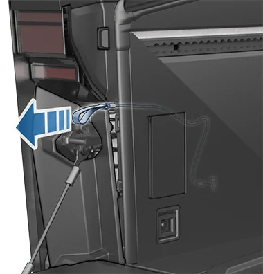

Brand new AWD VIN 69XXX is bricked in my driveway. Not a single error message or anything weird when I got home from work yesterday with about 100mi left. Plugged it in and it started to charge just fine. Nice weather, mid 60s. Went to get in today and completely unresponsive to keys and cannot connect to my phone. Charging cord is stuck plugged in and roadside side they can't connect to the truck either, so it's getting towed. Of course - it's Saturday so I can't get a loaner (which is INSANE when you think about it) there are loaners sitting in the lot and I can get assigned one via the app so why is that not possible?
This absolutely wrecks the thought of taking this thing hunting, camping etc. Real confidence loss overall in the CT platform.
**Update - was able to jump open frunk and then jump the 12v which let us get inside, unplug and get it in tow mode. Had a ton of error messages.
Sorry man, FYI there is a manual charge port release leveler / pull loop cord, open the tailgate it's a small panel adjacent to the fender charge port. Here is an image.
That said this is really poor design be completely locked out or IN your EV.
There should be an independent watchdog circuit that will detect the main system shutdown and allow for door, truck, bed access and tow mode.
