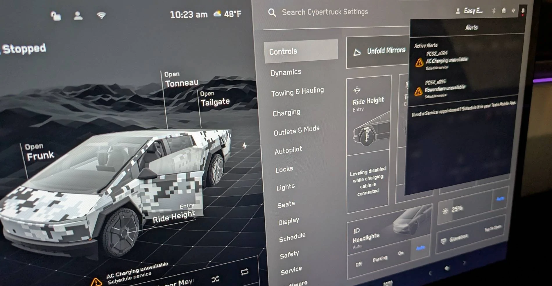

Unfortunately the same issue this morning. Briefly goes green, low pitch whining sound, and the "clunk" followed by the error.Might be temporary?
80 mile drive back to another service center on a Sunday.
Unable to call on weekend. Wife was heading up near a service center so dropped it off at the SC parking lot. We live atleast 1 hour from a service center so it's hard to coordinate rides. Dropping off on a weekday and picking up a loaner is almost impossible with work/kids. This marks our fourth visit since within the first 8K miles or 9 months. Phew....Before you go... Call Tesla. I had a problem when I first got my CT. I was able to call and they did charger and truck diagnosis remotely. It might save you a trip.
