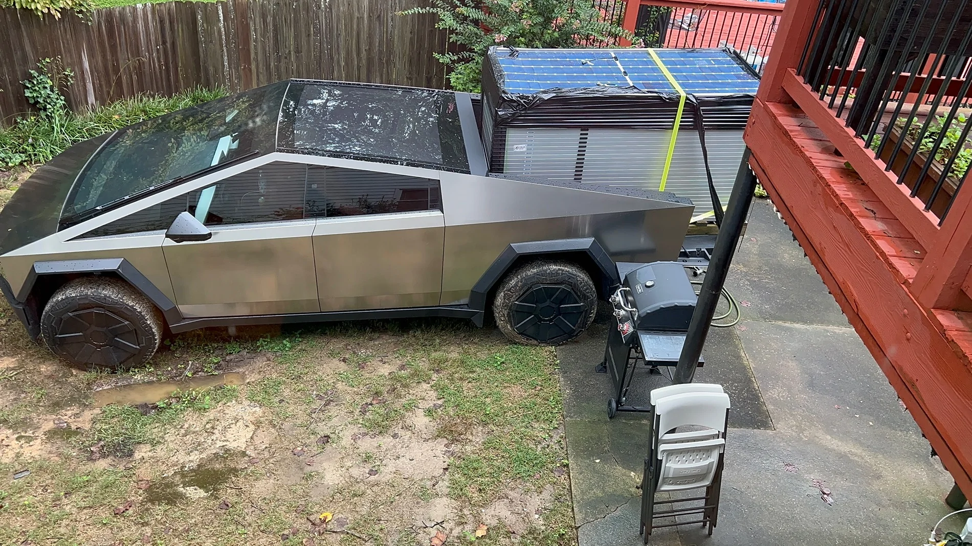

I got this error when I got some solar panels loaded in the truck bed.

Yeah,
That's ~31 panels likely 60+ pounds each with CG behind the rear axle.
Definitely overloaded.
Did you at least air the poor tires up to 65 psi?
Yes, I did. I should have used my trailer instead. Lesson learned
also, RIP to that lawn with all those mud ruts that were created 😅

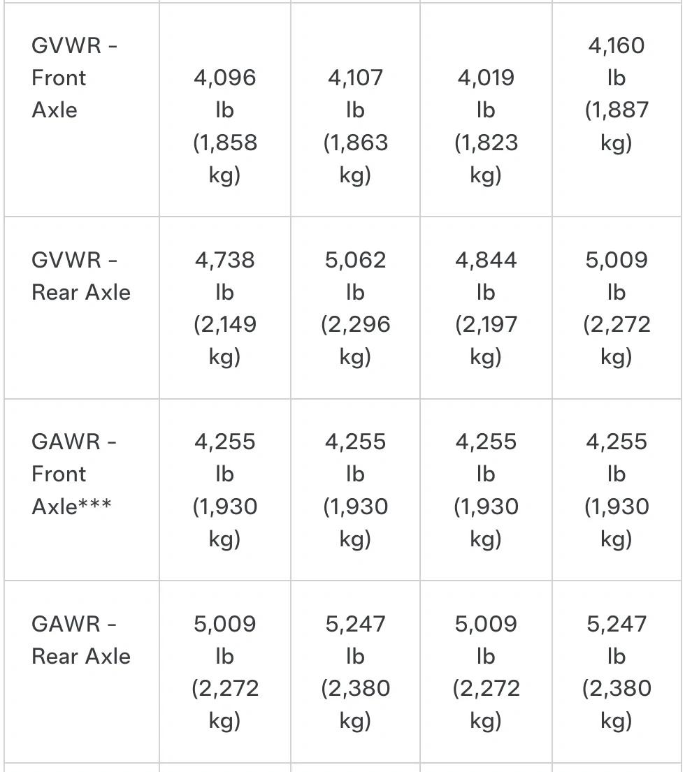

Cybertruck's rear axle has a Gross Axle Weight Rating (GAWR) of 5,009 lb, which includes the weight of the vehicle, passengers, cargo, and tongue weight from a trailer.
If they have core wheels, cyber rear GAWR is 5,247 with tires at 65 psi.
The table can trip a person up. Tesla, for some unknown and inexplicable reason, has per axle GVWR weights listed along with the actual GAWRs (second set of numbers).
It’s not the core wheels that give a bit more payload - you can have that same payload with either wheel - it’s the All-Terrain tires - note the dual motor also has 5,247 rear axle rating with those tires. But some tire/wheel and CB vs AWD can be even less - and the GVWR for the rear axle is lower in every case. That is the maximum weight rating including the vehicle and all contents including passengers. No configuration could carry a yard of wet sand and a driver without getting the warning for overweight.
