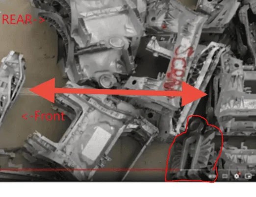

I agree that one on the left looks like a MY casting. I was speaking specifically about the tuning fork (directly beneath the right arrow head)scraps. Those, I haven't seen before.

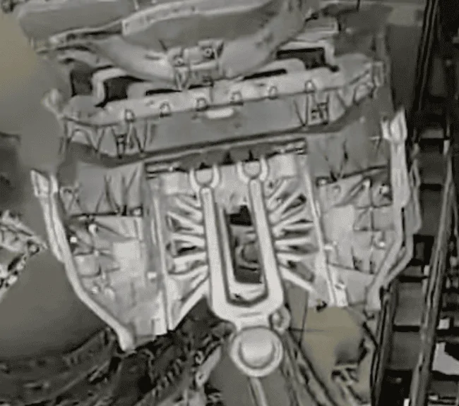

EDIT... SPOILER ALERT!!! If you're planning your weekend around measuring the forks to fit the CYBERTRUCK suspension, read no further. ?
Those "tuning forks" are the downcomer channels that supply molten aluminum to all parts of the casting evenly. They're cut away and recycled after the casting cools.

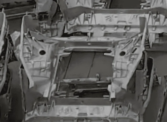

Here are two photos of front Model Y castings, one with the waste pieces still attached, another with the clean casting after trimming.
Damnit, you just ruined weeks of speculation :ROFLMAO:

BRILLIANT! I knew it wasnt a functional part although I was entriely sure what it was.. Haven had any experience with high pressure aluminum casting , you know .

Would those off cuts have the same integrity as the rest of the cast?
Why don’t they make the downcomer channels in the shape of suspension parts?
