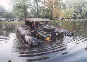

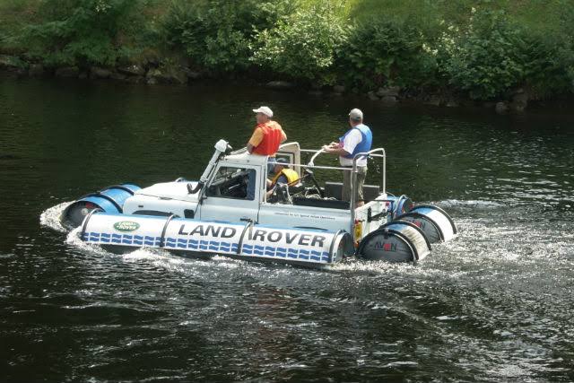

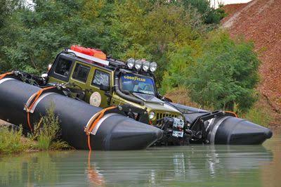

Some slight modifications to the assembly of these pontoons would make these a perfect solution that uses the structure of the vehicle to support the pontoons.
With some rock sliders, the pontoons could be attached in a way that allows them to float to the side while the vehicle enters the water then when in deep enough water the pontoons can be brought down into the water by pulling them in a 90° arc medially to the side raising the vehicle.
A front mounted winch could provide this
medial pull.
In the rear the tow hitch can be used to mount an array of electric outboards.
I hope the App Store will allow for custom control ports for a winch, an outboard motor, other ancillary control servos etc.
Similar to this but not so over engineered.
Tesla Cybertruck Cybertruck + catamaran = Cybercat™ 1644836595640
Tesla Cybertruck Cybertruck + catamaran = Cybercat™ 1644837086061
But maybe slightly more engineered that these two;

Using winches as an actuating force is innovative. However, this has its own complexity from a setup perspective because the winches and rock sliders need to be added to the CT as well as the connecting lines. From the perspective of robustness, the lines would be exposed in the water and are at risk of being damaged by floating debris (at least in how I'm imagining the implementation of the design you are suggesting).
I think the key operative words here are “short crossings”. If the design objective is to cross small distances of water at slow speeds, I agree with you, there are simpler designs. In this case you don’t need to worry about corrosion or hydrodynamic efficiency which steer the design toward the solution of holding the vehicle body entirely out of the water. There are a few commercial examples for this less demanding use case and numerous hobbyist examples like the Camel Trophy competition and the Land Rover Bering Strait crossing, which you show some pictures from. I specifically callout Water Traxx Pontoon System for ATVs in FAQ#3:
https://watertraxxinc.com/
I think once you get into the load equations for your proposal you will find that dynamic loading, even at slower speeds through chop, will be more than the front and rear mounting points alone can withstand. Also, it is unclear whether the CT will have mounting points for rock sliders because the undercarriage is entirely flat and the thick skid plate is directly adjacent to the battery pack (probably no bolt holes drilled into it).
The frame of the Cybercat as show is designed to direct load directly into the vehicle’s lift points which are structurally design for much higher loads and are guaranteed to be present on the CT (or any other EV).
Finally, I would say that a lot of the perceived complexity comes as a result of the intersection of design requirements to 1) enable the frame to compactly stow in the vault for transport while 2) make installation foolproof and 3) provide robustness to alleviate the negative gut reactions around safety that the less engineering inclined tend to have. If people don't mind components permanently affixed to their CT, negatively affecting their normal driving range and vehicle clearances, the design can be simplified.
