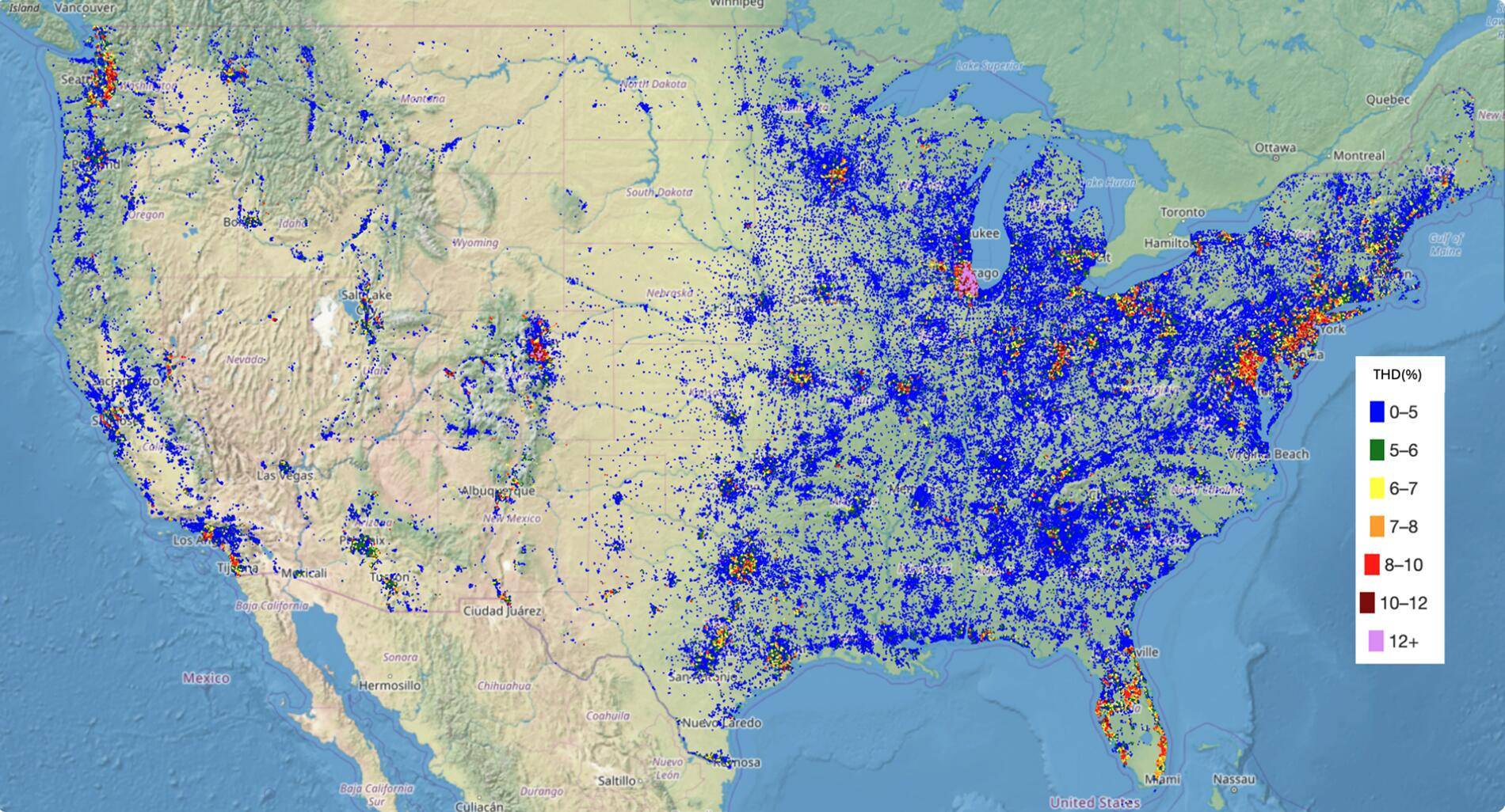

Dunno that I'd compare grid power (or Cybertruck power) to what you'd get from a solar inverter. Not many people have solar.
The context here is when grid power goes dark. For most of us, that comes down to some kind of ICE generator; or, now, for some of us, vehicle-to-home.
Most conventional (non-inverter) ICE generators produce really ugly power. But the fellow who just spent $300 on his made-in-China genset doesn't want to hear that the stuff in his home will fare any differently on that than the several-thousand-dollar Honda inverter model someone recommended to him. I mean, it's making the right voltage, right? And my stuff turns on, right?
Must be all that good filtering!
Grid power from most utilities in the United States is really quite good - most of the time. But the grid is affected by many things. Voltage fluctuations happen continually, throughout the day. Frequency excursions are less common, but still a thing. And the resultant THD quality - and that's all THD is, a measure of quality - ebbs and flows.
Inevitably, there are hot spots of "less good" power coming from the grid.
Tesla Cybertruck Cybertruck - How Much THD? THD-National

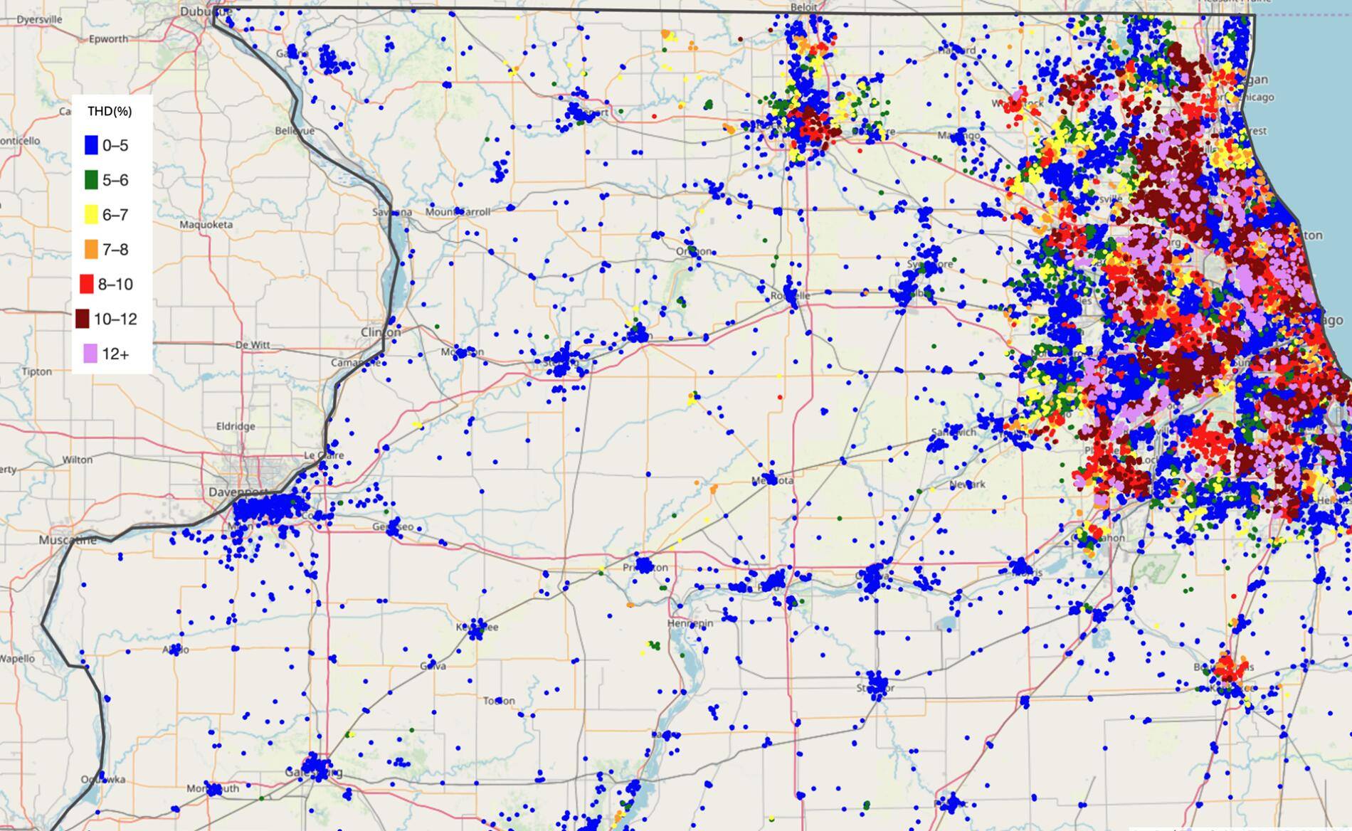

Chicago:
Tesla Cybertruck Cybertruck - How Much THD? THD-Chicago

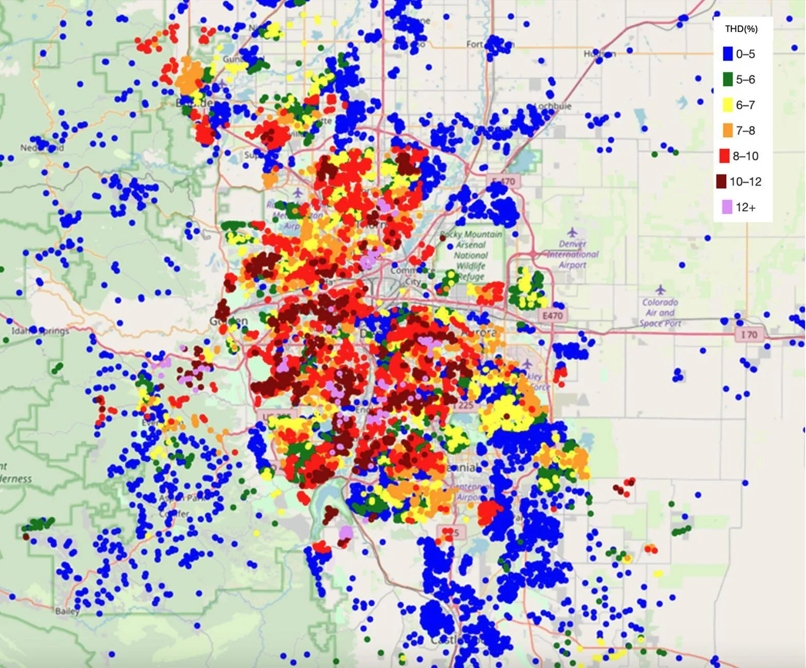

Denver:
Tesla Cybertruck Cybertruck - How Much THD? THD-Denver

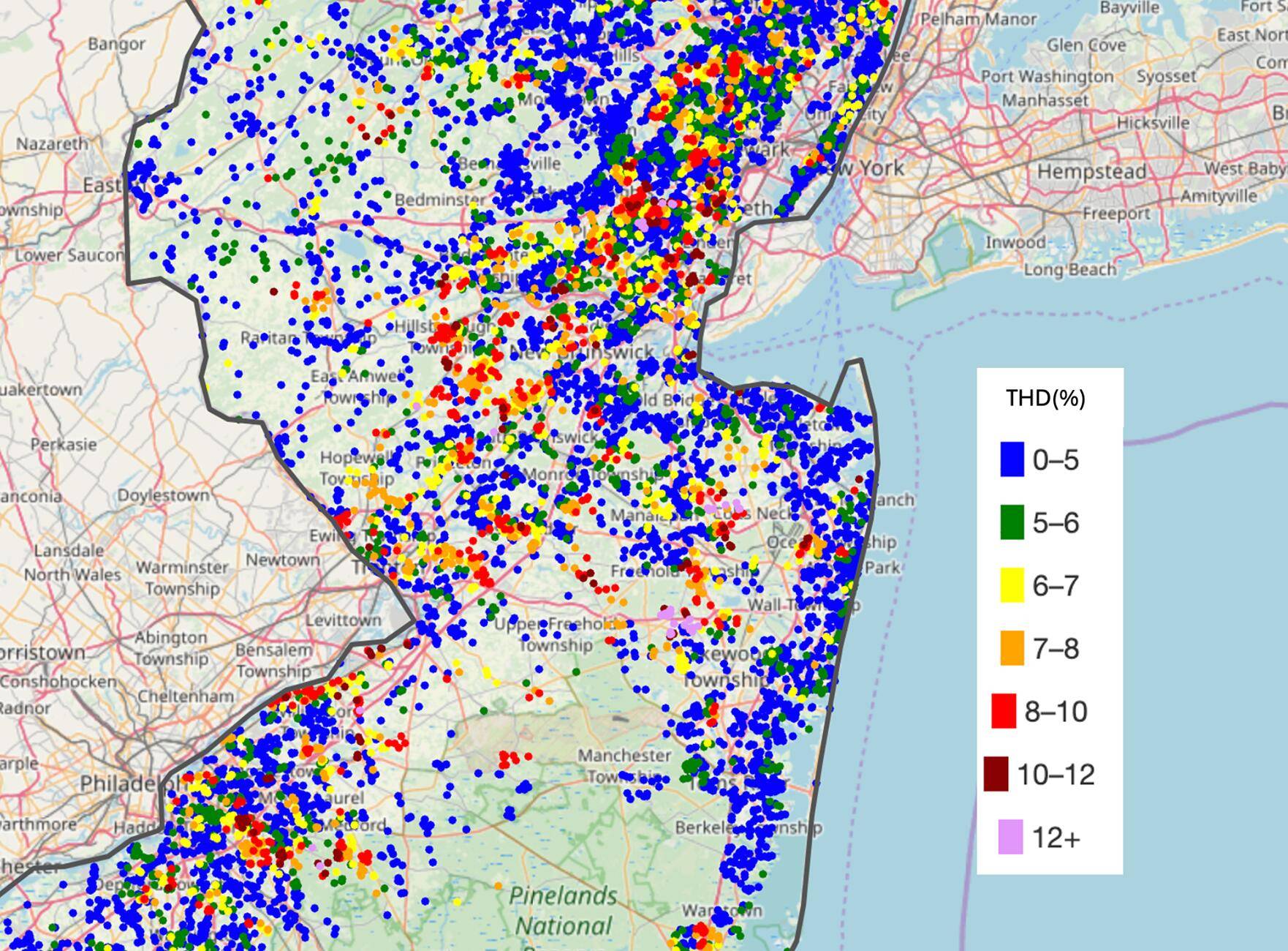

New Jersey:
Tesla Cybertruck Cybertruck - How Much THD? THD-NewJersey

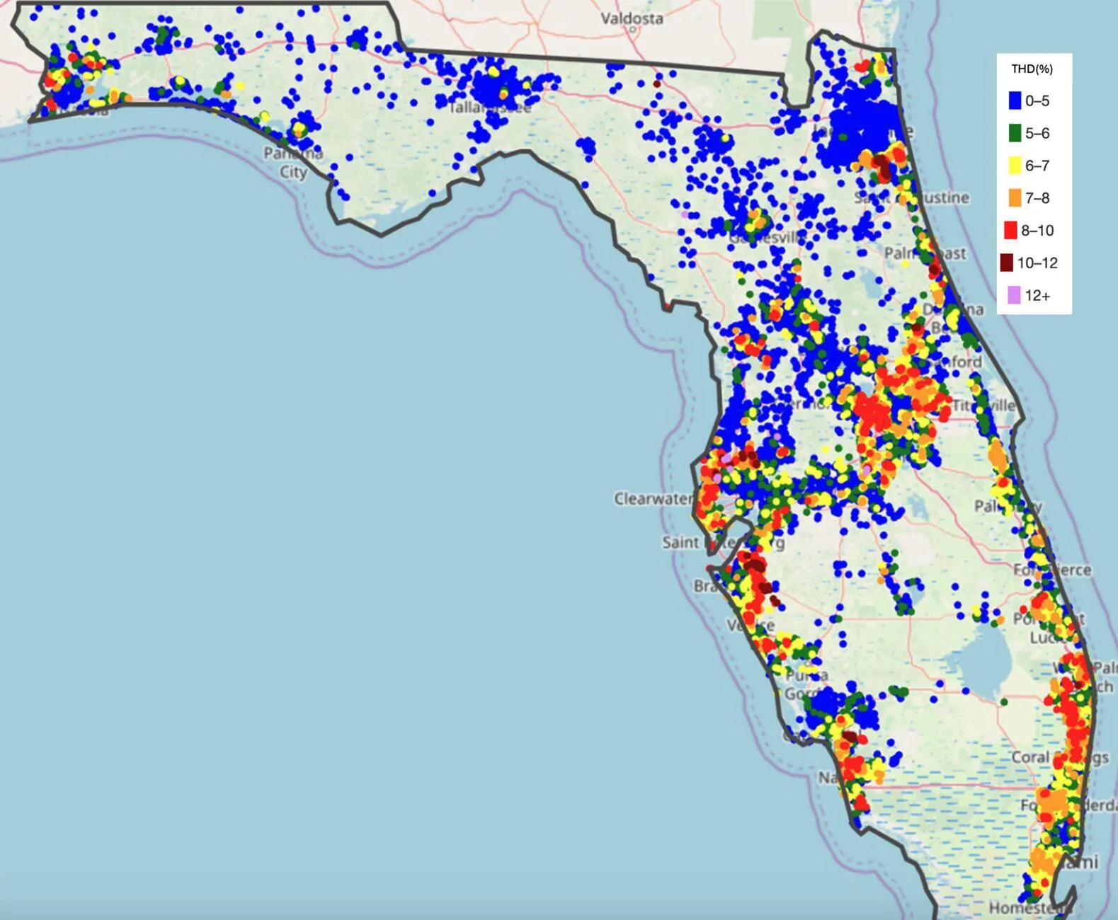

Florida:
Tesla Cybertruck Cybertruck - How Much THD? THD-Florida

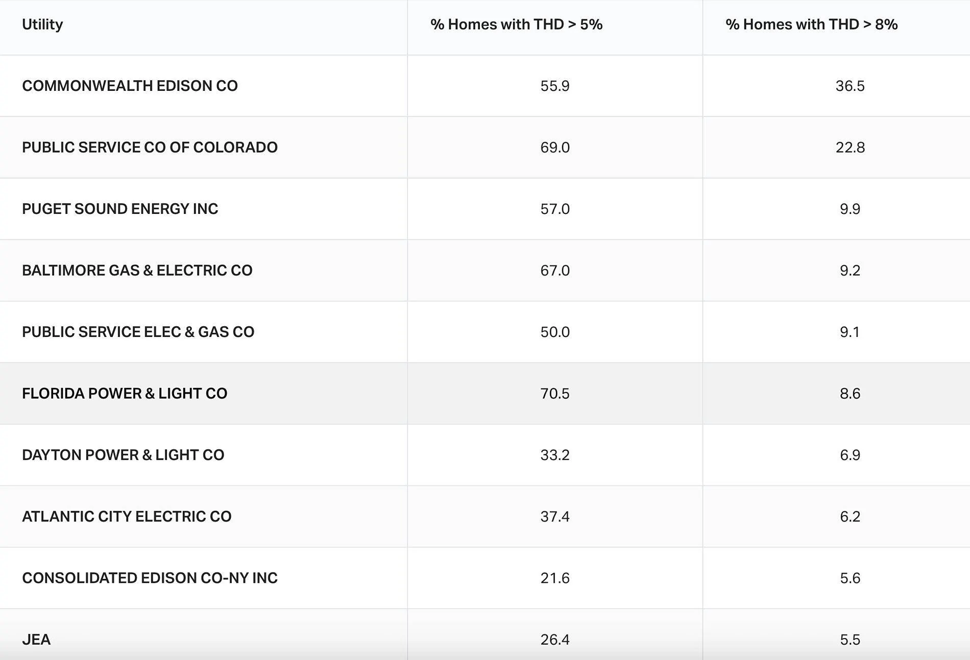

Some challenged utilities:
Tesla Cybertruck Cybertruck - How Much THD? Sample Utility THD Levels - Feb-Oct-2024
The THD bogey for utilities was 5% for a very long time. Most utilities still hit that measure, most of the time.
Broadly speaking, grid power is quite good. For me, simply wondering how to respond to an episodic utility outage, that's the reference.
