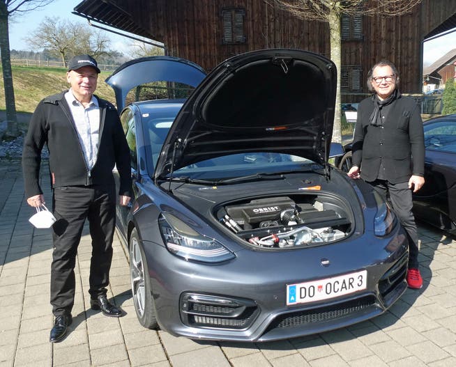

The trick with adding a onboard generator is to not install it with a model EV that has a lot of batteries. That way your weight penalties is reduced, and the initial cost of purchase as well.
One of the forerunners of this type of "hybridisation" of BEVs is Obrist from Austria that already have a product in the works to achieve this, also using net carbon negative fuels.
https://www.obrist.at/wp-content/up...Hybrid_Broschuere_doublepage_01_RZ_WEB_en.pdf
Tesla Cybertruck How much would you pay for a range extender. 1691123910405
Tesla Cybertruck How much would you pay for a range extender. 046e5e69-53e4-4518-99fc-720a7bfdd44a
Would also fit snugly into the CT Frunk, as it even fits in a smaller M3 frunk. Multifuel capable, and it would have enough continuous output to keep the CT charged for as long as it has fuel. Consumption for the CT should be around a gallon an hour (4L). So that would mean you could do around 350miles on just a single 5 gallon jerry can of fuel. 700miles on two jerry cans, and whatever the EV range is on top, so 1000miles is fairly easily achieved without refuelling.
The main interest for this would be from ANY serious offroader. Driving in sand, snow, mud or loose terrain at any decent speed is a very high power load and high energy consumer. That together with low SC availability in those areas means fuel powered 4x4's will remain dominate for some time until such a hybrid solution is found, or a breakthrough battery density is available. it is not uncommon to use 3x as much fuel in sand whilst 4x4 driving in comparison to onroad, and this extra energy demand can't easily be counteracted on by improving EV drivetrain or aerodynamic efficiency.
The reason is that to propel yourself in sand you physically have to move the sand in front of your wheels to behind your wheels, instead of simply rolling over a flat piece of tarmac. This extra digging "work" requires energy to do, and that needs to come from somewhere, unless you plan on doing a one way trip. This becomes even more expedient in colder climates where solar charging, or population density, let alone heating from the waste heat of the ICE are quite literally "life saving" features of an ICE setup and fuel density.
Given the above the market for a hybrid CT setup is definitely there and will likely remain for the next decade or more. If biofuels continue to advance as they have been, it's also possible that some other technologies go to scale and filter down, like bio-fuel cells. Hydrogen is still off target IMHO, so I'd avoid that, there are much better options. Have a look at the energy mix in Denmark.
