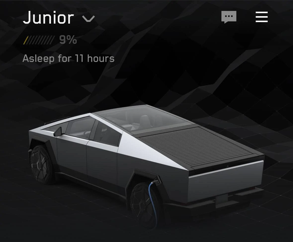

Truck went back in to SC for another week and problems were fixed. Now it sleeps and shows "Asleep for xxx' in the phone app. It looses less than 1% per day rather than 10% per day sitting in the garage. Coolant pump no longer runs 24/7. Problem with most speakers quit working hours after MV reset fixed as well. From the service notes:
Internal issue with car computer. Replaced and tested. Truck is now sleeping and right side audio is not being affected... All other related alerts was from A2B circuit causing false alerts as it was a failed car computer.
