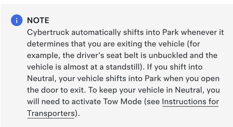

You can’t leave any Tesla in gear. You take off your seatbelt or open the drivers door and it automatically goes into park. I can’t explain how this happened, even as someone who launches a bass boat at least a couple of times a month. I’ve been on ramps much steeper than this one, fearing this exact scenario, and have not had the truck even budge.
Some people use dummy seatbelt clips when using trailers a lot, or if putting things in the passenger seat. Maybe not a good idea, but allows the car/truck to think the seatbelt is buckled and cuts chime etc. REALLY wish I knew what happened here, pretty terrible look.
Gigahorse
Dec 19, 2023
2,869
3,258
AWD
You can't though, unless the driver was still in the vehicle. Teslas automatically go into park if you get out.
Maybe they thought it was in D?
My guess as they were towing, they had it in Tow Mode, and that left it in neautral, they got out to launch the seadoo and the CT went under.
Towing mode (with a trailer) is not Tow Mode (getting pulled onto a flatbed)
This would be the same point of failure in many cars - and any motorcycle - if the rear wheel slips the front doesn't resist motion.
Being able to lock that engine in gear is an unsung advantage. My Zero has no resistance to rolling when off except the single point of the side-stand! So I keep a bungie to put on the front brake lever (and there are inline things you can put to turn the brake into a parking brake) just in case it gets bumped off the stand.
It's not unique to Tesla, but it is something to think about when operating a Tesla without someone else to hold the brakes for you. But this would apply to a rear-drive truck and some other AWD trucks as well (like mongo said).
