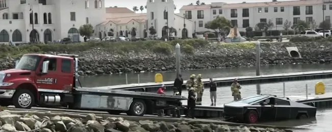

Cybertruck sinks underwater in Ventura CA Harbor -- must not have been in Wade Mode

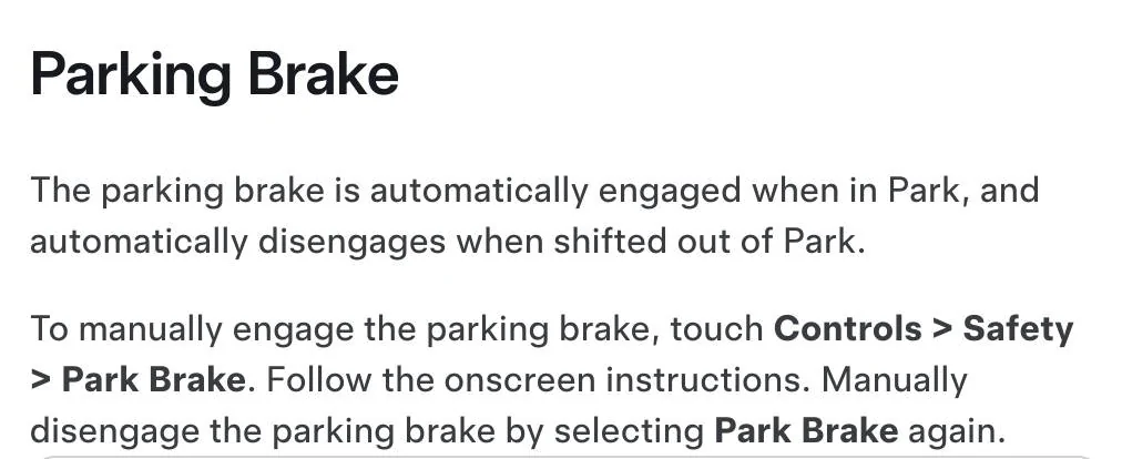

Parking Brake
The parking brake is automatically engaged when in Park, and automatically disengages when shifted out of Park.​
To manually engage the parking brake, touch Controls > Safety > Park Brake. Follow the onscreen instructions. Manually disengage the parking brake by selecting Park > Brake again.​

I find the Owner's Manual to be vague on this point.
Parking Brake
https://www.tesla.com/ownersmanual/cybertruck/en_us/GUID-6DD1AA33-2FE0-44B0-93EA-17CF5BB80F76.html
I'm sitting in mine running through the modes.
That button is the same thing the vehicle does when you go into Park, with the added advantage of preloading the pads with the service brakes (if you push the brake pedal firmly), enabling the button only requires light pressure to trip the brake light switch.

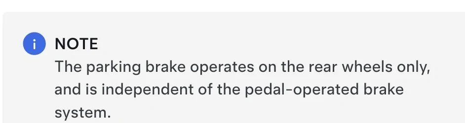

I think we've seen from other issues like Teslas sliding down driveways when parked on snow, the electronic parking brake is only on the rear wheels and if they slip, the front wheels will roll freely.
Unlike a traditional automatic transmission with a parking pawl or a manual transmission you can leave in gear, the Tesla system has the parking brake as the single point of failure. The brake is certainly sufficient to keep the rear wheels from rolling even on inclines, but as soon as they lose traction there's no backup. A true 4WD system in park or in gear would have had some resistance to rolling on the front wheels, even with a rear-only parking brake.
I'd be willing to bet the driver would have had no issues whatsoever if they stayed in D or R on the ramp, since brake hold would have been applying front and rear brakes. As soon as they got out and if shifted to only the parking brake, they were relying entirely on traction at the rear wheels. Buoyancy, either because they submerged too much of the vehicle or because they didn't untie from the trailer, loss of traction from algae on the ramp or more likely the combination of both meant the CT was going for a swim.
A traditional pawl is a single point of failure, as is the clutch/ engine. A nonlocked rear differential also means you are relying on the traction of the least grippy wheel. Dual parking brake pads give redundancy.
Initally, but a true 4WD with transfer case not locked would allow differential front and rear spin rates reducing the system back to the least grippy tire. An AWD type with limited slip center differential would help a little, maybe.
Agreed, but either of those systems provide redundancy alongside a parking brake.
4WD with transfer case would still have prevented the front wheels (with traction) from rolling if parking brake had immobilized the rears.
The reality is that launching a boat alone is a risky endeavor and trucks occasionally end up in the lake. Wheel chocks are a cheap investment.

To launch a JetSki that is WAY further than you need to go, and even if the rear tire was mostly under like in the pic below the truck on that shallow of an angle should be able to drive out no problem.
Ventura has maybe a 5' total tidal swing.
Something does not add up, ramp does not look steep and even if slimly should not pull a vehicle in like that.
HOPEFULLY they just forgot and left it in R, sucks but hopefully driver error on that one.
You can’t leave any Tesla in gear. You take off your seatbelt or open the drivers door and it automatically goes into park. I can’t explain how this happened, even as someone who launches a bass boat at least a couple of times a month. I’ve been on ramps much steeper than this one, fearing this exact scenario, and have not had the truck even budge.
