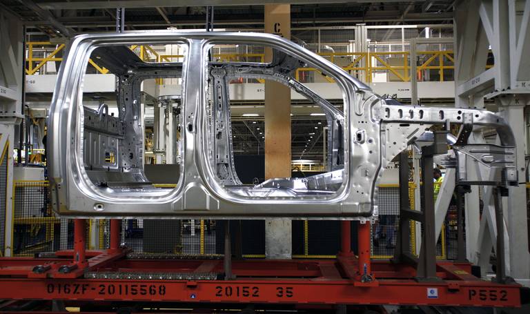

I think this image is more indicative of what will carry the load forces.
And to this, you add a handful of supplemental subframe pieces and you're done.
You're looking at maybe 10-12 individual parts. Compared to the F150L with several hundred that need to each be welded together for the same thing, but probably weaker...
The exoskeleton may not be the sole bearer of all structural forces on the CT. But, the system as a whole only needs 10-12 parts to exceed the capabilities of several hundred parts welded together. With each weld point being a failure point.
Then when we take a look at the cabin, it's only a few sheets of folded stainless, some subframe pieces, and we have the interior frame and 80% of the exterior body done.
While the OEMs need to once again weld several hundred formed pieces together just to make the sub frame with 0 exterior panels in place.
The exoskeleton does plenty when you don't need to weld hundreds and hundreds of formed parts together before you even have the skin on the truck. In addition, it ties together the castings and battery pack from front to rear doing the work of the ladder frame of the F150.

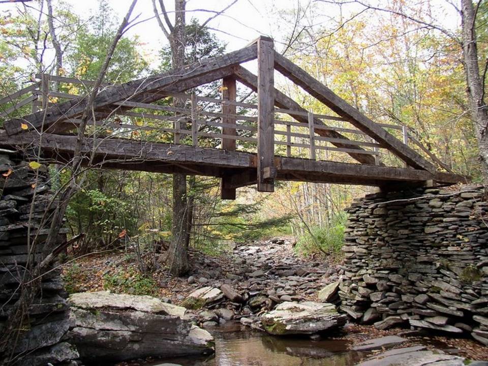

Seems to me this is the key to the whole “Exoskeleton” debate.
A traditional truck has a ladder frame which supports the load. It has a body which supports the cabin, the skin of the truck, internal panels, and protects the occupants. The body has internal structure.
The Cybertruck has a front assembly, a structural pack, and a rear assembly which supports the load. The exoskeleton is the skin of the truck and it protects the occupants, supports the internal panels, and everything the body of the truck does. What you eliminate is primarily what you see above. That is gone.
I think the body is also a truss of sorts supporting the underbody adding strength to the whole for things like towing large loads. The skateboard portion of the truck is doing the lions share, but the stainless skin prevents flexing and stabilizes it.
I strongly suspect if you just took the skateboard and put 3500 pounds on top of it that it would not perform as well. That triangle acts like a suspension bridge for the structural pack.
