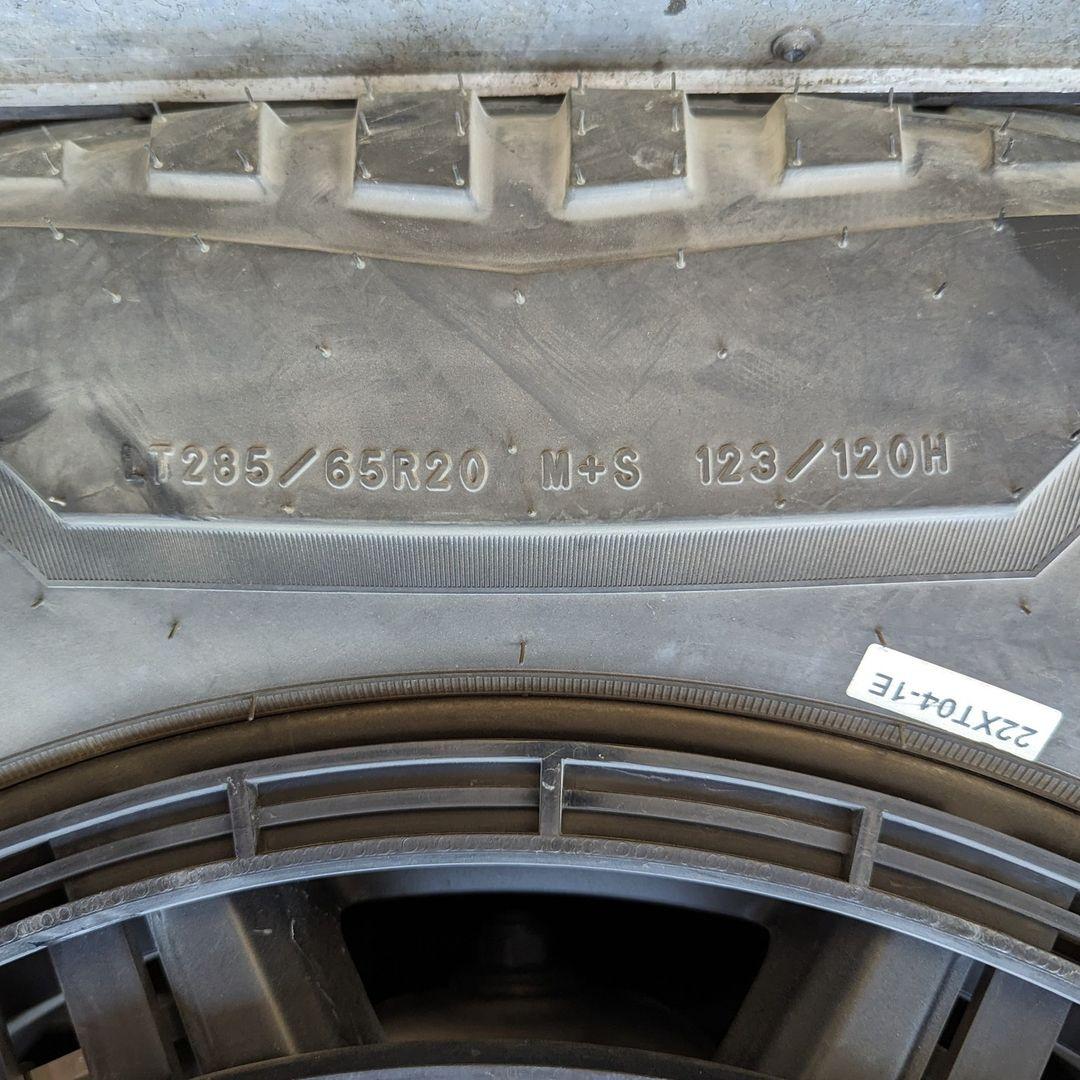

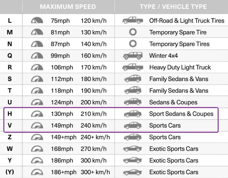

So if the truck is around that price I'm surprised because I figured those tires would be substantially more.
the tires Tesla provides?
because I’d guess they’re much more from Tesla, and that for a long time there won’t be many alternatives for a rite that is all of: 35’, speed rated to 130, load rated to D
