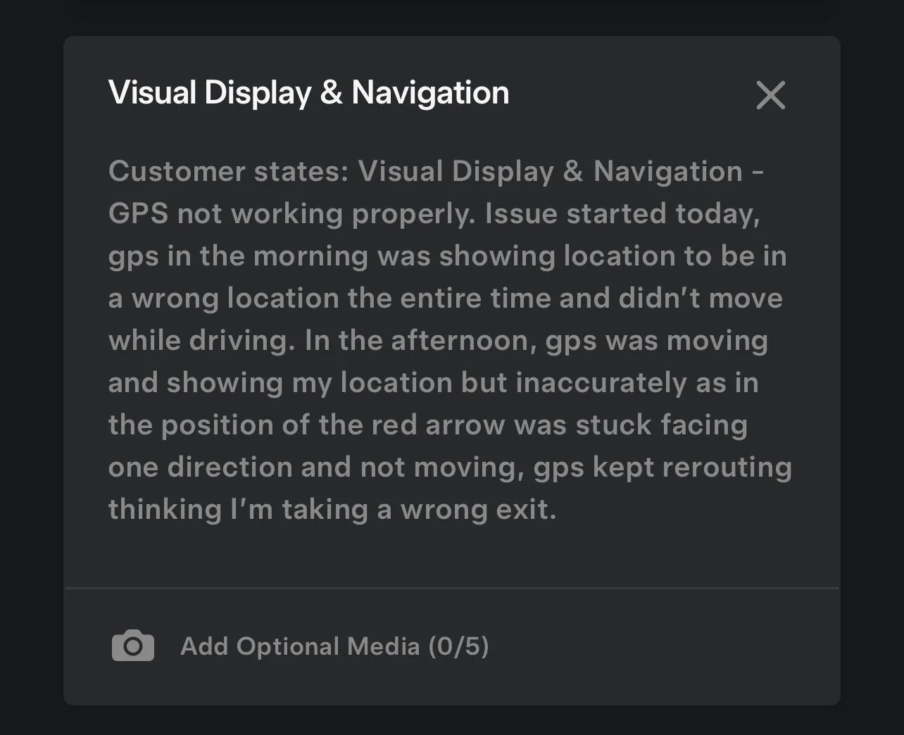

GPS drifted way off and now thinks I’m 2 miles away

Mine is now completely out. Started yesterday as well. Will either drift wildly with no rhyme or reason or stay “stuck” in one location. Started out not as much of a problem (I assumed it was losing GPS satellite lock or something) and now has dramatically degraded to be completely unusable

Same, started happening yesterday for me then it got better but it’s still inaccurate. I put a service request in yesterday for tomorrow but I highly doubt the service center can do anything about it . I think this has to do with Tesla gps network itself rather than an issue with the car. I had the same exact thing happen a couple of years ago in my m3 and it fixed itself a couple of days later.
I doubt it’s hardware since there’s a few of us having it happen simultaneously.
Tesla Cybertruck GPS drifted way off and now thinks I’m 2 miles away IMG_8190

Had the issue on Sunday driving from Melbourne Florida to Jacksonville Florida. It ended up having my car 20 miles offshore in the ocean near Flagler beach while the car was parked in jacksonville. I shutdown truck, reset the screen and then left plugged in over night. The Tesla App matches the fake location of the truck in the ocean, but by the morning the app showed the correct location, but the truck showed the same location in the ocean. Once I started driving, it fixed itself within driving .5 miles and had been fine since…

Used my navigation for the first time in awhile today and had the "pointed wrong direction issue" (stuck nw, regardless of actual direction) and unusable navigation because I wasn't where it thought I was.

We were driving in the truck when suddenly the GPS location drifted away from our actually location, snapped back, then did it again. It kept drifting further and further away from our actual location. And now is permanently heating the truck is located 2 miles away from here. What gives?
Mine started yesterday, it thinks I'm 40 miles or so from where I am, was hoping it would fix itself overnight, but it didn't. I will soft reboot when I get home tonight to see if that fixes it. Otherwise great truck with no other issues!
